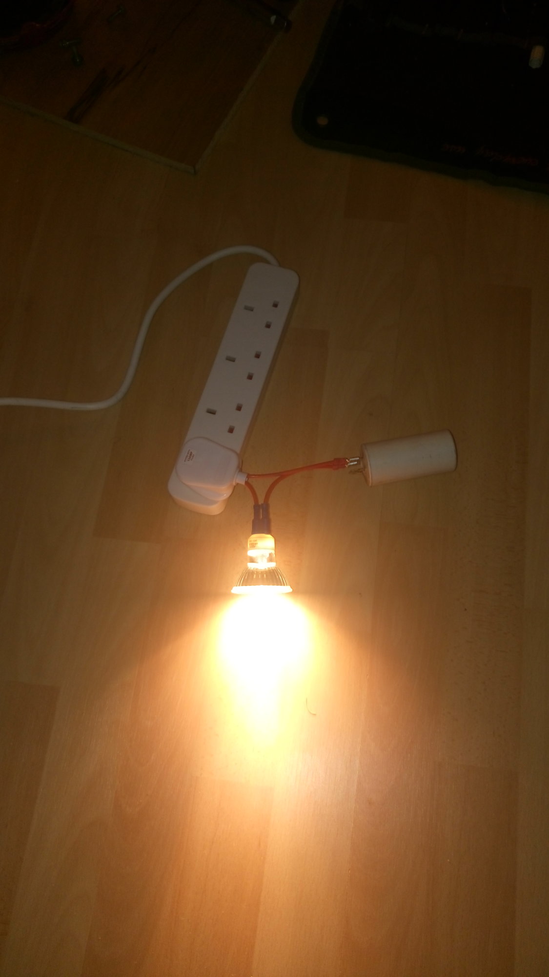

One way of testing the cap is to wire it in series with a mains lamp and see if the lamp works. The manual does list faulty cap as a cause for lack of excitation.
Thanks simon!
after searching through my supply of modern LED and fluorescent bulbs, I found a GU50. Inefficient old halogen spot lights to the rescue :p
I think it's dimmer than usual, but still putting out plenty of light, so I think the capacitor is probably OK.

Obviously the capacitor was bad, even though it measured a reasonable capacitance, held a charge, passed the bulb test and showed open circuit when tested with an ohm-meter. My suspicion is that it had dielectric breakdown but that this wasn't evident at the low test voltage of my ohm meter, or the 12v charge I applied from a car battery. As for the bulb test, a shorting capacitor would pass that too. If I remember I might pass the old cap to a mate with a megger to see how it likes that. :mrgreen:
