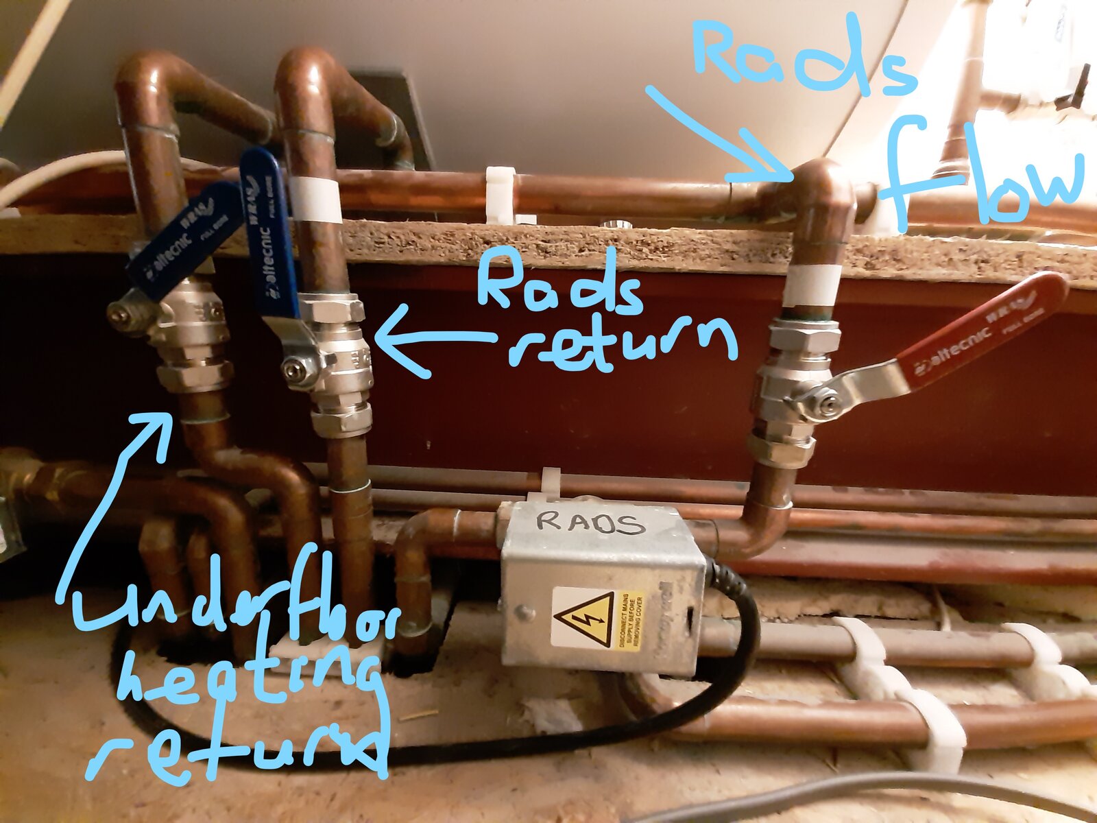

Should I open the lever valve a bit to get more flow to my furthest rads?
9 Jul 2008
149
3
I did a lot of balancing of rads in our house, but by the time I got to the final rads furthest away from the boiler, I just couldn't get the right temp drop even with the lockshields wide open. In fact one of those three rads struggles to get any significant heat at all.
I wonder if there isn't quite enough flow? I notice that there is a lever value that is half closed in the main boiler room - it's just before the radiator zone valve. See the picture below.
Should I open that lever valve on the radiator flow a bit more?

Worth a go. Lever valves aren't really suitable for use as balancing valves anyway, if indeed that's what they're being used for

No idea why it's half shut like that. The original installer went bust before commissioning so someone else filled up the rads and commissioned it but didn't have time (inclination?) to do all the balancing. Can't be sure which one of them put the lever at half way, but suspect it was the original installer.
Didn't want to touch it without asking first though in case it was for something important.
Would you suggest just opening it up completely, or just maybe 3/4 open and see if that helps?

I've got just one underfloor heating area - in the kitchen. It's handled by a wunda manifold which has three loops, each with their own flow meter. I was able to get the UFH balanced quite nicely at the manifold. There are lever valves on the UFH in the boiler room too and in that case, both the flow and return are half open. But I left them alone because I was able to get the UFH balanced and working well. Is there anything bad about leaving the levers half closed on the UFH flow and return? - E.g. if I open the Rad lever valve, but leave the UFH lever valve half closed, will that deny the UFH of any hot water whenever the rads call for heat?

Without actually being onsite and seeing the system in it's entirety then it's difficult to see why the valves are there and why they've been set the way they are.
When balancing a complete system, the starting point is everything fully open when it comes to the main flow and returns as there's very little real control using the lever valves.
I wouldn't be worrying about the temp drop until getting all the rads to heat up properly, once that's achieved then look to fine tune the temp drops across the rad.
