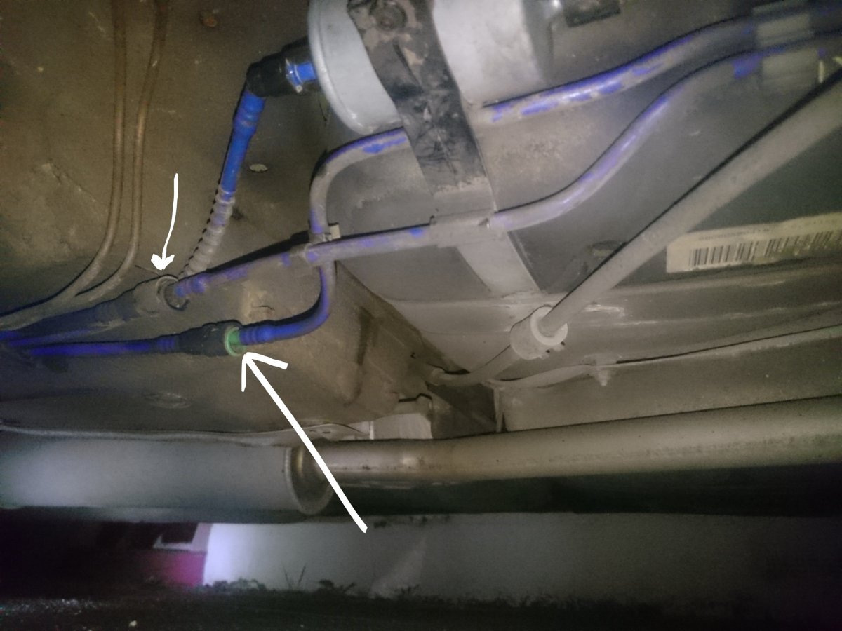

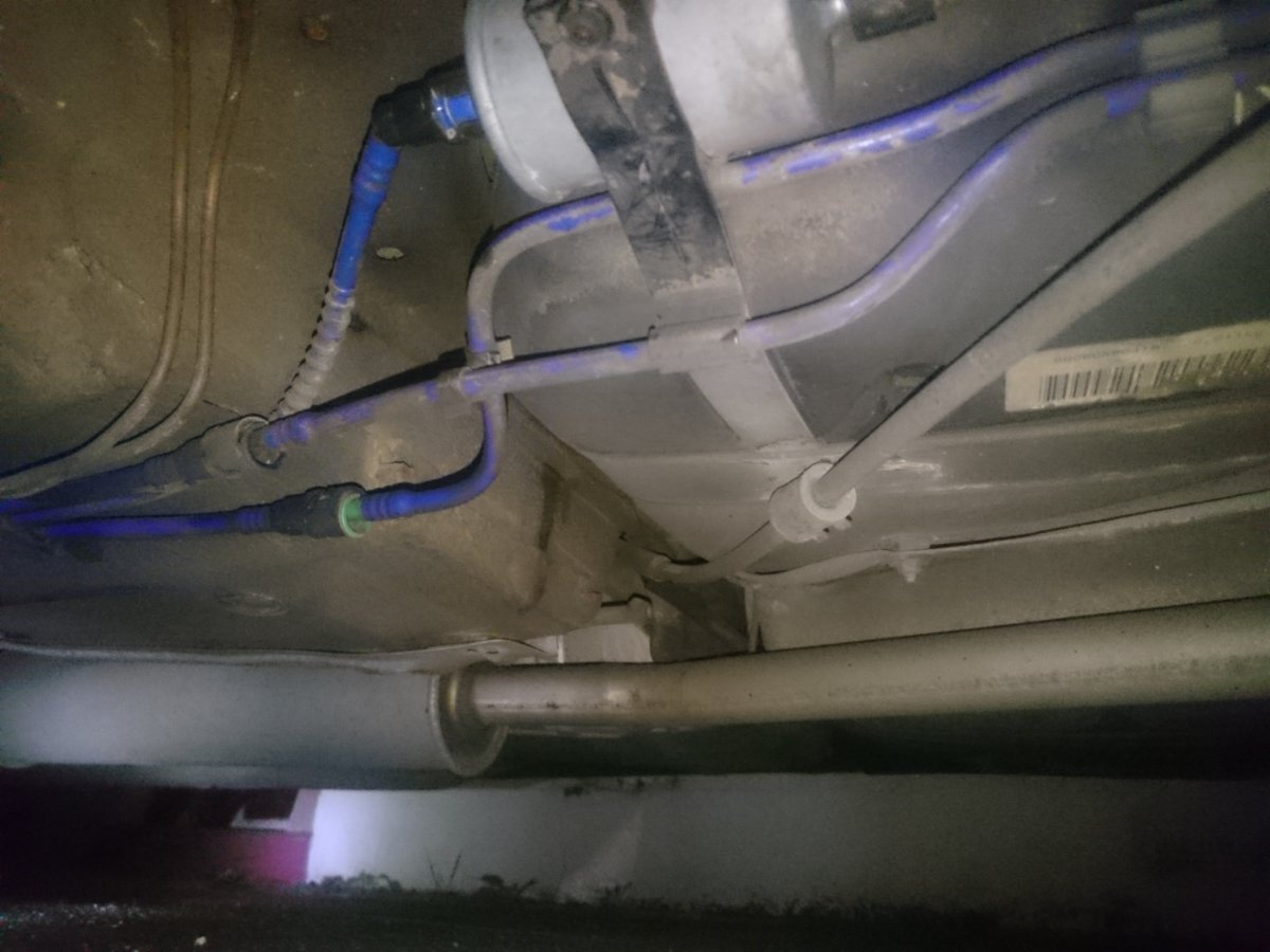

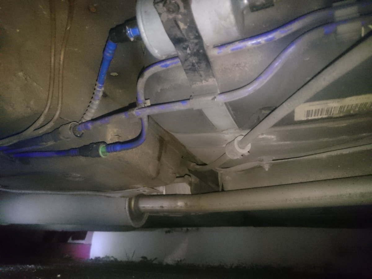

Hey everyone, I've been trying (and thus far failing) to change my fuel filter and have noticed this blue line on the right looks like it's coming loose and perhaps that green part should be fully inserted as on the left blue line, before I fiddle with anything - should this actually look like that or is it coming loose. Just wanted a quick safety check from experienced eyes :)
Also, would anyone be able to point me towards some pliers for releasing those stuborn plastic clips on the fuel filter? Many thanks! :)

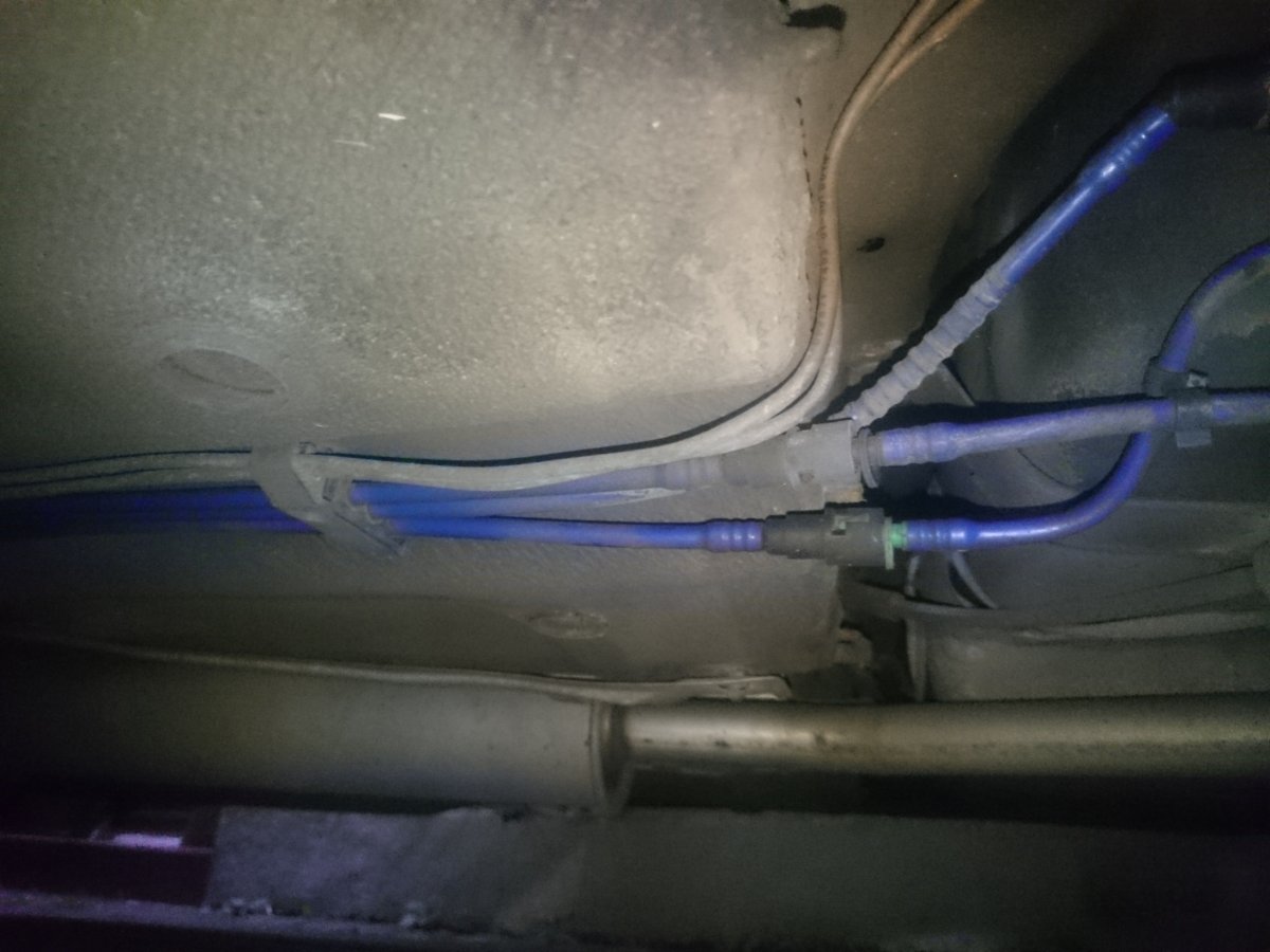

Hey John cheers for that, do you think I should get these bits checked out? To be honest I'm not even sure what they are but kinda look like they're coming loose. Wasn't sure if I should try pushing them back together. Thanks again.

These connections actually have a pretty sophisticated seal inside so I'd leave well alone.....an MOT tester would shout if there were any issues.
Some of the connections have a 'Y' piece incorporated so they do tend to look off centre. The connections are only interfered with if the fuel tank has to be dropped or the rear axle renewed, and they are checked for leaks afterwards.

The loose green part is a piece that is designed to break off to show that the connector is fully home.
Hope this helps
