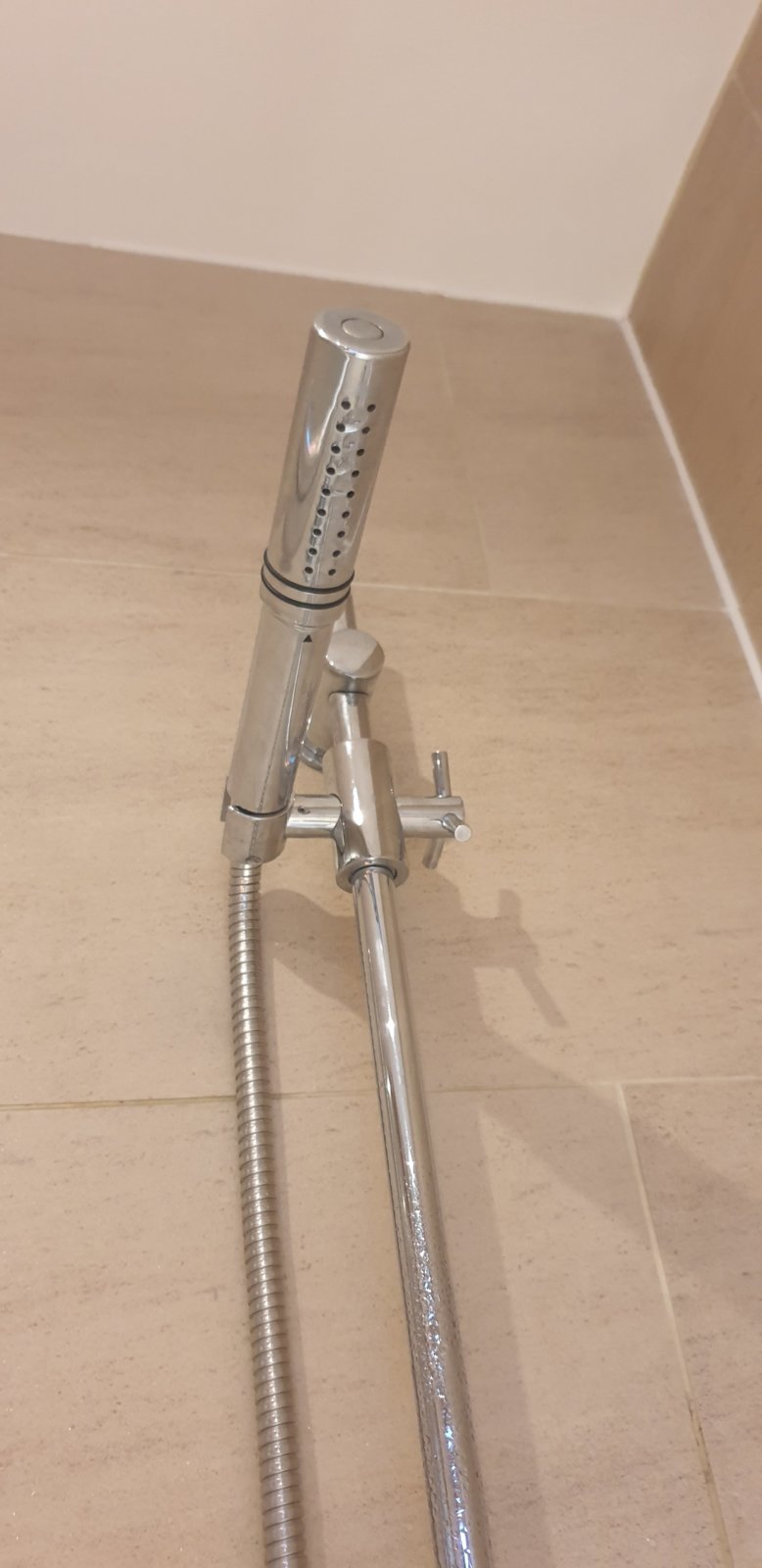

Ianmcd, I tried as you suggested & the boiler read a constant 48c but as soon as I turned the bath hot tap off it went up again to 67c then the boiler cut out, I did replace the thermostatic cartridge as I had the old one out & the rear of it was damaged but no change at all, When I turn the flow up in the shower the heat stays constant at 62c at the boiler & 45c at the tap but then the water sprays everywhere, I'm thinking I might have to change the showerhead as it's a small pole with about 12 holes in it so I'm thinking the flow is not fast enough & the water is overheating, when my wife has a shower the flow is about 6 litres a minute & it cuts out but if I raise it to 9 litres a minute the boiler stays constant at 62c but if I reduce the temperature of the shower to 34c the boiler cuts out ?
The showerhead looks like the attached pic.

Yep you have a flow rate problem, try turning the HW temp control on the boiler down to about 3/4 on the dial
