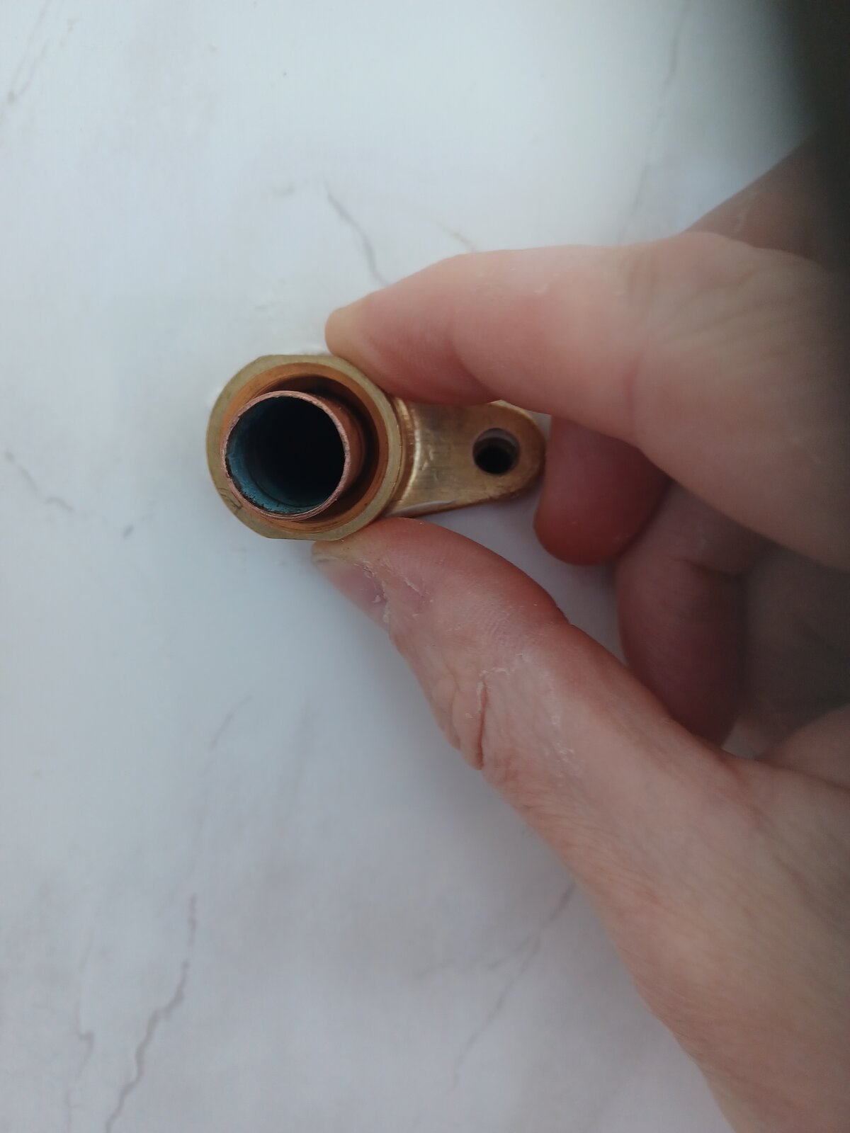

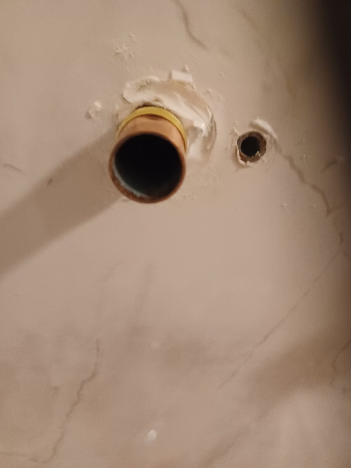

Hiya, I'm fitting our shower and have discovered that one of the pipes has got a small dink just where the olive for the fitting will be. It leaked like crazy when I assembled & tested it.
Any thoughts on how I can sort this out? Would a coating of Fernox LSX on the inside of the olive be enough to close up the gap? Could I put a bit of solder on there & smooth it out? Or is there some gizmo I could get to remove the dink?
Ripping everything out to replace the pipe would be problematic.
Try ptfe tape around the olive.
Say 10 wraps. Add more if needed.
Or a swaging tool might work if used gently.
Cheers dilalio, I don't think I will be able to get any ptfe round it when the fitting is screwed to the wall. :(
I had a go with my swaging tool and it doesn't go deep enough.
Where's the backnut?
That should be behind the olive!
Slide olive off, put backnut on, slide olive on, wrap ptfe around it and push it back into the nut and then shower valve on and tighten... Like packing a stopcock stuffing gland!

Cheers chaps,
I left the back nut/bracket off for a better pic of the dink.
I will give it a shot with your suggestions.
Presume that's wet board? If it wasn't then a bit of soldering could have been used to fill that depression and then sanded back smooth and round. Any way into it from the back?
Madras, aye it's PVC wetboard on an outside wall, so the pipes are buried.
Don't think it's necessary mate.
Ptfe should sort that easily... Christ the number of mullered rad tails that have been graunched to death... Tape sorts it every time x
Cheers dilalio, will go & grab some jointing paste to add to my collection.
