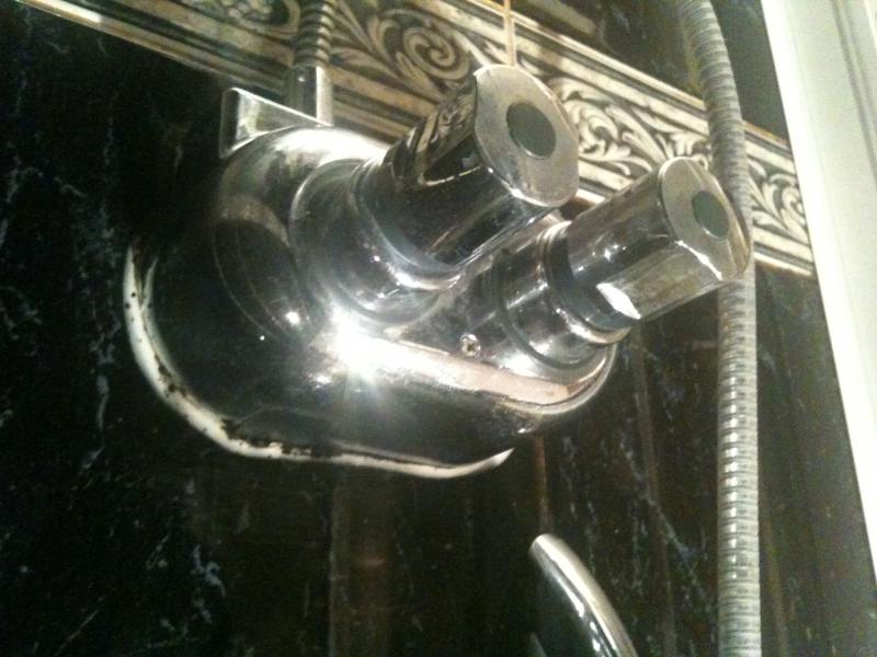

After 10 years of reliable service our shower mixer has finally given up the ghost.
After several valiant attempts at repairing it we are now in a position where you turn the tap and you either get a dribble or purely cold water.
Stripping the covers off will allow you to turn the hot and cold on individually but the unit has served its purpose and is looking a little tired.
The purpose of the post is to see if any of you recognise the make and model of the mixer unit in the attached photos.
There are no identifying marks on it and, preferably, I would like a like for like unit for ease of fitting more than anything else.
Any help or suggestions would be ratefully appreciated.
It's a Trevi, made by Ideal Standard. Possibly a Trevi Boost Venturi.
http://www.ideal-standard.co.uk/trevi-boost/venturi-shower-shower-e9105aa.aspx
Where does the hot water and cold water come from?
Taking a closer look at the knobs, probably a Trevi Therm.
http://www.ideal-standard.co.uk/trevi-therm/thermostatic-shower-shower-a2158aa.aspx
