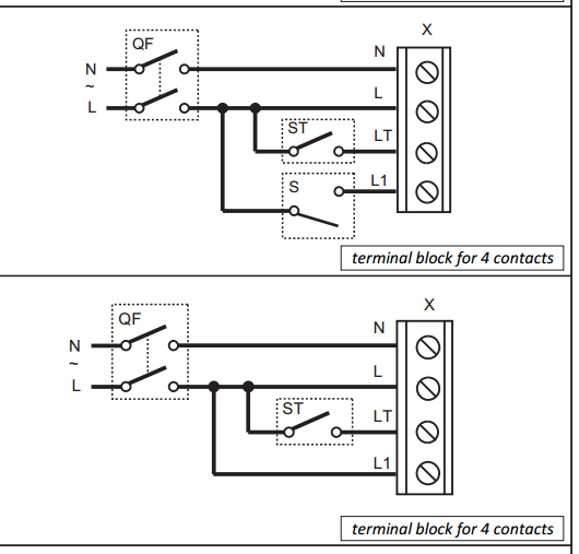

Post a picture of the wiring diagram you have - just copy and paste picture - or say if it is the same as I have posted - is it the bottom one?

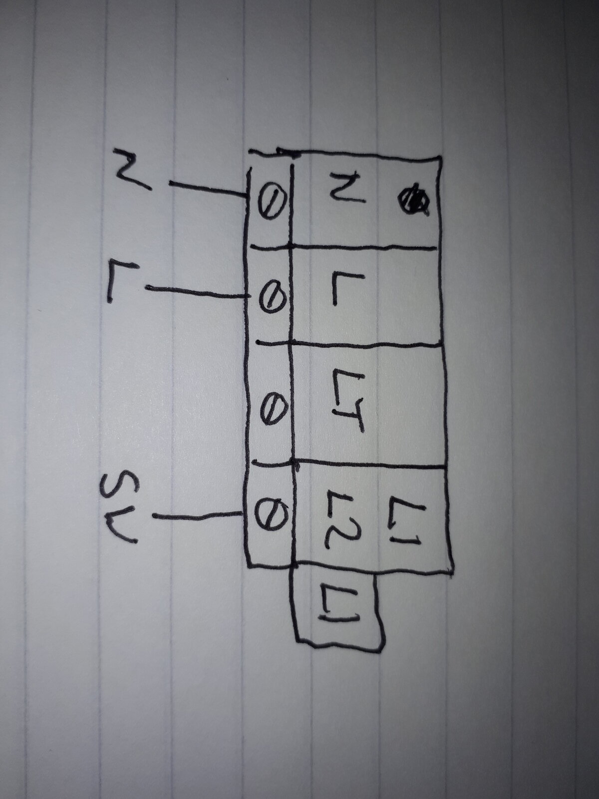

That is the diagram as with unit, It shows both my understanding is one is for min speed and other is for max speed
Yes, but the top one has two switches.

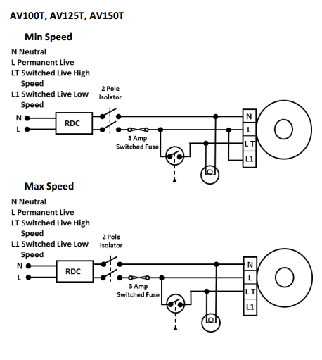

Anyway, here's another:
The wording on it isn't quite right so ignore that.
So it should have worked on max.speed when you connected the SL to LT.
That implies something else is wrong.
For min.speed you connect Live to L and L1 and if there were a switch on this link wire you could choose either.
Therefore you were right to connect SL to LT so now you have to test for something else wrong.

I don't understand your diagram.

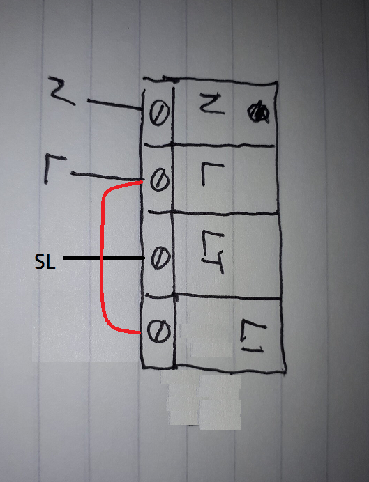

This is what you should have.
The red link is only necessary to make the fan go at slow speed.
Many thanks will give that a try and hopefully it will work.
The 3 parts you blanked out i take it have no relevance?
The out L1&L2 were printed on the board but no facility to connect which threw me a bit.
Have tried as you suggested and working - brilliant !! Thanks again for your help.
