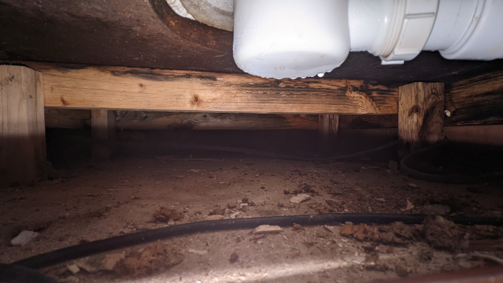

Had a shower leak. The usual thing with silicone needed redoing and the grouting wasn't the best. Redid all the silicone and regrouted the poor sections. Then discovered the trap hadn't been fitted properly, so redid that but had to replace the seals and top section but couldn't replace the lower part of the trap because it's been boxed in with 2x4 and only have 70mm clearance.
Problem is, it was absolutely soaking under there. I dried it out, and the chipboard base of the shower tray is black it was so soaked. Used shower against the wall and silicone etc after it all dried and all good. Continued to let underside dry out and used shower a couple of times. Check underneath after every shower... all good!

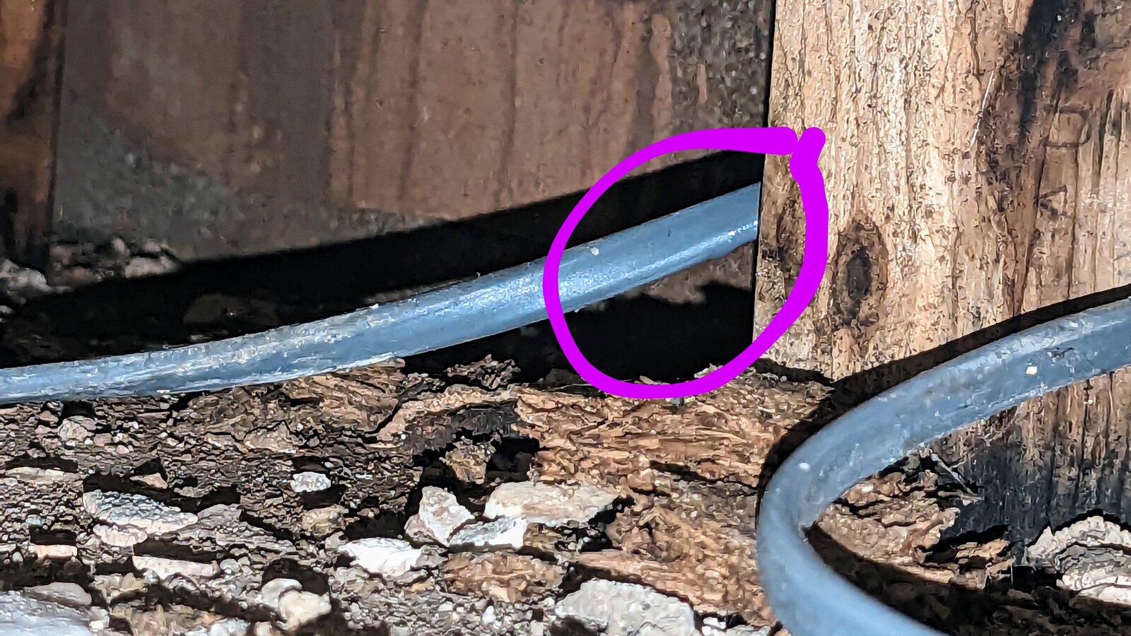

Except, went to have a shower earlier and checked underneath and it's soaking on the 2x4 frame farthest from the trap or any of the supply pipes.
I can't work out where it's coming from. There has been a mould patch on the ceiling which happens to be above the wet 2x4, but that would require water running down behind the tiles... could it? But... there is no sign of wetness above and no wet patch per se just condensation type black mold.
Exasperated! Considering a UV dye next....
Thanks for listening!
Mike
Tldr - sealed most of the leaks but one remains, timing seems to take a while after last shower, and it goes from dry and soaking so hard to pin point where it's coming from. Almost looks like it's been misted or sprayed. Or condensation. Wierd.

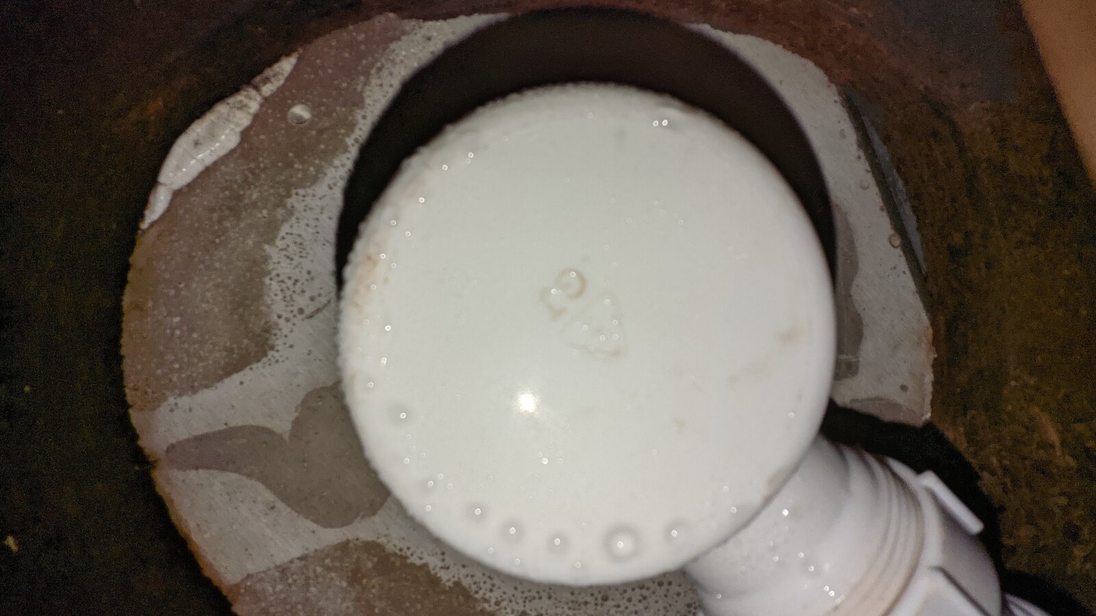

Came out this morning to find that the bottom of the trap is wet. In wondering if this is condensation.

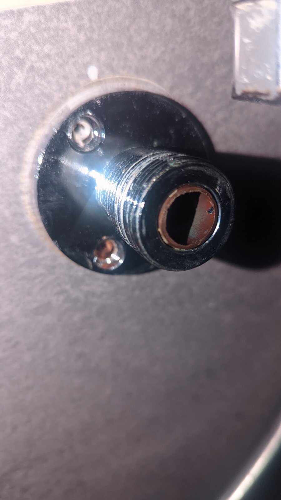

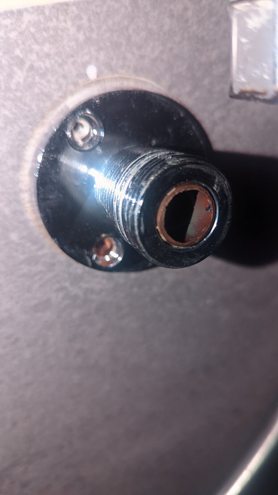

Also I've taken off the shower controls to check the incoming pipes and to see if there is any evidence of a leak. I'm wondering if it's water making its way between the copper pipe and this threaded piece. Would it be worth sealing this tiny gap and behind with silicon or would plumbers mate be better? The pipe themselves look ok as they come through the wall about 5".
Edit I can now see how those brackets fix and there is indeed an olive and a lot of plumbers mate behind it lol.

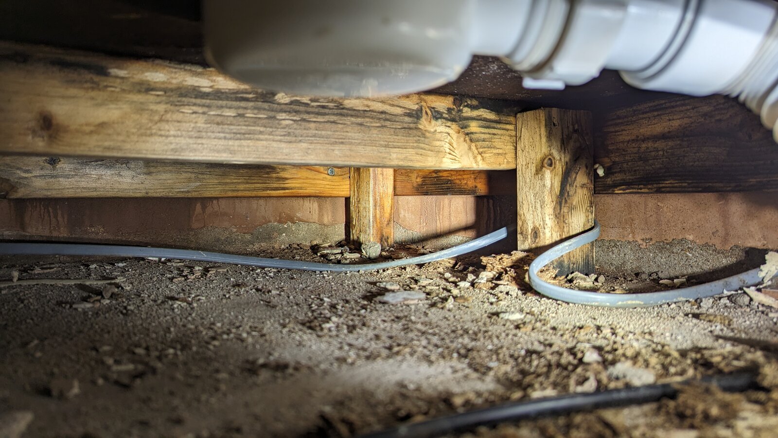

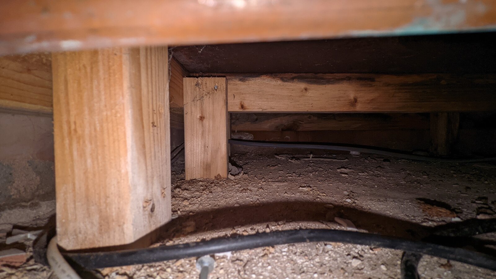

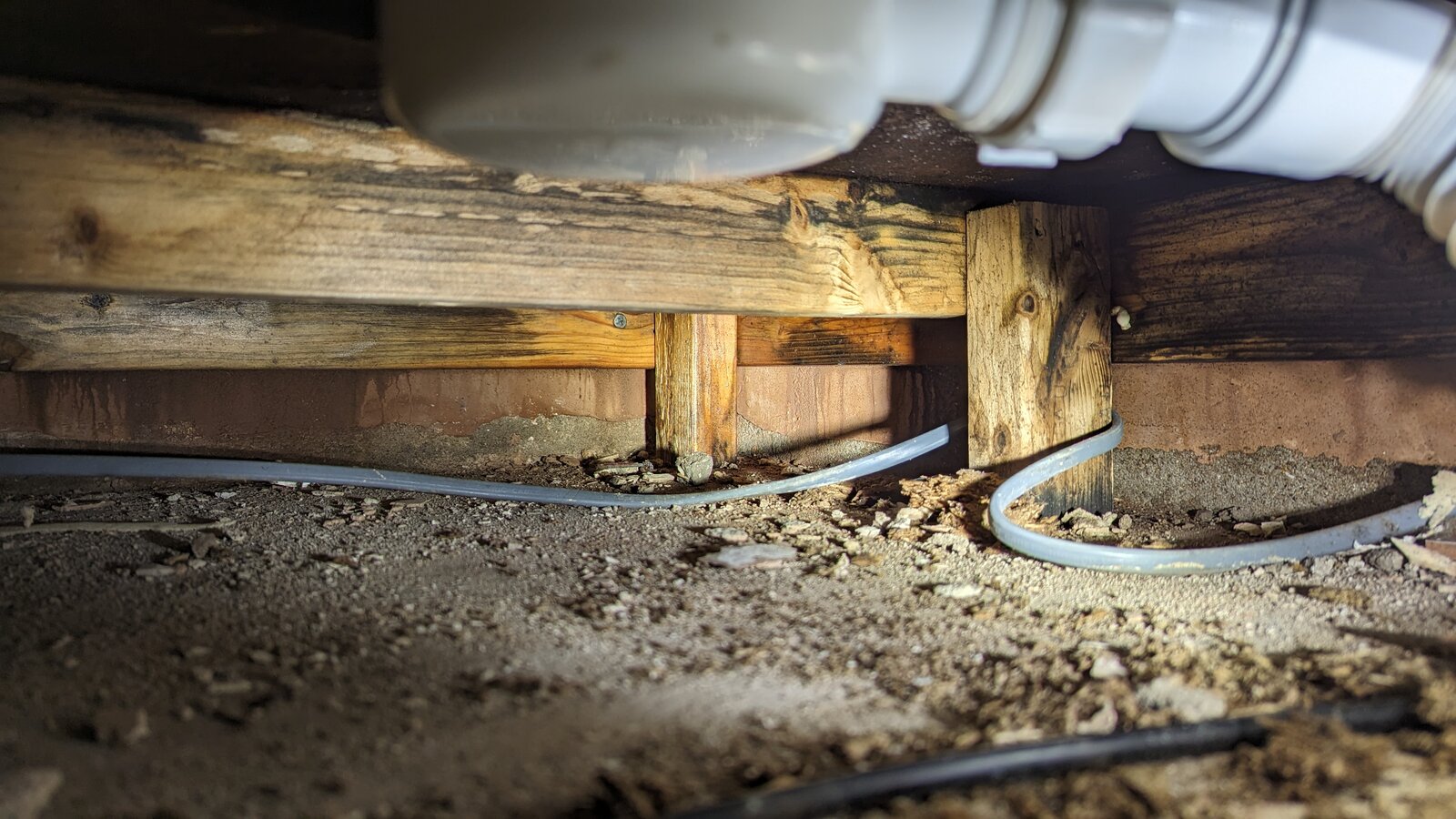

Some more photos showing beneath the shower, which has not been used for 2 days and the water is turned off.

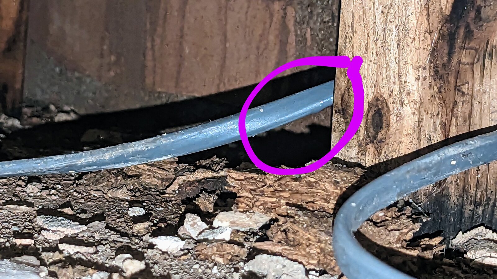

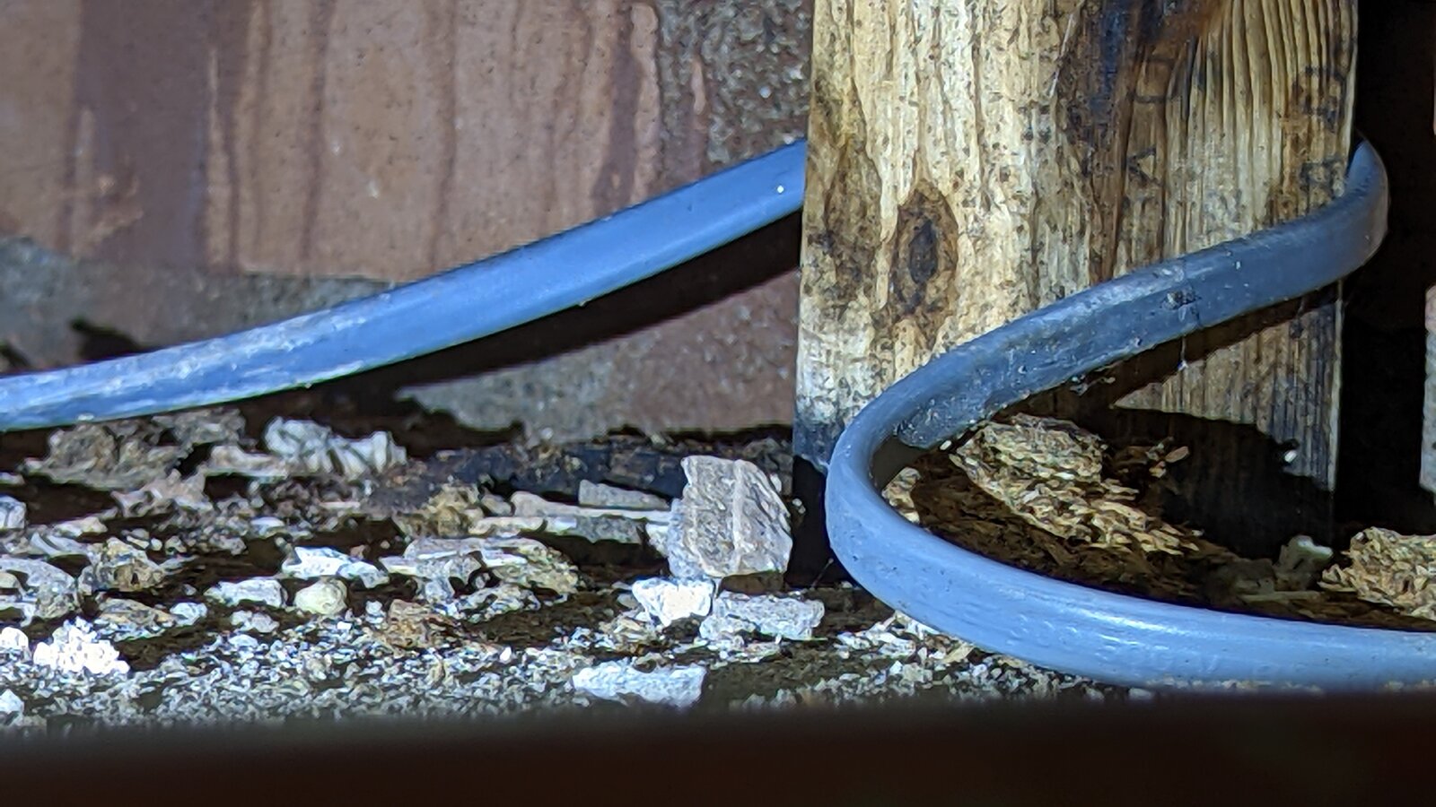

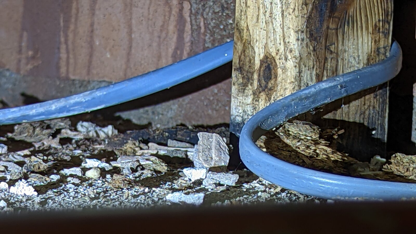

I managed to get it pretty dry beneath the base and my telltale drip that appears on the electric cable was gone. So I ran the shower on low pressure directed into the centre of the tray and a few hours later the dribble is back.
I can't see a crack and I didn't spray it over the silicone or the tiles.
Dribble is appearing just behind the upstand in the photo.

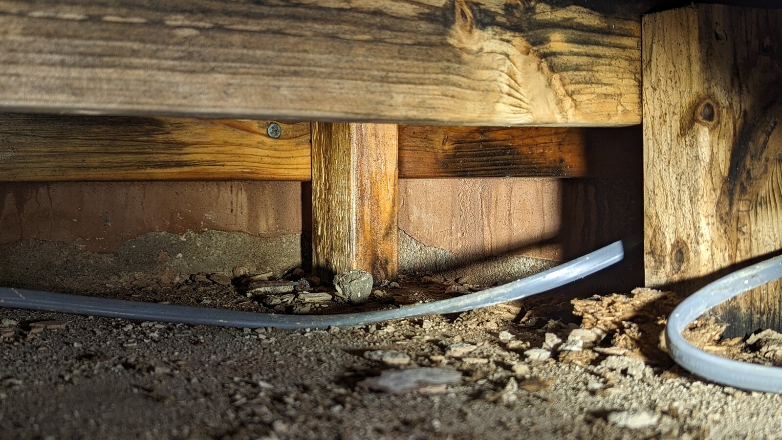

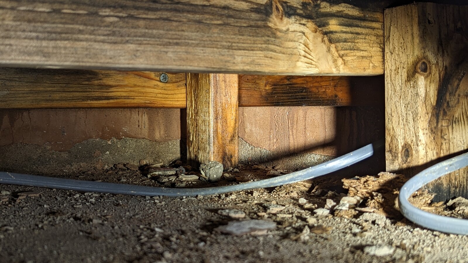

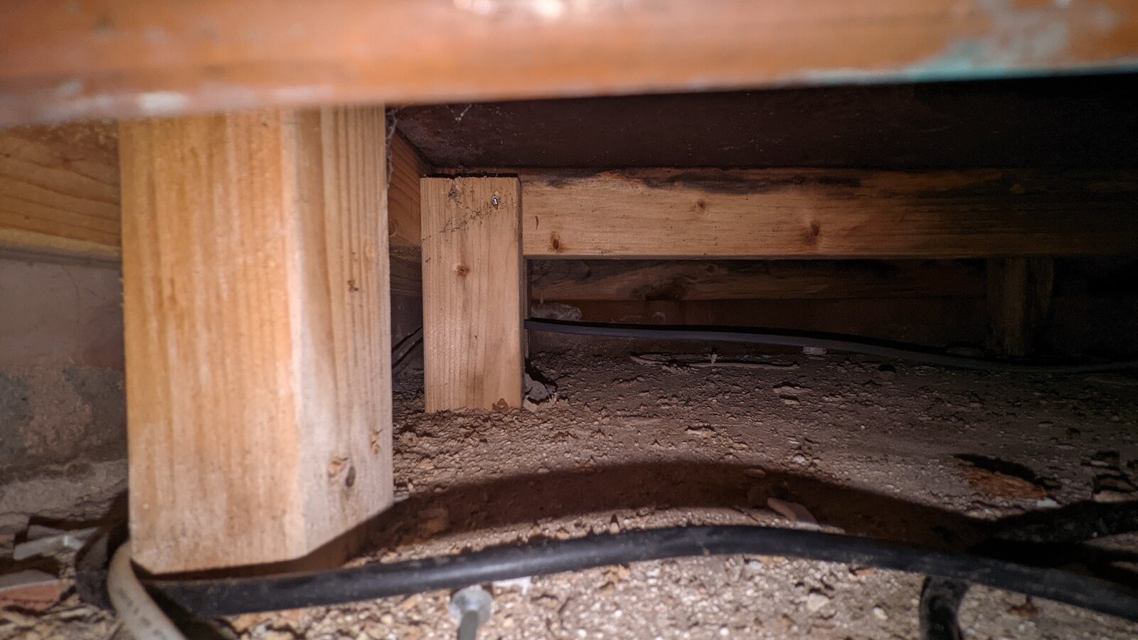

Still trying to work this one out. I've not used the shower in days, and it was dry, and now is wet, so clearly the water is coming from somewhere other than the tray. I think.
The thing is there is nothing at all behind that corner. Its a brick wall. There is a waste pipe on the other side of the wall, but its at a lower level than the timber work here which is damp. The cable shows a dribble again, despite being dry for a few days.
There are pipes above the ceiling void above the shower tray but even those are not directly above this (unreachable) corner. I was hoping this was condensation but that seems unlikely as i've had the underfloor heating and towel rads etc on.
I just can't figure out where this water is coming from. Right hand side of photo is the exterior wall. All the render, guttering, etc looks good. Freshly exterior painted, 5 months ago. The rear of this photo is a brick wall and the other side is a small utility room with incoming water main (no leaks) and a gas boiler, and the aforementioned soil pipe.
Anyone got ideas please?
