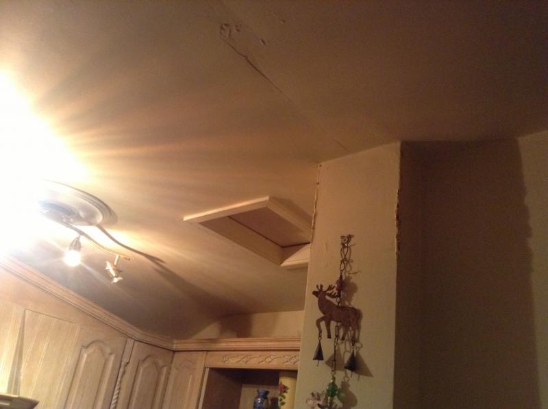

Regarding the floor:
We had a builder round last week who looked at the floor, poked around a bit and said "you have been lucky........oh wait a minute, nah, this and that has gone and it will have to be an insurance job, walls have to come out, and everything.....tell you what get the insurance assessor round and I will meet him, and convince him to comply that it is a valid insurance claim".
My thoughts on this clown are unprintable, and obviously wanted a bigger payout on an insurance job.
So, I obviously got a second opinion, and directly phoned another local builder, who when he came round with his colleague, I realise were both Polish. They seemed genuine enough, looked professional, so I asked them if walls had to be pulled down, etc, etc, and they said "unlikely".
We both had a looked through the hole after breaking through some of the chipboard that is down, and agreed that the joists looked bone dry. No mold smell anywhere and all looks fairly dry now that it has been dried out for a week.
We agreed that the best course of action would be to cut a piece of the ceiling down directly under the shower to fully assess things, which sounded fair enough, as otherwise you cannot fully see what damage is there. Makes sense to have a real proper look.
The guy is coming around tomorrow to cut the ceiling piece out to check, then quote me a price to fix, see image of a piece he will cut, directly under the shower:
I asked him on the phone today if he had public liability insurance and he said yes.
Is there anything else I need to look for, be aware of, ask, etc. ??
Thanks. I am a little bit nervous about this, as you can imagine.
Not quite sure why he'd go from the downstairs. I'd have thought it easier to cut out a section of floor from above - then use mirrors or a camera rather than ruining your ceiling - and then paying them to repair it, (and paint it?).
I don't know the full context - there might be a need.
If it were my house:
joists = structural. If they sound then thumbs up
Walls = are they load bearing? If not then it doesnt matter if they are a bit rotten - they are not supporting anything and will dry out.
Floor = replacable. I'd rather cut a larger piece of chipboard out and then replace/reinforce with noggins.
The builder that came to assess my house drilled a 17mm hole and then stuck a periscope thing down to avoid being destructive.
Hope that helps - end of the day you've got to go woth your heart - is it worth paying more for peace of mind, and to get back to normal? Some say yes. Some no.
Whitling2k
Hi Whitling2k, thanks for the reply.
The reason going from underneath was suggested, was due to the corner position, and a bedroom being right next to the shower (left hand wall) and not being able to see that far, but like you say maybe a camera would do that.
Regarding load bearing, it is an on suite room, that has been added onto the main bedroom, right above the kitchen. Quite a large extension was added to the house about 10/12 years ago (2 bedrooms garage to extra living room, and on suite bathroom), so no idea if load bearing, but as I mentioned one of the added bedrooms runs parallel to this on suite.
