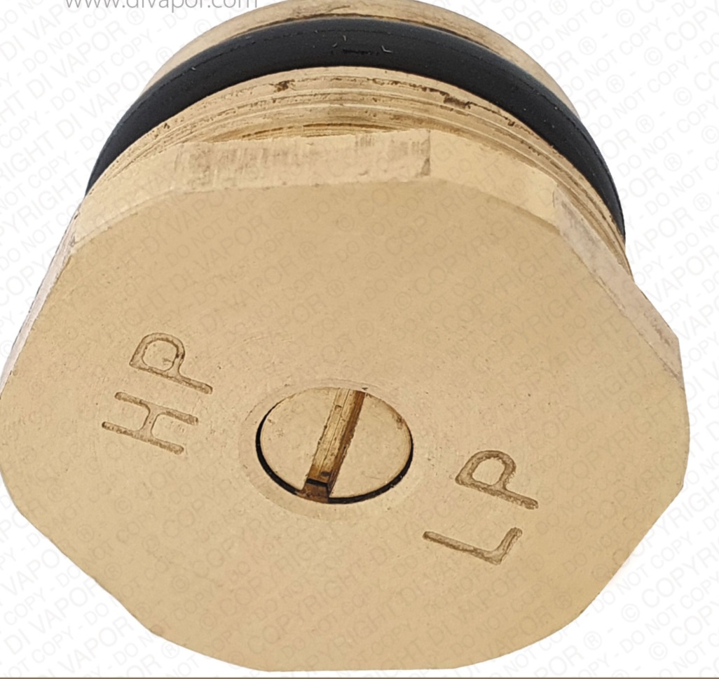

Anyone know what this is and what it does? It's on my thermostatic mixer shower?

It you have a high pressure system ie combi it’s the hp position
low-pressure ie tank feed lp setting
The screw in the middle just winds all the way in or all the way out..... not really a position..... wondering if it should be wound in or out
