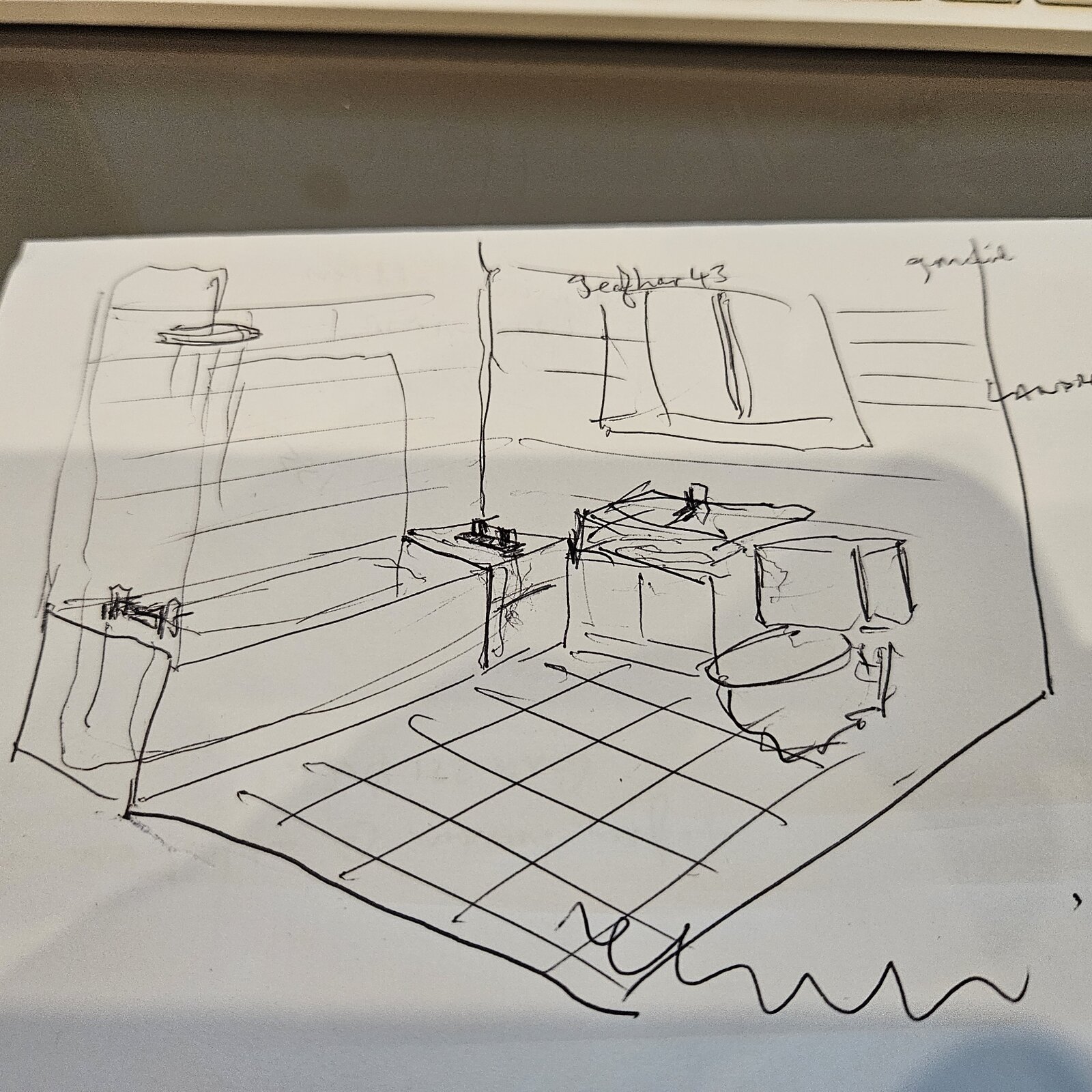

Hi
I am planning a refurb of my son's bathroom and want to fit a concealed shower thermostatic mixer valve but rather than fit vertically on the wall I would like to fit horizontally on a boxed in area at the end of the bath. Is there any reason that these types of valves cannot be mounted horizontally? The hot feed is via combi boiler and cold via mains water feed.
Any advice appreciated.

Why not just purchase a valve which is designed to be fitted horizontally in the first place? A vertical one will have markings showing hot & cold which will sit sideways if you mount a vertical one horizontally.
All the valves I've looked at just seem to assume you are going to mount it vertically. Their instructions don't even mention whether the valve can be mounted horizontally. I've looked at loads and haven't found one that says the valve is suitable for horizontal mounting. I have actually done what you have suggested 'oldbuffer' and contacted the manufacturer for a valve that I would like to use.
By the way, just to be clear, when I say I want to mount the valve horizontally, I mean with the backplate horizontal and the knobs facing upwards
Attached is a rough sketch of what I want to do, showing the mixer valve mounted flat on the boxed-in area at the opposite end of the bath to where the drench shower head is. With the valve mounted in this location it will not be directly under any shower water and it allows you to turn on the shower before climbing into the bath so you can let it flow hot before getting in !!

Oh right - so you want to, in essence, deck mount a thermo mixer bar shower? No reason why not I wouldn't think, just wouldn't want the hand held, if there was to be one, being able to reach the bath water.
