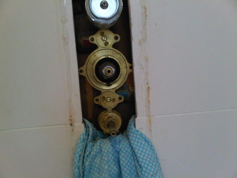

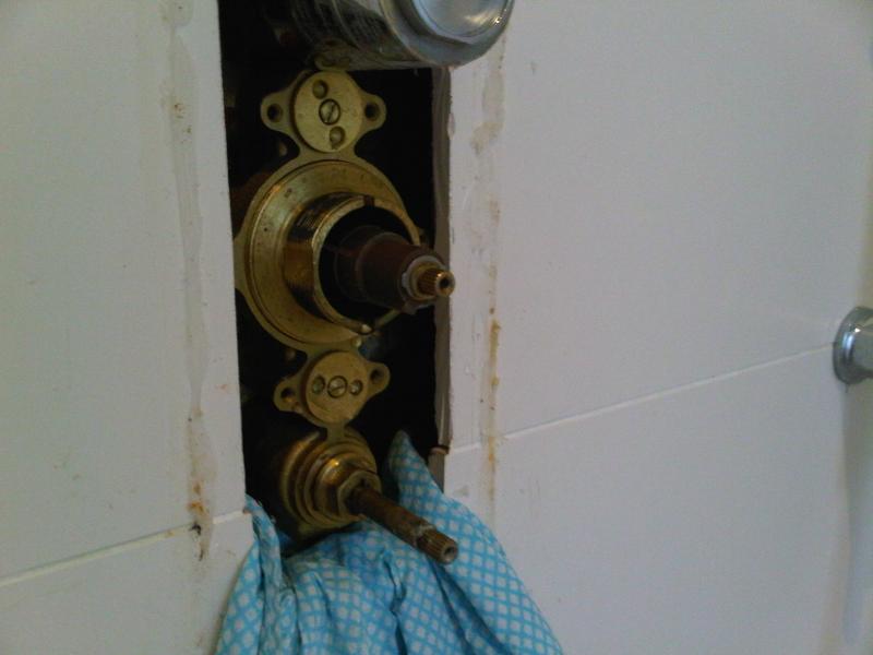

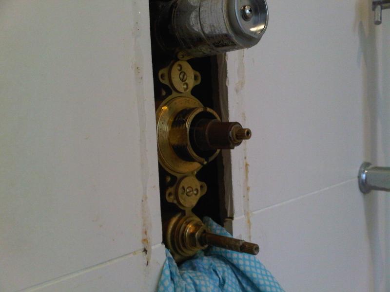

Ok, so I managed to cut away the silicone and remove the plate. Not entirely sure what to do next. The middle brown plastic fitment does unscrew but only a few revolutions and stops.
Please see my uploaded photos.
The brass casing around this brown plastic fitment looks to have a thread but I didn't want to try and unscrew this without knowing what would happen. It also appears to be rather tight.
Any help much appreciated
