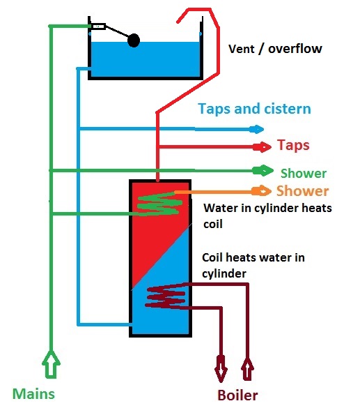

Faced the same problem when plumbing my cottage I opted for a hot water cylinder with a shower coil to supply mains pressure hot water to the shower.
It does involve the cost of fitting a new hot water cylinder but it works well without the need for power for a pump or an electric shower which will be expensive to run.

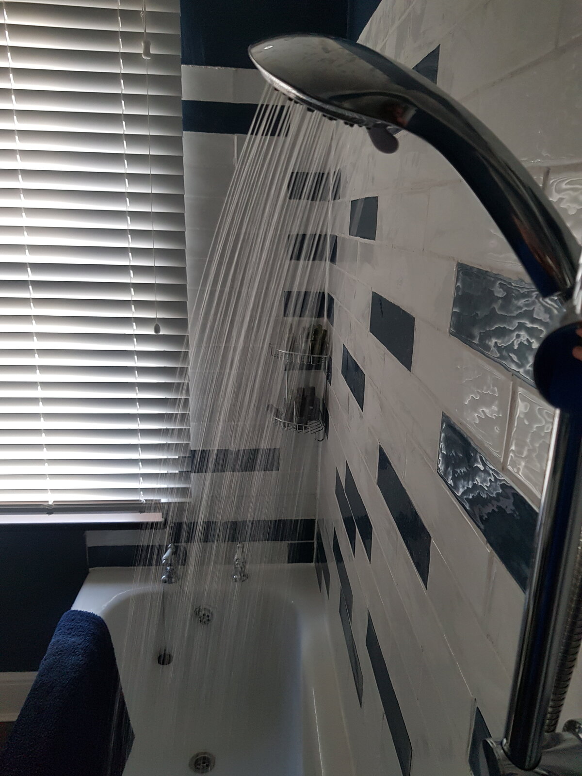

Fyi here is a pic of my bath shower in the same room running at standard 38 degrees, as you can see it's sluggish but doesn't need too much more to make it sufficient.
