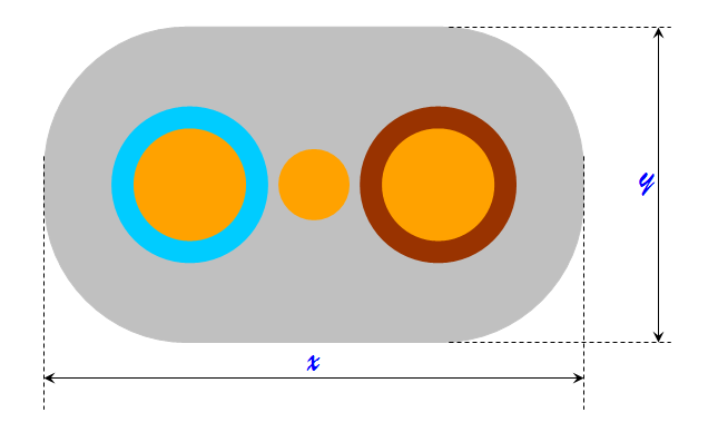

I did locate the measuring guide in Wiki but to be frank, couldn't make head or tail of it.
So a table which for each cable size tells you what its overall dimensions typically are, and what the diameter of each conductor is, makes no sense to you?
would it be correct to say that the size of a cable can be roughly assessed by looking at it in cross section and measuring width times height to find the size in square millimetres?
No.
Cable sizes refer to the csa of the L & N conductors, not the overall cable.
For cable you need to measure the diameter of a copper conductor...
You can use a ruler to measure the overall size, and then look up in the table what a cable with an overall size of x x y would be
.... even assuming you could find a section of cable where the corners were absolutely square.
You still seem to think that if a cable is stated to be, for example, 6mm², that that refers to any overall dimension. It doesn't - it refers to the csa of the L & N conductors, and they are not even slightly square.
