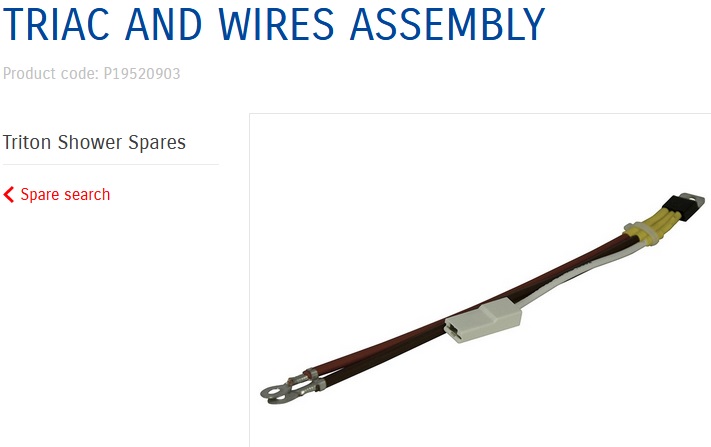

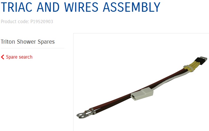

It seems that Triton showers do use a triac but how it is used is unclear ( from available information )
The triac may be used as a solid state switch for Power ON power OFF
https://www.tritonshowers.co.uk/spares/triac-and-wires-assembly-p19520903.html?spares=true
