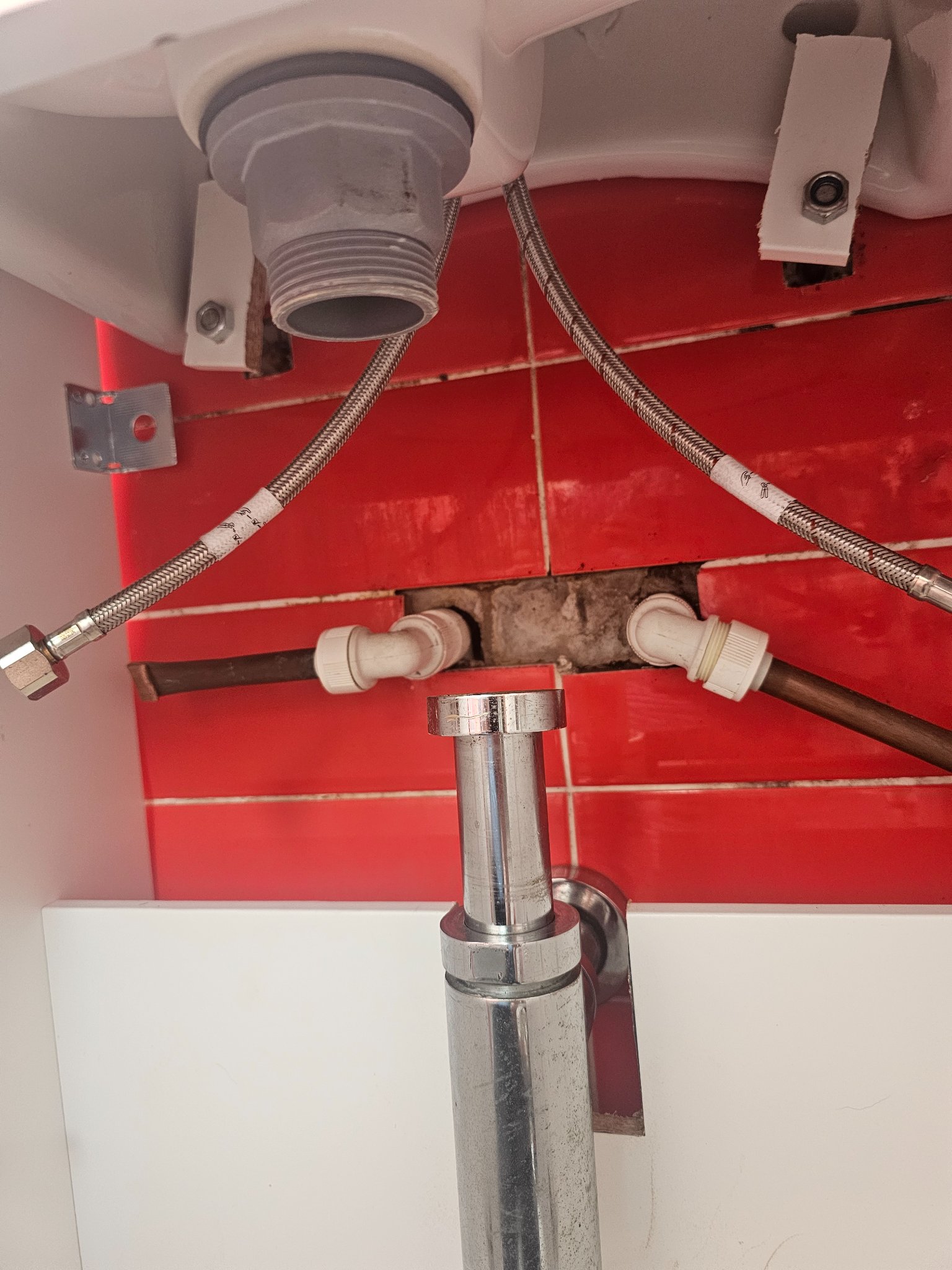

hi all. A glass shower screen that pivots at the top and bottom became detached and smashed my sink to bits!
Anyway the sink has now been replaced and it is a different model than the one fitted some 20 years ago. It's much higher and therefore the waste doesn't align.
So I need a flexi pipe. I took the bottle trap part to 2 local plumber counters and bought a myriad mostly mc Alpine pipes and connectors all of which have been an expensive waste. They are all slightly too big or not female to female.
Essentially I need a female to female flexi joiner to join end of waste and top of bottle trap.
Can anyone help my sanity and point to the correct part as i'm at my wits end.
thanks a lot

Id fix waste trap to the sink waste then fit new waste pipe and fittings up to waste.
Often you have to cut the waste pipe back to give yourself room to to get a dog leg in the waste pipe to line up.
Use solvent pipe and fittings..
Is that what you want to do?
Make and model of sink and the waste fitted in it might help (or not).
I'd be looking to replace that plastic waste with a decent brass captive flip style such as https://www.wolseley.co.uk/product/wirquin-wbk97w-basin-waste-spinner-slotted-11-4-chrome-plated/

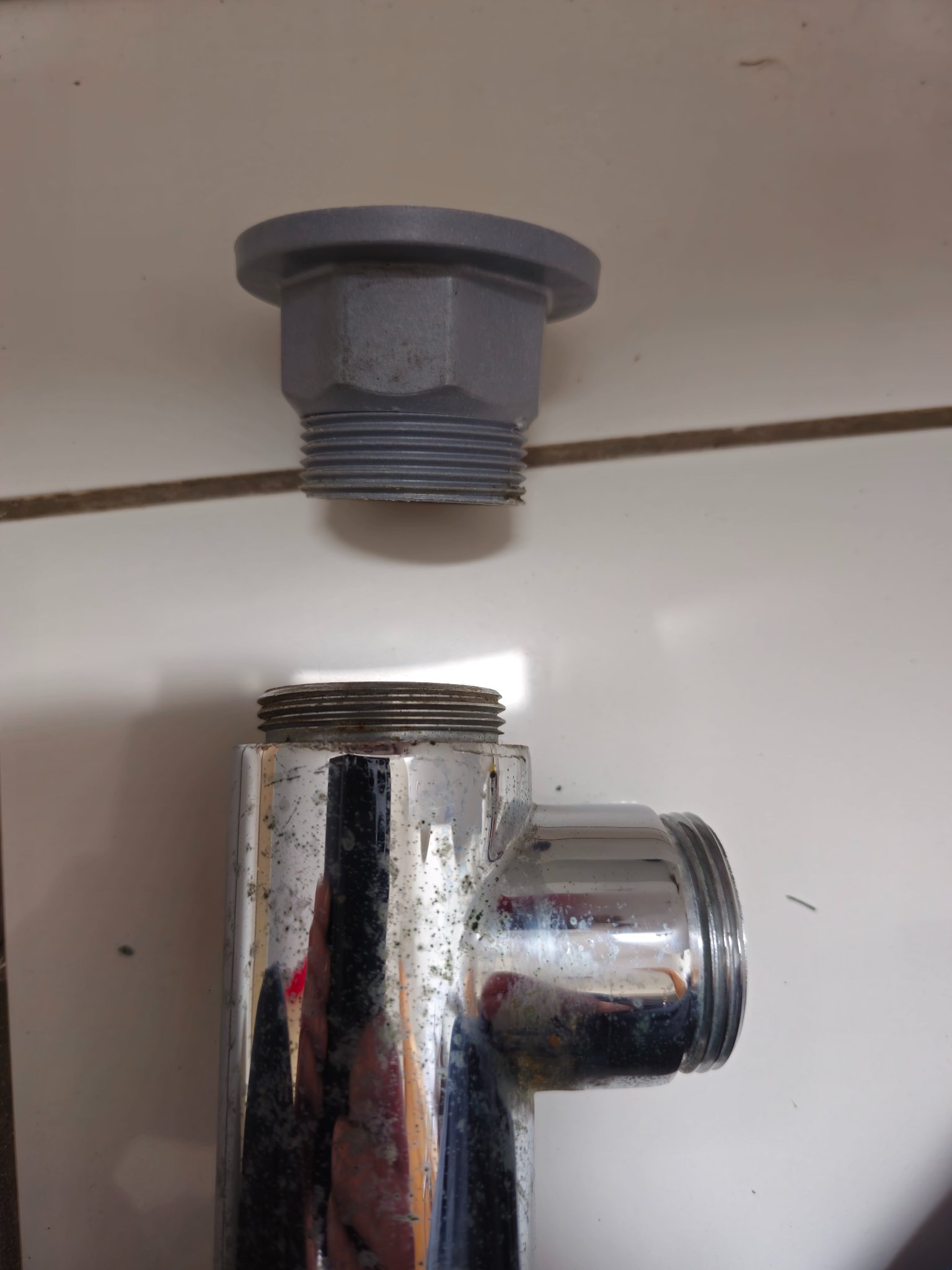

The chrome bottle trap is missing bits that are still on the smashed sink's waste, probably:
https://www.wolseley.co.uk/product/mcalpine-caa10-p-and-s-bottle-trap-125-x-75mm-chrome-plated/ may give you a clue?
You may need to replace entire trap to get the missing bits if they have been binned.

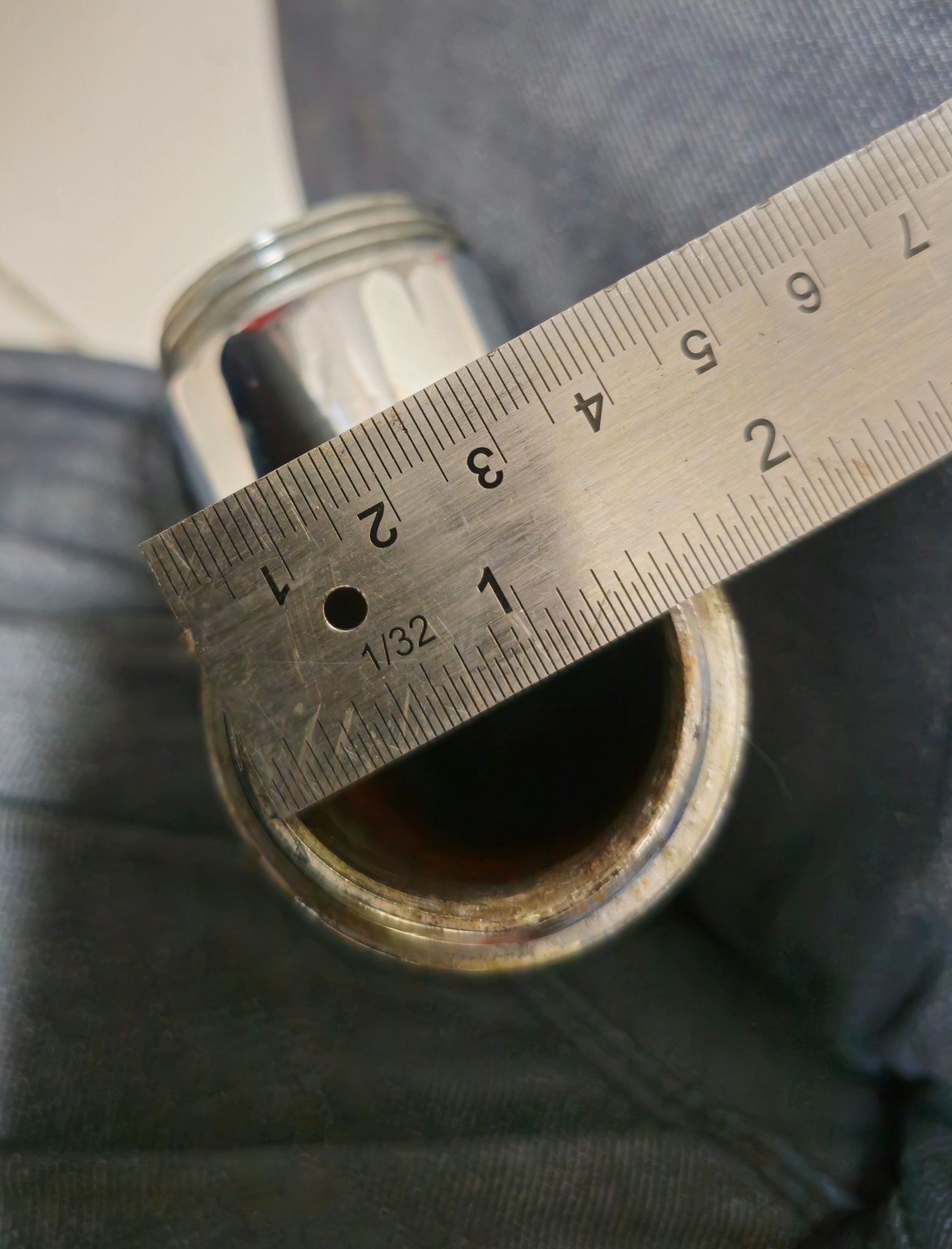

thanks for the replies. I was thinking of going the other was as both sides had the same thread but yes the waste could be an option. I ordered this in the meantime:
The old sing just had a basic waste same thread as the new plastic waste that came with the el cheapo sink.
effectively it's the large gap that's the issue. The old sink was so low to the ground.
I don't even need to keep the old chrome trap as it was all be hidden this time so even good old solid pipe may work if I had the knwoledge of what was needed.

Update all I needed was this:
I went to 3 plumbers and no one seemed to know what I was talking about. The fittings they gave me were all too big, despite the fat that I brought down the male end.
