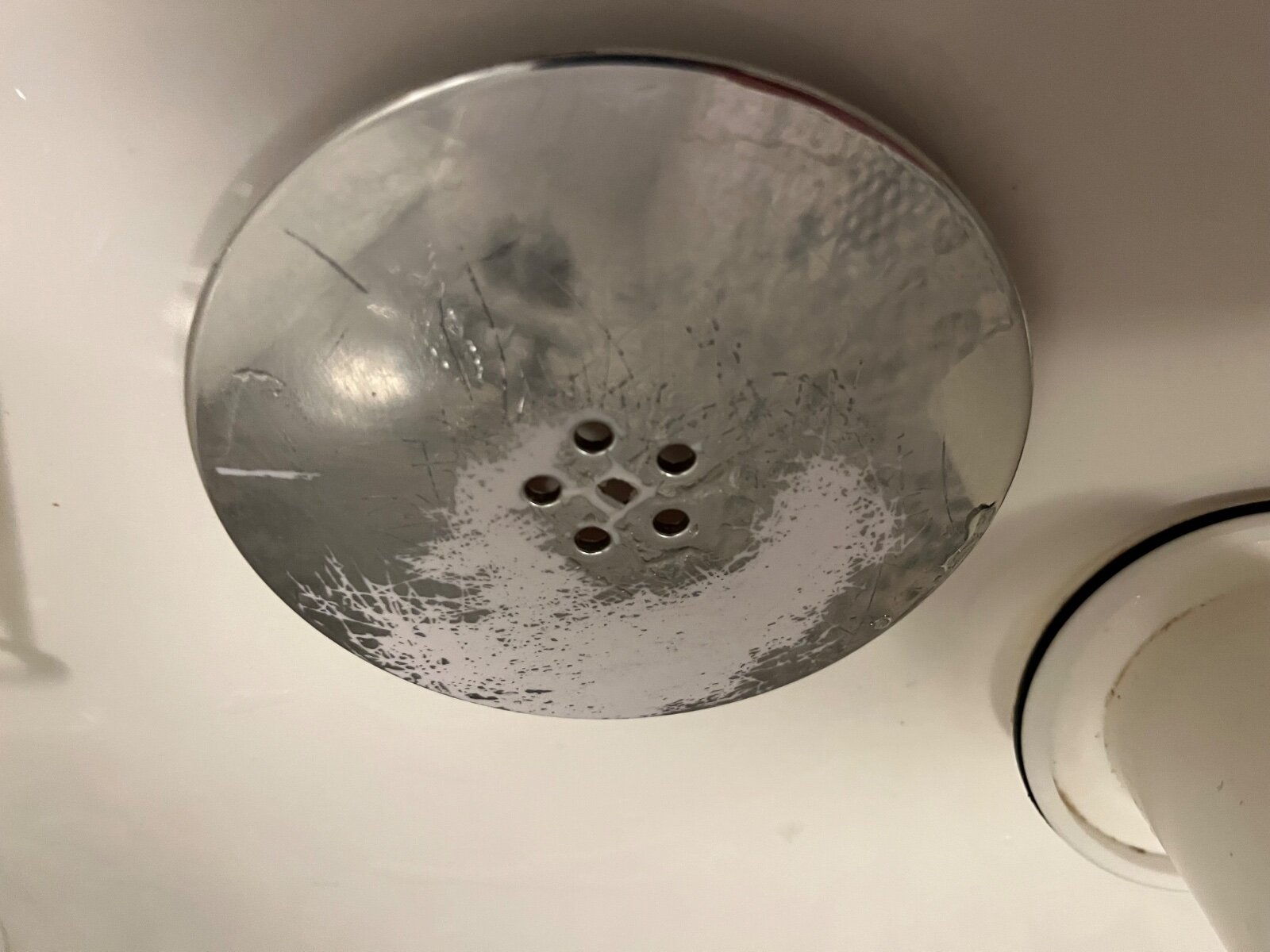

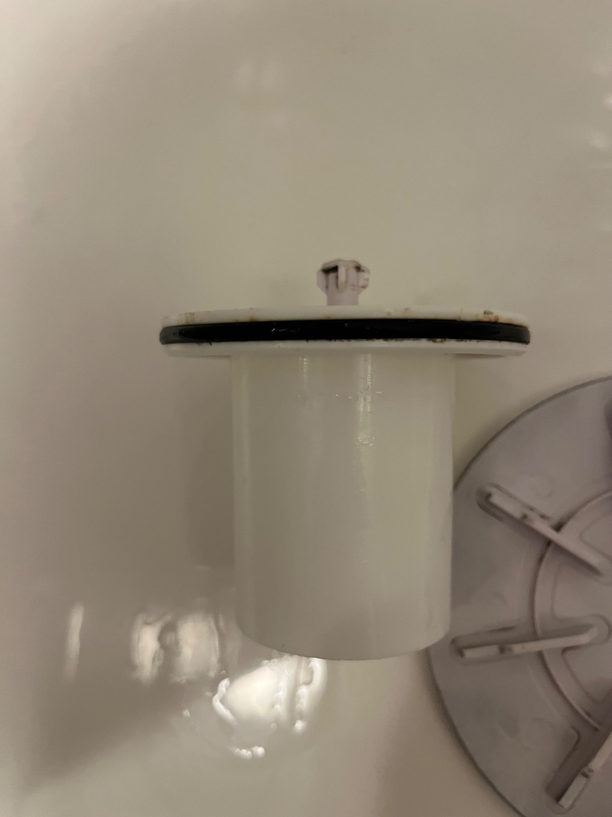

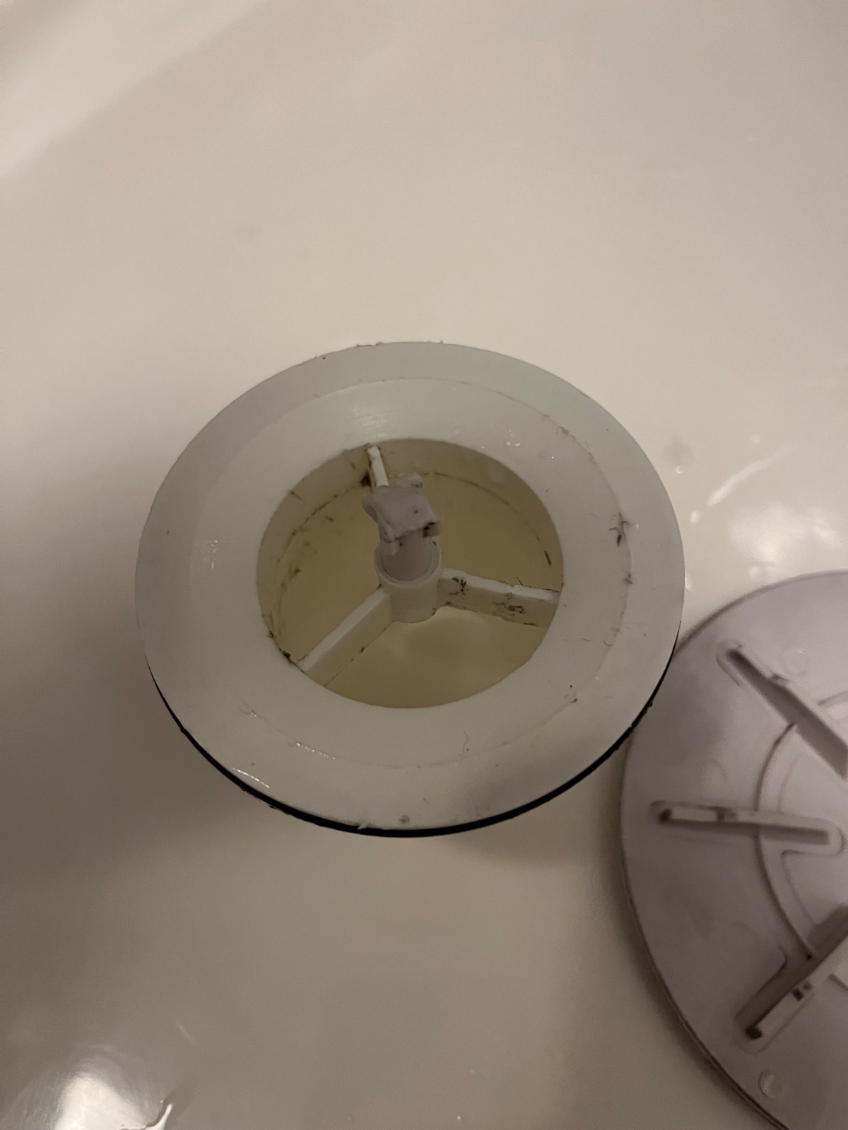

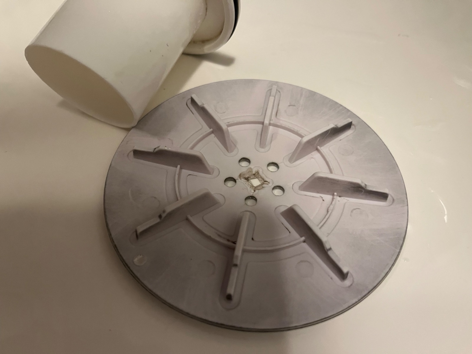

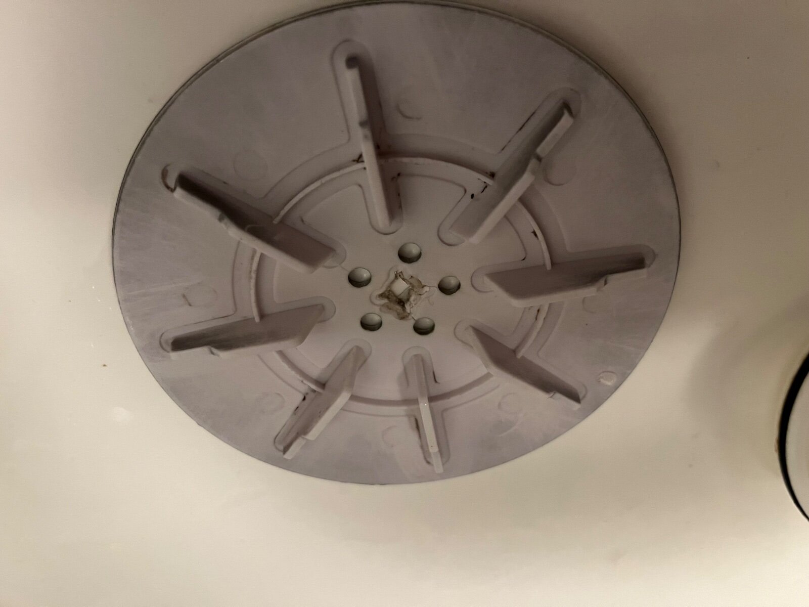

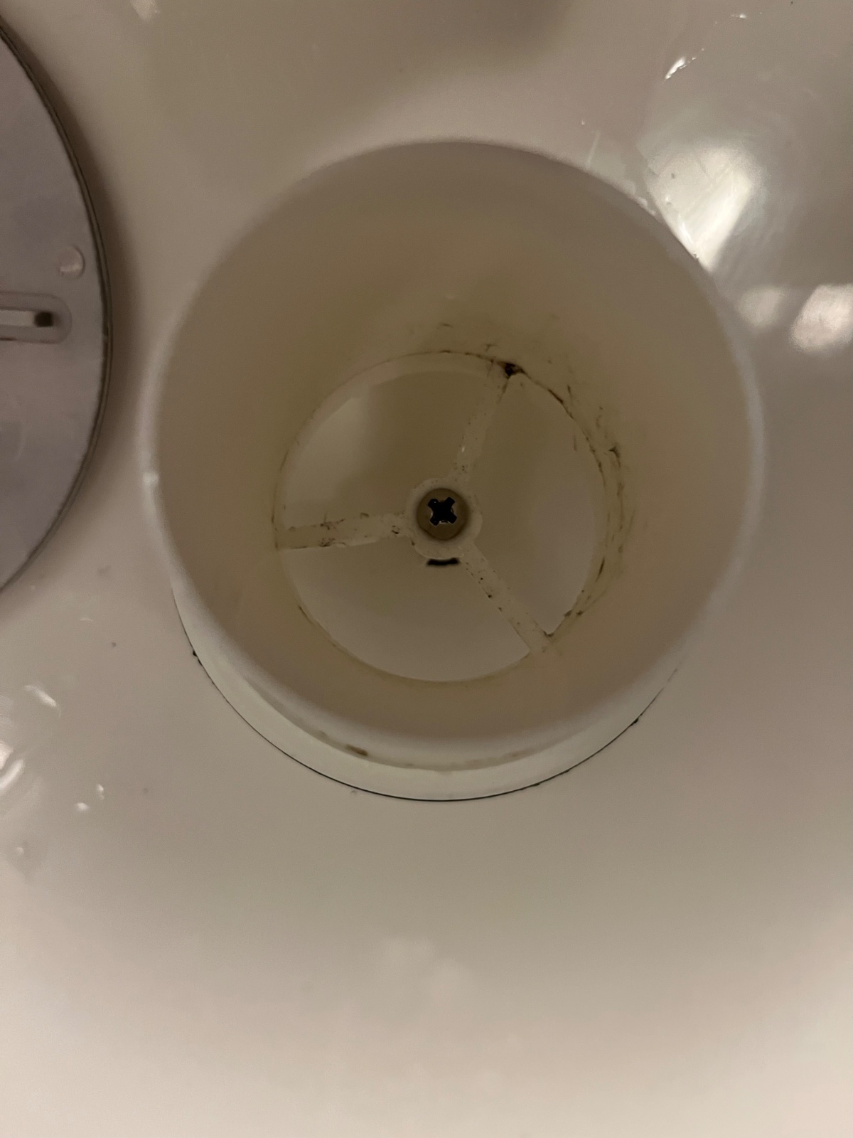

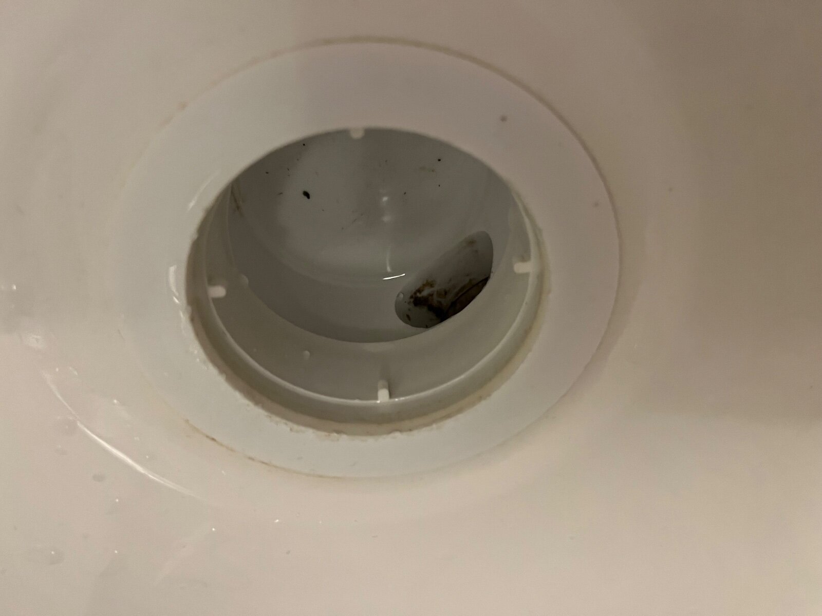

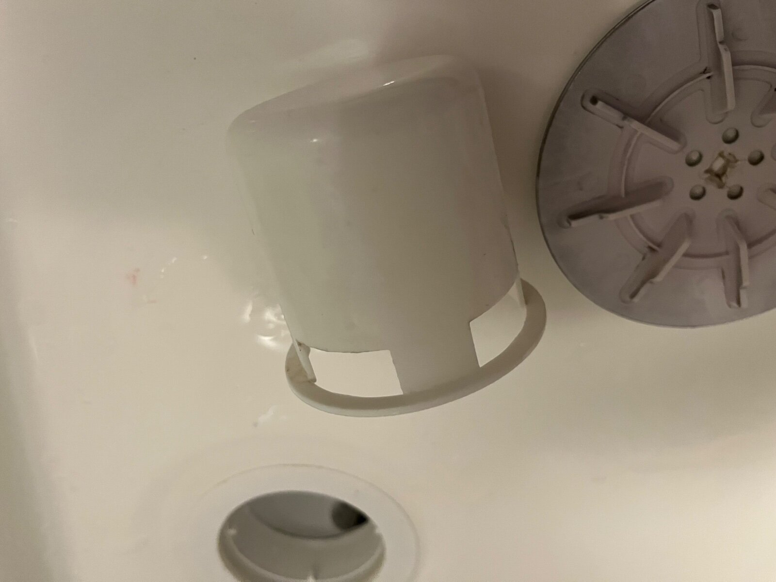

Can anybody ID this shower trap? The chrome effect top has snapped off and I’m hoping to replace with like for like as I don’t easily have access to fit a new trap. So far I’ve tried the following:
Hudson Reed 90mm
Etal from Screwfix
Viva from Toolstation
And I’m awaiting a Nuie to be delivered.
These include the suggestions from the bathroom fitter. The Etal looked most similar on but the o-ring was only a loose fit. I assume one that fitted well but isn’t a perfect match would be acceptable?
Thanks in anticipation

Could be this one. But they all look pretty similar really, could you not keep the internals and just use the chrome cap off a cheap trap to cover everything nicely, it is just decorative. The tubular part of the trap with the o ring does have to seal well as the o ring is the thing stopping sewer gases entering your bathroom
