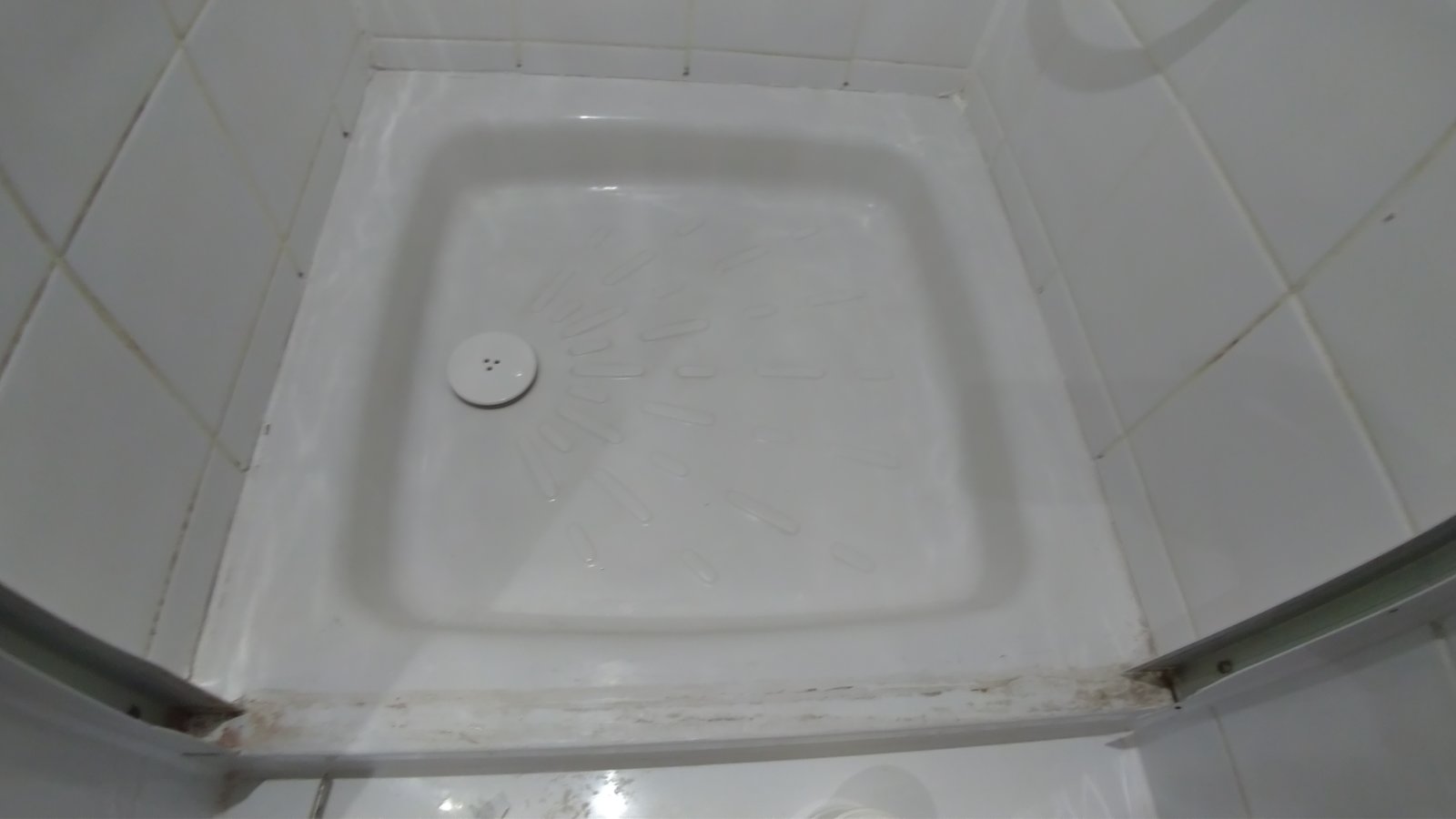

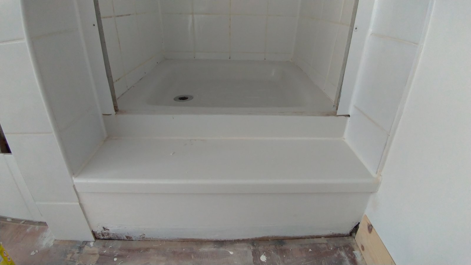

Trying to find a cap for this shower drain bit no idea of make or if available? I assume removing the drain is going to be quite a mission if access needed from below?

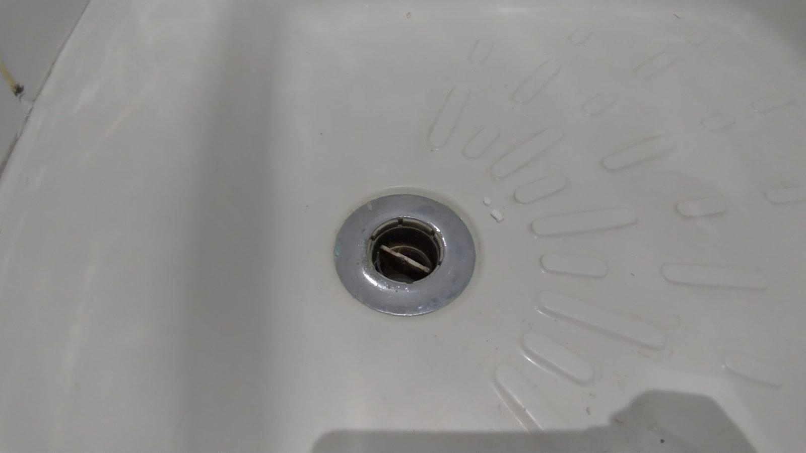

That's accessed from the top - the little plastic bit turns and the sleeve pulls out. Just look up shower traps on t'net and find one that looks like a normal waste i.e a star shape- that fits in your hole there - you'll have to buy the whole lot though. Try "The plumbers mate "online (y)

Thanks, job done
