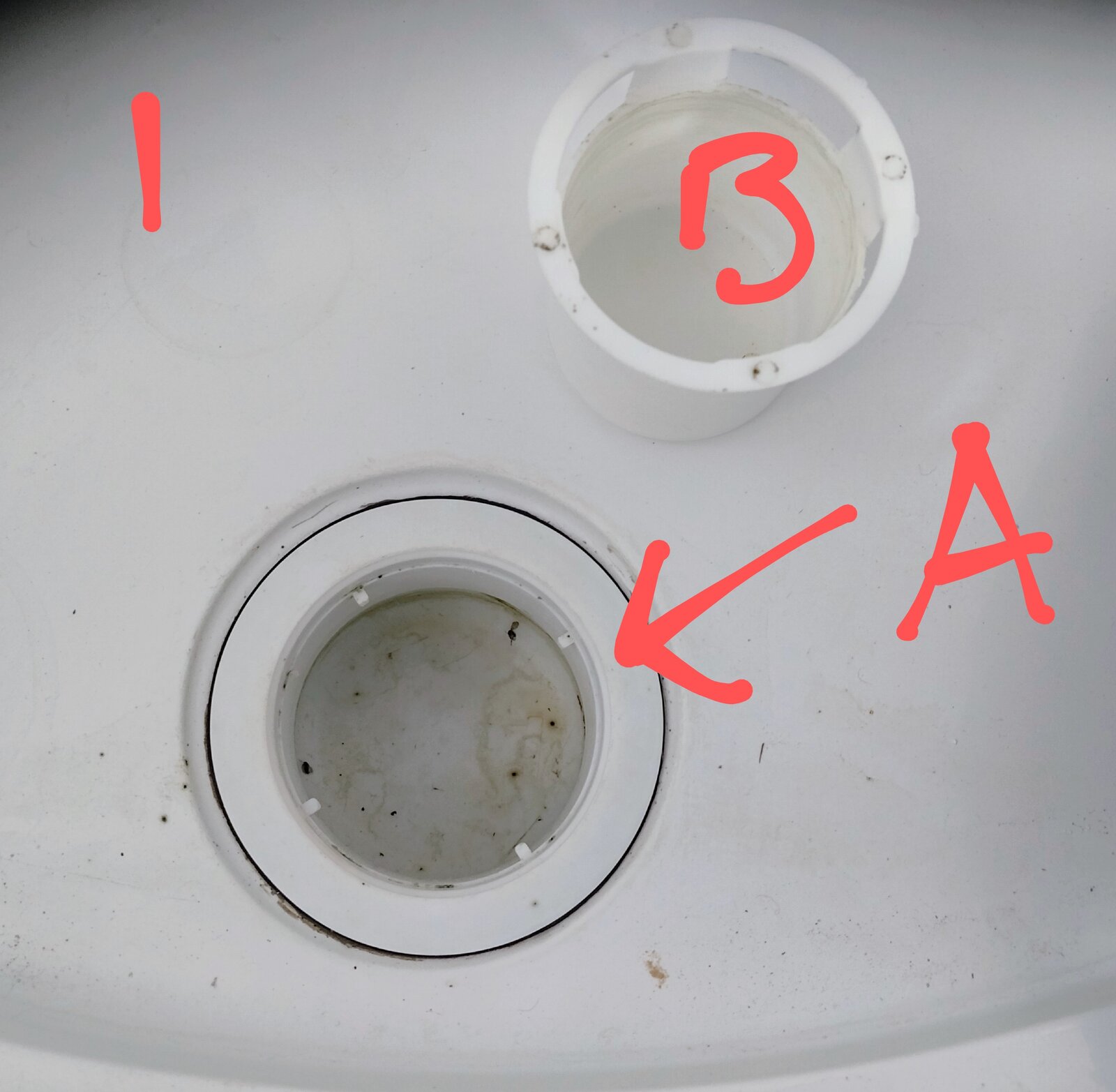

I don't know the brand of the existing shower trap, so I will post pics
Picture 1 is the existing setup i.e. the unknown trap
Can anyone confirm whether the part labelled A is removable by twisting? I have tried twisiting it out but it won't budge.

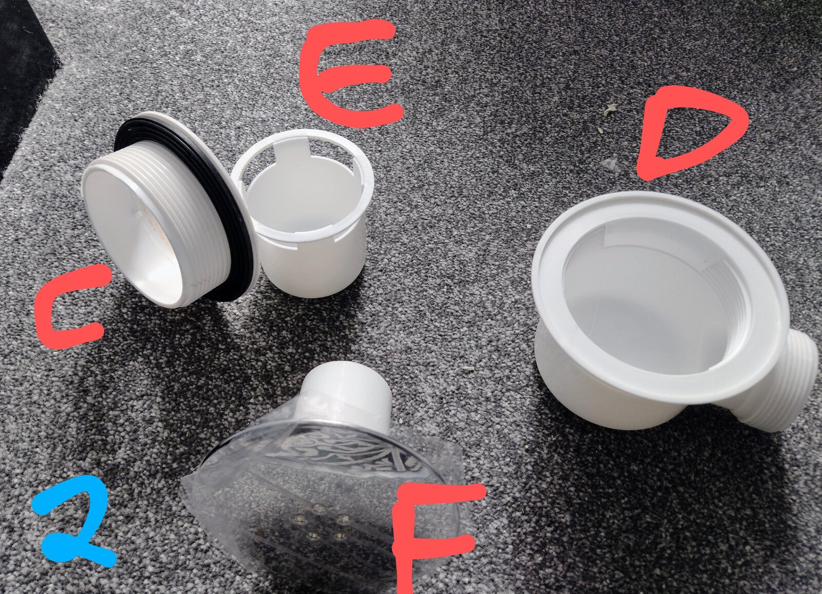

Picture 2 is the new Flopast trap kit that I bought
The drain cap (F) is a few mm bigger than the part A

I thought so, the part i have labelled A should be removable from above the shower tray by twisting.
In the new flopast parts i believe that this part C & D

You are right part C of the new should screw into D of the old thread without any problems.
It just needs something to get a purchase on for a anti- clockwise turn, being a plumber I would cut a piece of 15mm copper tube the diameter of D and place one end over one of those 4 lugs or both this should give you a bit of purchase for a anti-clockwise twist with a pair of pliers.
Even if mastic has been used it won't make much difference to the tightness.

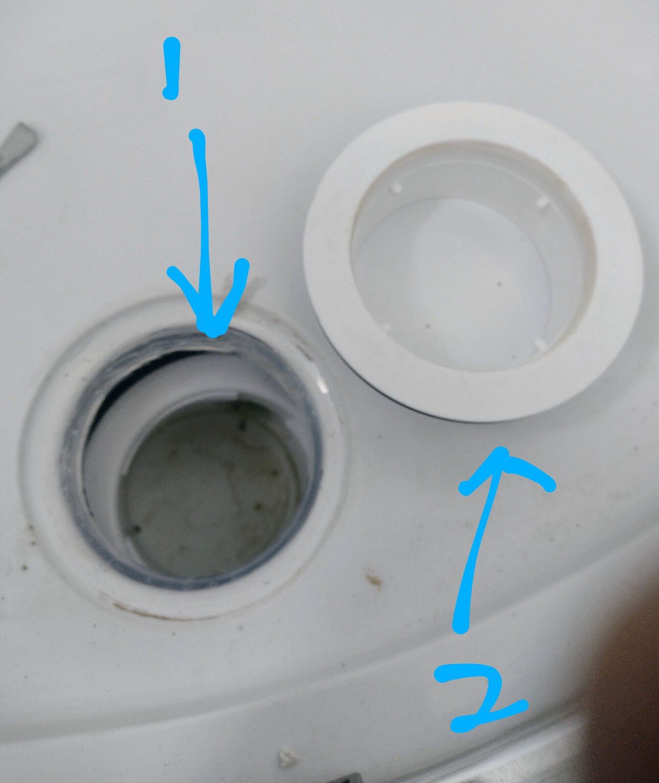

Managed to get the part off by wedging my paint scaper then unscrewing. Thanks @Servotech
Before screwing the new part labelled 2 onto the old, should i remove the old silicone put on part 1 and just hand tighten? Or is it best to apply some fresh silicone?
Also i heard that silicone breaks down over time and causes leaks, so it better to use something like plumbers mate/OB1 or something else?

For what it's worth here's my late reply (Sorry, I've been away)) I'd personally clean off the old silicone the best I could then fit the new one hand tight with no silicone.
On the face of it it seems a dicey job but I've always managed to carry it out successfully.

No worries, thank you for replying.
Yes, I completed the job.
I did exactly as you recommended. Removed the old silicone and hand tightened the new fitting. No leaks, so chuffed :mrgreen:
