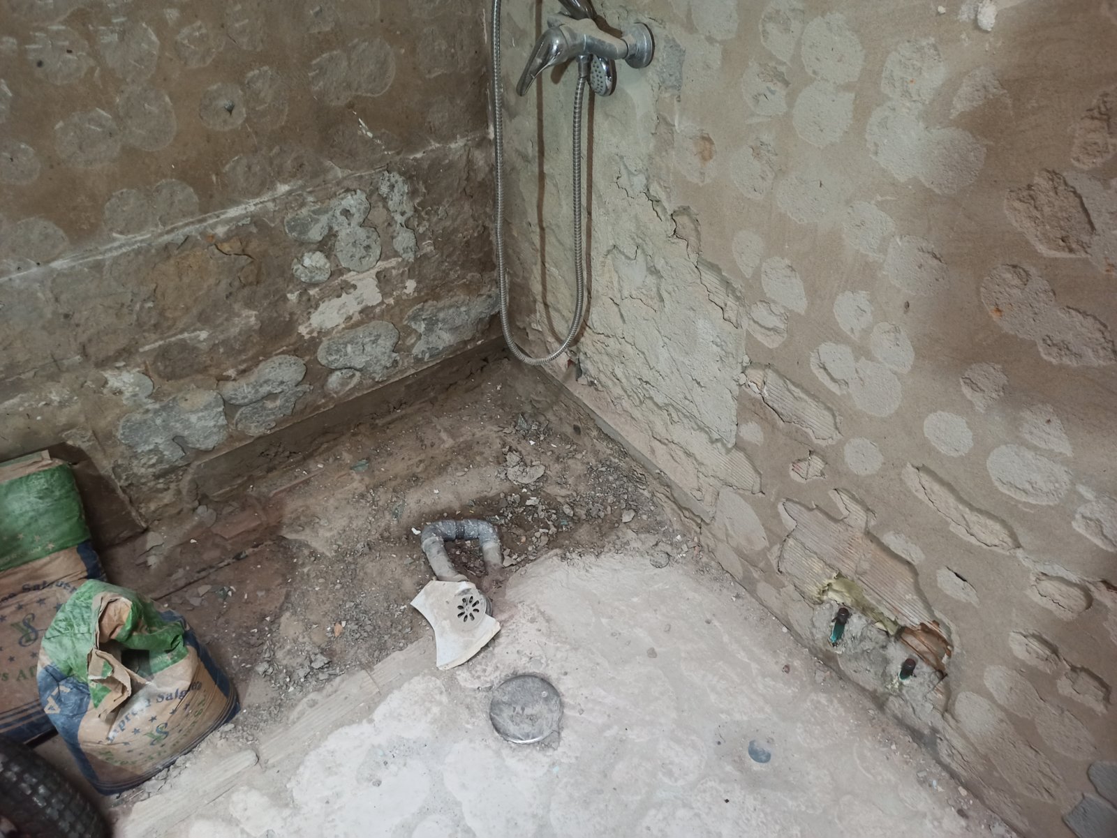

Hi,
Purchased a new shower tray to install in a renovated bathroom. Can anyone give me advice on the best way to install It and the best way to level the surface. I have included a photo of the installation área.
Self leveling compound or make up a loose screed and flatten out the section the tray will be sitting in, keep the waste section open. Once that's completed and fully hardened you can then look to install the tray.
How the tray is bedded will be down to how you want it to sit. On the floor, raised, etc.
