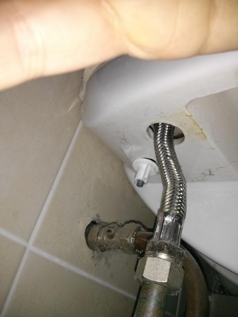

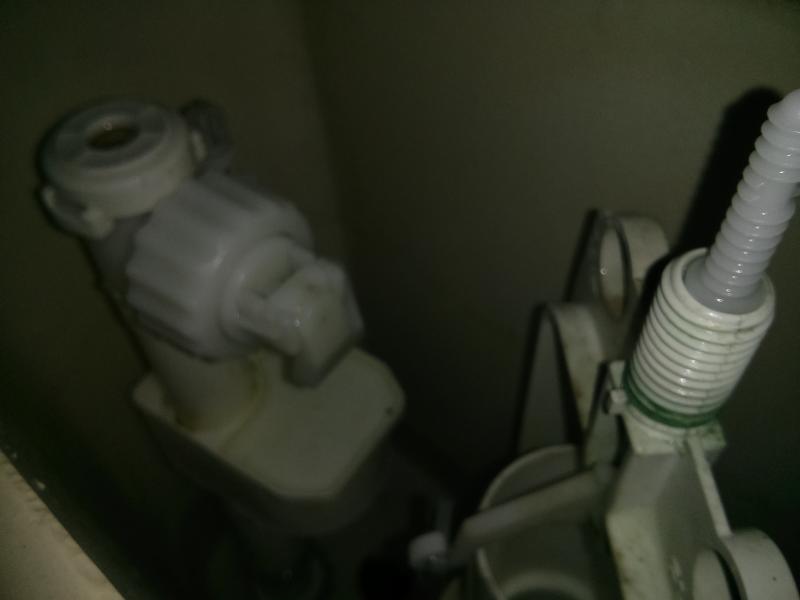

Hi all,
I have a toilet with a Siamp bottom filling valve, as pictured
The toilet had been taking a while to fill, so after seeing many similar problems posted here I replaced the washer (old and new ones pictured).
Bad news is that now the cistern will not fill at all, with either the old or new washer. Anyone got any ideas as for things I should check?
Access to the bottom of the toilet looks a bit tricky, so if I can't fix the current valve what would I need to do to replace the whole mechanism?

Have you checked that the little hole that the float arm seals to stop the valve (pilot hole I think they're called) is clear?
By jove I think he's got it!
Took it all apart again, flushed it under tap and carefully poked a needle at the tiny hole on the back. Couldn't see any obvious blockage, but when I put it back together it seems to work.
Many thanks to all who have provided suggestions.
