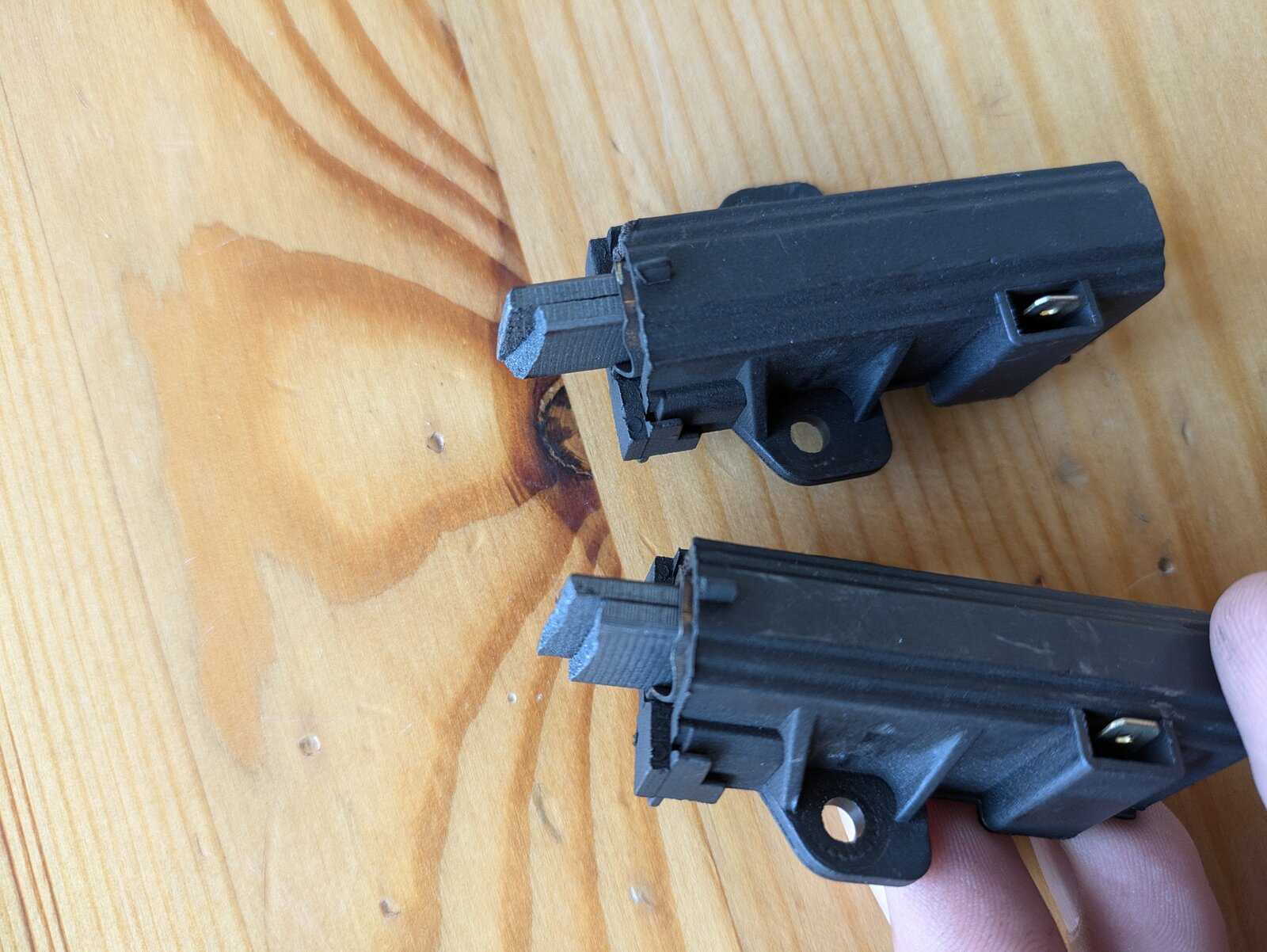

Hi Harry, many thanks for your reply. Looks like the cause of the problem is the carbon brushes. They both came out as broken. Please see the picture. I ordered new ones and will fit them and try when they arrive. Is it normal that the brushes are broken after a while, or does broken brushes point to another problem?
I have never seen anything other than black, carbon brushes, so really I have no idea on that. Normally, brushes simply wear down, until they fail to make proper contact with the comm, and the motor stops working. Sometimes, the carbon released from the brushes, causes a short to the body of the motor, causing the RCD to trip.
Your photo appears to suggest a blue brush, which is a double brush in each brush holder. Perhaps someone else might have come across that type of brush, and could comment?
Many thanks, Harry. I ordered the exact same part with the broken carbons. The brand new ones look like they have longer pieces of carbon brushes. I am considering to have a go installing the new set and running the machine. Meanwhile, if experienced people with broken carbon brushes are around, please let me know what your experience was for diagnosing and sorting out the issue.

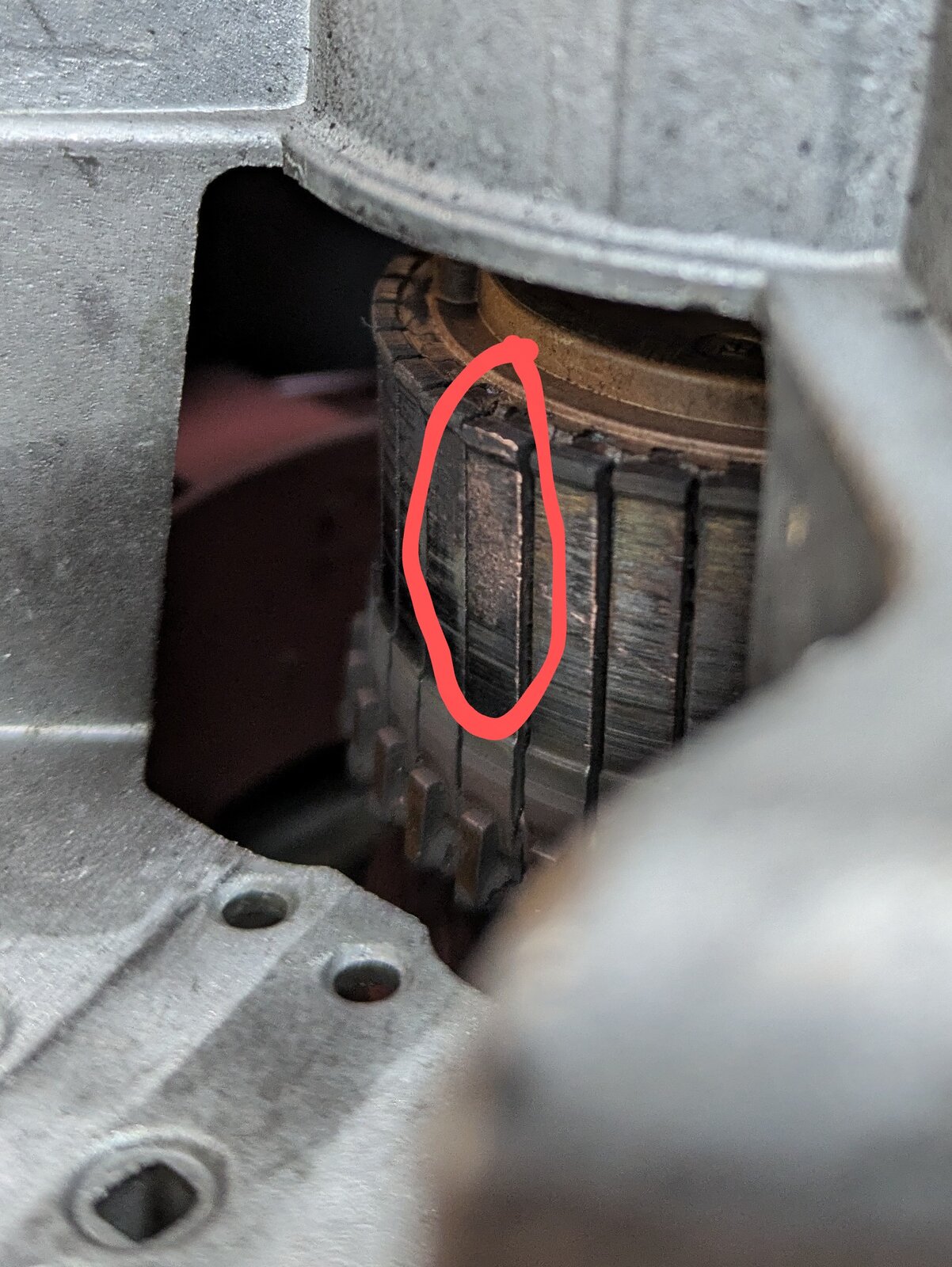

I have just installed the new brushes and wanted to give a slow turn to the motor by hand. It turned fine and silent until it reached to one of the small plates the carbon brushes touch. Please see the picture, it looks like the metal piece came towards outside which explains why the old brushes were broken. In this case, I think my option is to buy a new motor. Please let me know your opinions, thanks in advance!
Those carbon brushes are laminated and have been taken apart by the raised segment of the faulty armature.
