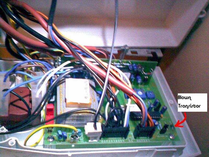

Hello guys,
My combi bolier isn't working correctly and it is only 17 months old.
When I turn the thermostat up, nothing happens. It only seems to work when I manually turn the selector switch summer/winter to "gas flame" position. Even then it runs for approximately 10 minutes and then cuts out. The fault finding indicator flashes bi-colour orange and this seems to indicate insufficent system pressure. However, the pressure is fine - 1.5 to be exact.

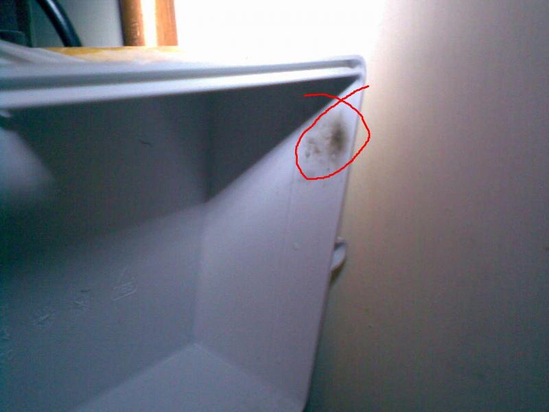

On further inspection, I opened up the front panel to inspect the PCB control board and found some black suity material. It appears that a transistor may have blown. On making a temp circuit to bridge the gap between the transistor points, to test if this is case, the boiler kicks into action.
I have a few questions and hope someone can help.
Have I diagnosed the correct fault?
Do I need to purchase a new PCB board (hope not)?
If I don't need to replace it, can it be soldered?
What caused this to happen to a new boiler?
Cheers,
Big Yin
Doesn't look like a transistor...appears to have only two pins. You sure it's not a fuseable link that's blown or a rectifier. Either way you should not be linking it out.
The cause for failure should be found (ie any faults with the other boiler components) and a new board obtained. You can't just swap the board...ignition and heating pressures need to be set.
Have you contacted Sime or the origional installer? Don't know what the warranty is on these.
For a start thats a two terminal device whereas a transistor is a three terminal device!
Then I thought that a Sime Format C was a non condensing boiler about 10 years old?
Burnt components on a PCB are often as a result of faulty external components.
As you probably want to "save money" by buying and fitting a replacement PCB yourself, just how would you feel if you watched the new one burn up in the first 10 seconds after you powered it?

...it appears that diode had blown rather than a transistor. My mistake.

Tony has warned if there is a short circuit item in the boiler next pcb will be broken also.
So fan pump solenoids motrised head (if one) need their windings checking in respect of insulation resistance to ground and resistance of coil length compared to known normals.
it could be simply a matter of changing the diode. It could not.

Whilst another component on the PCB could have failed and blown, that burnt component it is very likely to be damaged by something else in the boiler at fault.
