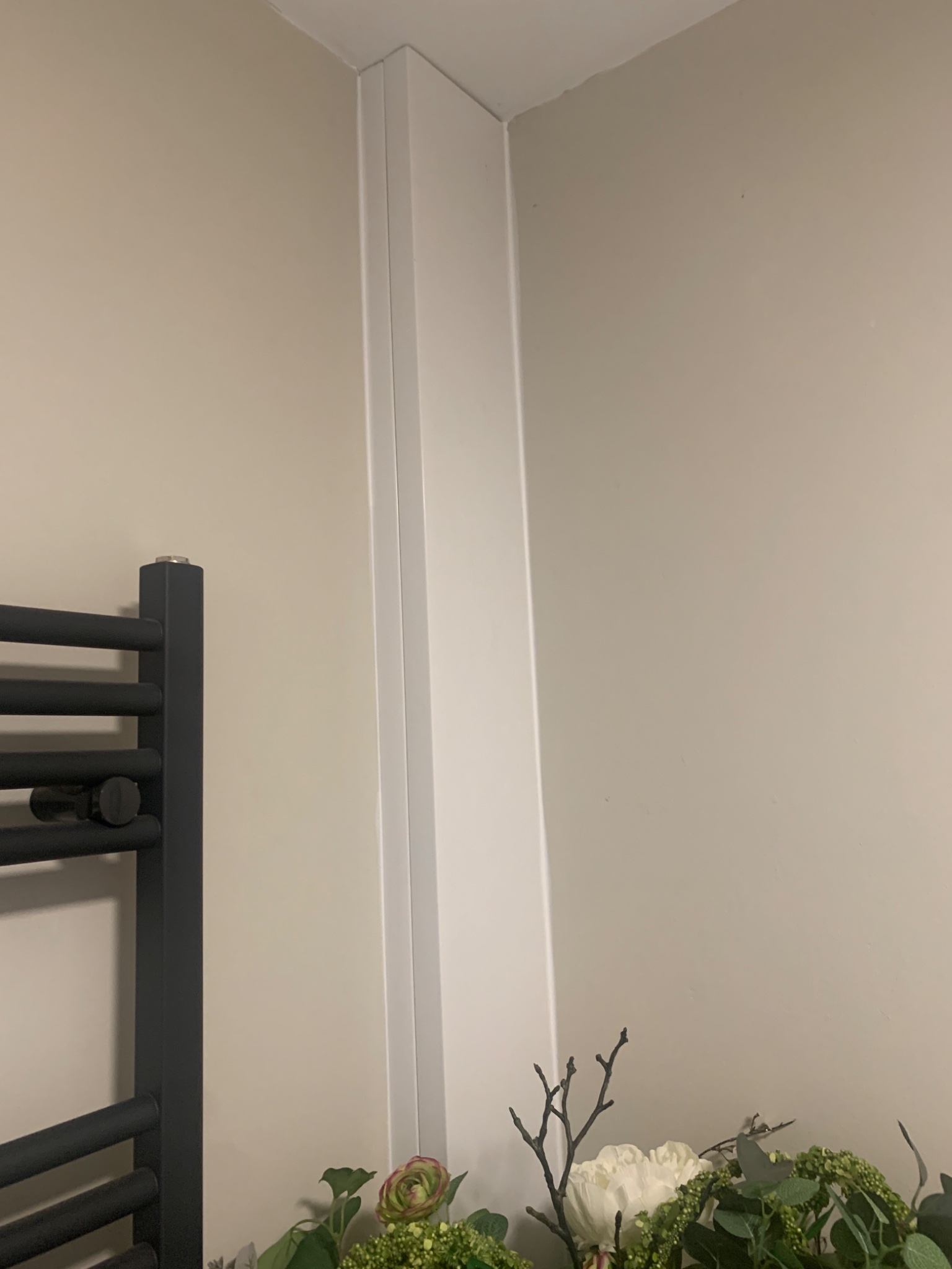

In a building I own, there is large plastic trunking used around the edge of the room to run cables and it also acts as a skirting (picture below). I am struggling to find out what exactly this is called and where to get it, because I want to do the same in my utility room where various pipes run all along the wall. I can find small trunking for 1-2 pipes but want something larger. I'm feeling it maybe has a different name or is sold mainly to the trade - can anyone give me some better google search terms or tell me where you'd buy this sort of thing? Just a simple extruded piece that's sturdy and easy to work with.
Electrical trade centres sell trunking in loads of sizes.
Largest you can stand inside.
Maybe they can help

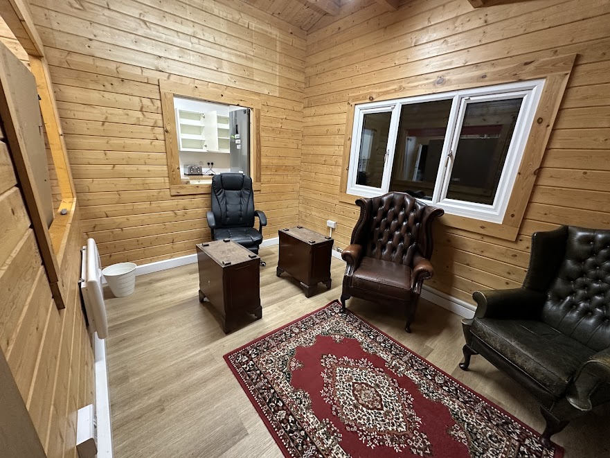

I used Uvpc facia board , probably cheapest option .

Perimeter trunking or dado trunking is what it's called.
