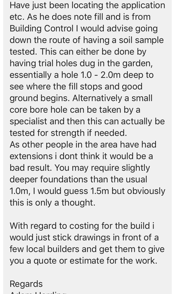

Last architect reply -

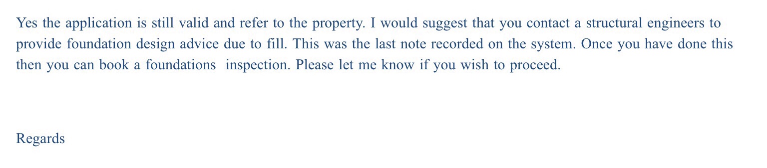

Council email -

since posted this morning managed to speak online to a architect and he has advised getting some soil sampling done.
Looked at my previous emails to the council person and forgot the 1 email I had in return ( I’ve emailed again to ask if they got any more information on record )
But email highlights ‘the fill ‘
1.5m is not much. Part of my foundation trench was almost 2m, just because the ground was so soft the digger kept going until it was solid. You might need deeper foundations than normal just because of the soil type, or because there was water in the ground, but until you dig, you won't know for sure.
But is there some sampling or test works that could be completed to give a indication of what to expect.
I'd probably ask a groundworker to dig a hole and take a look. When my neighbour started their extension I saw that they dug a test trench next to the house, mostly to check the depth of current foundations. Building inspector will want to see the current depth and either match it or go deeper. But, that is only an indication - 4m out from the property (for instance) could be very different.
If you have fill, then its piles or a raft normally. This will increase the overall cost by about £5k to what a normal extension would cost.
Don't forget that you may need the permission of the water company if you are building over/near to their drains. They would be very interested in foundation design on built-up ground. If this applies you need to get this before even starting work, so would need the foundation design details.
Ground core tests will cost a few hundred pounds. You need the testing by a contractor, and then a structural engineer to interpret and report.
