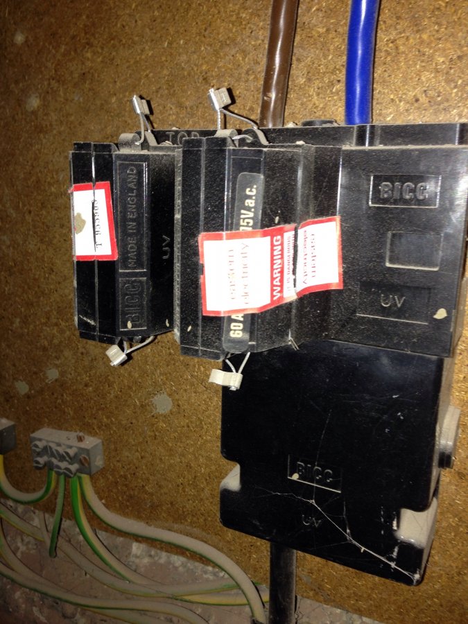

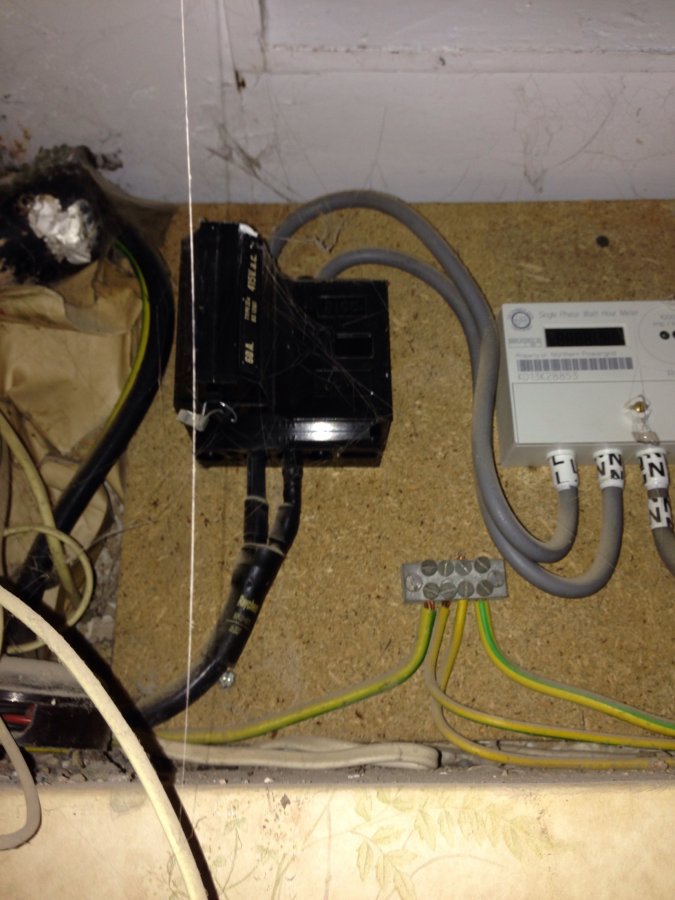

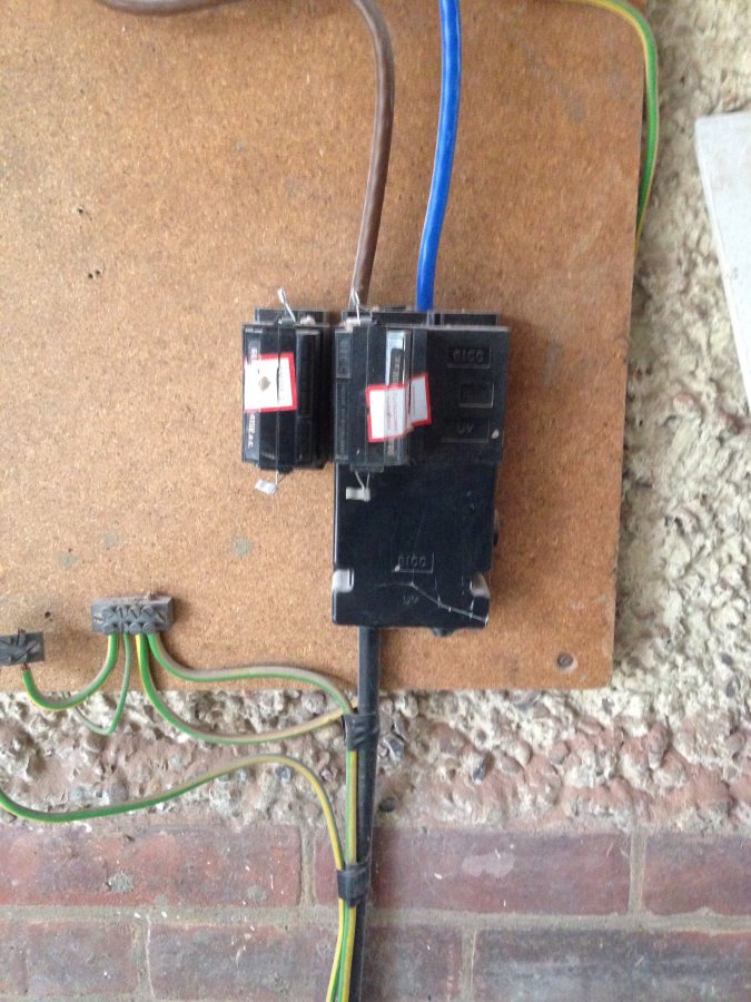

So back to my initial query as I have two supplies in my home at each end of the house. Could someone pls confirm if both of the pics above are two or three phases?
Thx.
Neither - they are both single-phase. Whether the same phase or not is impossible to tell from the photos.
Hopefully in the one on the right there's a N link, not a fuse.

Please explain the above line, I didn't understand that.

A fuse in the neutral feed is not permitted, and is potentially dangerous. One therfore imagines/hopes that there is just a 'lump of metal', rather than a fuse, in the feed to the neutral.
That cut-out is too new to have ever had a fused neutral. I think it's the angle from which the photo was taken which makes it appear that the cables might be emerging from the top of the two fuses. If you looked at it straight on, I think you'd find that the live is connected to the right-hand fuseholder and left-hand one is unused (just tapped off the same single-phase supply). Maybe it was used for a separately metered supply before the second feed cable was installed?
That was never in doubt in my mind. Even with the angle of the photo, I don't think there is any question of anything being connected to the left-hand fuse holder. I thought BAS was suggesting that there might conceivably be a fuse behind that 'BICC'-embossed cover - but it's not even a fuseholder - so, yes, I'm as sure as I can be that the neutral tail simply has a direct connection to the incoming neutral.

Basically when I bought this "project" of a large detached house which needed remodelling, the previous owner did extensive work to the house. Added a side, rear and loft annex extension, so three electrical meters in the house. The pic with two "black hub things on it" fed to meters in the garage (which fed one supply to the loft and the other to the side extension annex) and the "single black hub" thing was on another side of the house and fed the main house.
From your comments above, Im not sure if you're saying this is dangerous or not and whether I should get anything changed? Can I get a free inspection from the DNO? Do you want a better pic to be posted?

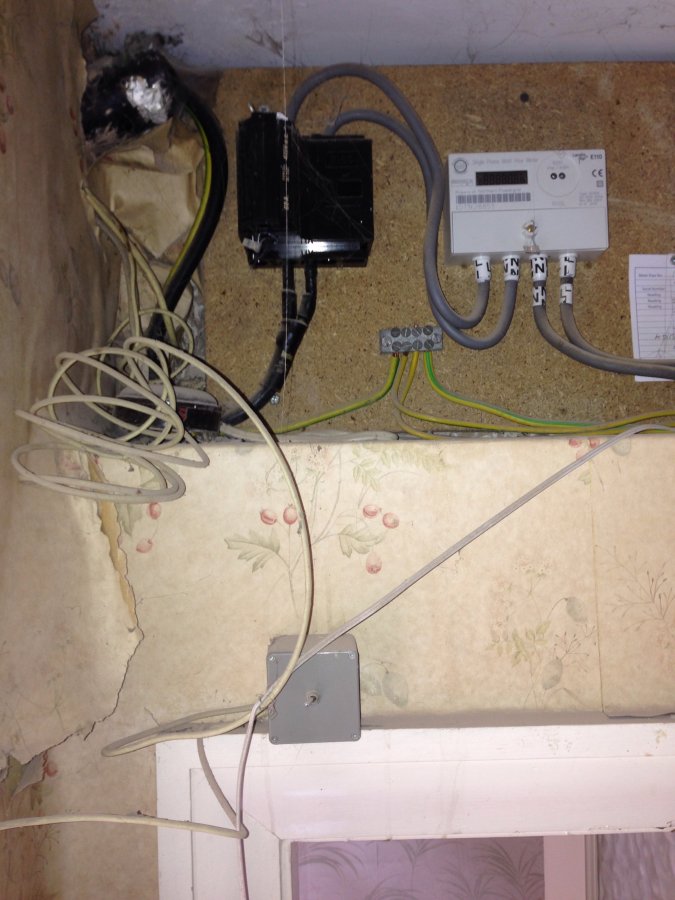

If you're referring to what I said about a neutral fuse, I think that was just a 'throw away comment' about something which almost certainly isn't an issue (or dangerous), so I don't think you should be concerned about that. A 'full frontal' photo (rather than one taken at an angle) of that second one might help us to confirm.
Kind Regards, John
No, it's perfectly fine. Presumably the previous owner had the main house and various annexes as three separate occupancies.
That just confirms what John and I said earlier, that the left-hand fuse is spare and your feed is coming from the right-hand fuse, so all is fine.
I wonder what that box with the toggle switch just above the door frame is for?
Thanks. The spare fuse was only recently made spare after we had one of the additional meters removed by Npower recently.
The grey switch thing, lol, is an antiquated home made front door buzzer (security alarm) built by the previous home owner :)
