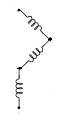

The zigzag config was done a lot at one time, it was common for a generator to have 12 windings, these could be arranged to give 55-0-55, 230, or 380 volt phase to phase.

If you need to work out the loads allowing for power factors, then in the main you are sailing too close to the wind. This 1783533066677.pngIs not ideal, but it does seem to work. The generators actually had 12 coils, allowing 400 volt three-phase, 230 volt single phase and 110 volt centre tapped. And were designed to be configured to give variable outputs.
We expect some imbalance, but to have zero load on two phases is really going too far.
