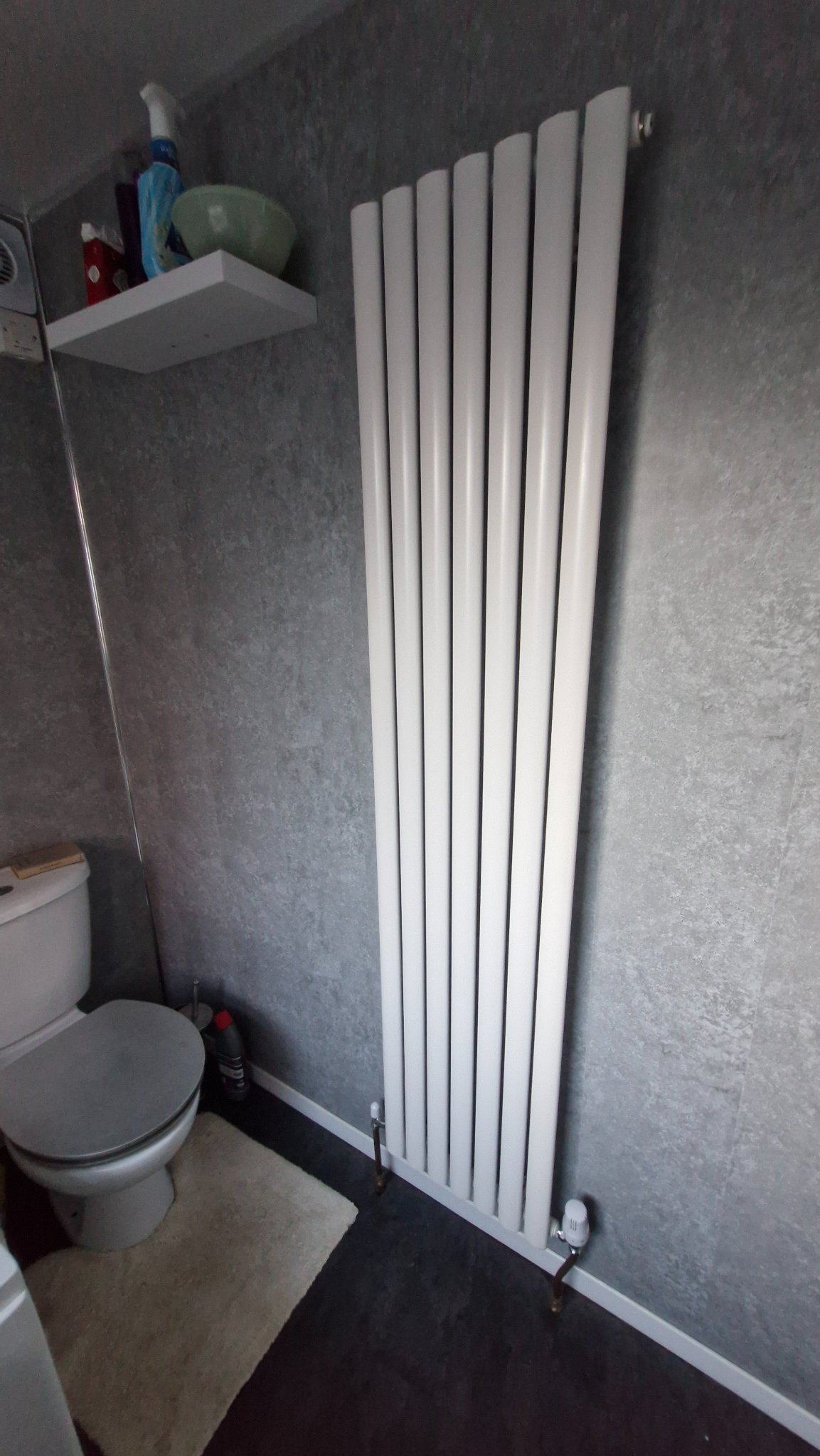

I have a baxi800 boiler. 2 rads upstairs near boiler and 4 downstairs ending up in the bathroom which is the one that only heats up a few panels but both inlet and return pipes are hot.
Pressure 1.25bar.
Radiator - bled ok
Balanced all rads and the others are fine !!
(Balanced as best I can using my new Lazer scanner)
All rads bar the bathroom are old types with just the bleed valve on the top.
The bathroom one (downstairs) has 7 long panels 1.8m high , 400 wide . Flow is from the trv valve on the right to the lockshield valve on left. (I didn't install any of this )
It simply will never fully warm up.
So:
- I turned off all other rads at trv and lockshield. Exactly the same issue with just bathroom one on.
- TRV valve is not stuck
- both valves seem to work fine
I thus assumed it was gunged up. With the help on here I removed rad, flushed fully , zero gunge just clear water. Put back on , re pressurised and exactly the same issue (it might be slightly better)
(I did when rad off turn on valves to see if water was restricted .. it came out no issues)
So:
Where do I go next ?
I think the rad is far to big for the small bathroom. It's as if it holds too much water to heavy up quick ? The one in the hall next to it heats up instantly, this being just a 500×800 old one.
I actually want a cheap towel warmer far shorter one. I almost feel that simply buying a smaller one will fix it.
What's think ?

1. Many of those vertical radiators are sensitive to which end is flow into the radiator and which is return out of the radiator.
2. This type generall have a baffle on the flow side which direct the water up the columns. Without this, water tends to flow straight across and not heat the radiator uniformly.
3. If there is not indication (perhaps on the back?) of required flow direction, you could try taking it off the wall and turning what is now the back to the front.
4. If it is too big for the bathroom, you can always turn it down on the lock shield valve.

Those tubular designer radiators are usually crap, not worth the money unless they are really only there to heat a small room. So in this case a bathroom is probably the best place for it, though I would say it's a bit on the large side. With these designers rads the flow into the rad is usually on the left hand side. Going from cold which pipe heats up first left or right?
Would be much better off with a ladder towel rad of the same height and anything but chrome. Or for the best heat, a normal convecting type rad

Usually the vertical rads have the INLET on the left hand side
So if your flow is coming in on the right (right valve getting hot first from cold) my suspicions are it will be piped up the wrong way around causing the baffle inside to not circulate correctly , swap flow and returns around under floor should cure it if it’s get good circulation from both sides

I’m an heating engineer and I always try and sway people away from wanting these kind of radiators due to these issues, you can not go wrong with just a standard white radiator convector from places like Screwfix - or them towel rails are cheap enough to buy - and will work regardless of direction of flow - get it out it looks way oversized for the room anyway, best of luck

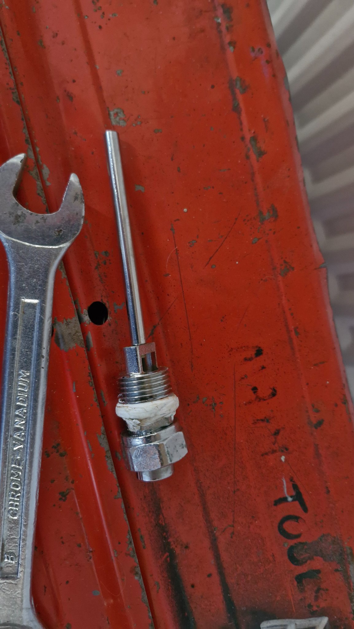

Thought I'd post the result.
Fix: I bought a 400×600 rad from Screwfix and new valves for the rad tails. (Tails don't come with rad). I probably could have used the old ones but didn't want to take any chances.
- Drained old radiator, removed, new wall brackets in (found this hard ), new rad in , added inhibitor, re pressurised.
Result - new rad heats up quick and no cold spots. A minimal 1200btu rad which works fine in bathroom.
So all good But I have one question:
The old red couldn't function because the pipework was the wrong way round for it being a designer radiator required in the flow on one side ..... I couldn't turn the radiator around either.
When I took it to bits just to see what the tails were like I noticed on one side is like in the picture ? I also know that on these designer radiators the flow side is important as it has baffles or something ?
The picture is off the tail of one of the sides in the radiator and I wondered as it is so odd if this could just be swapped around and it would have worked ? What is it is it the baffle ?
Doubt it, that is just to inject the hot water further into the rad and would probably work on the flow or return.
