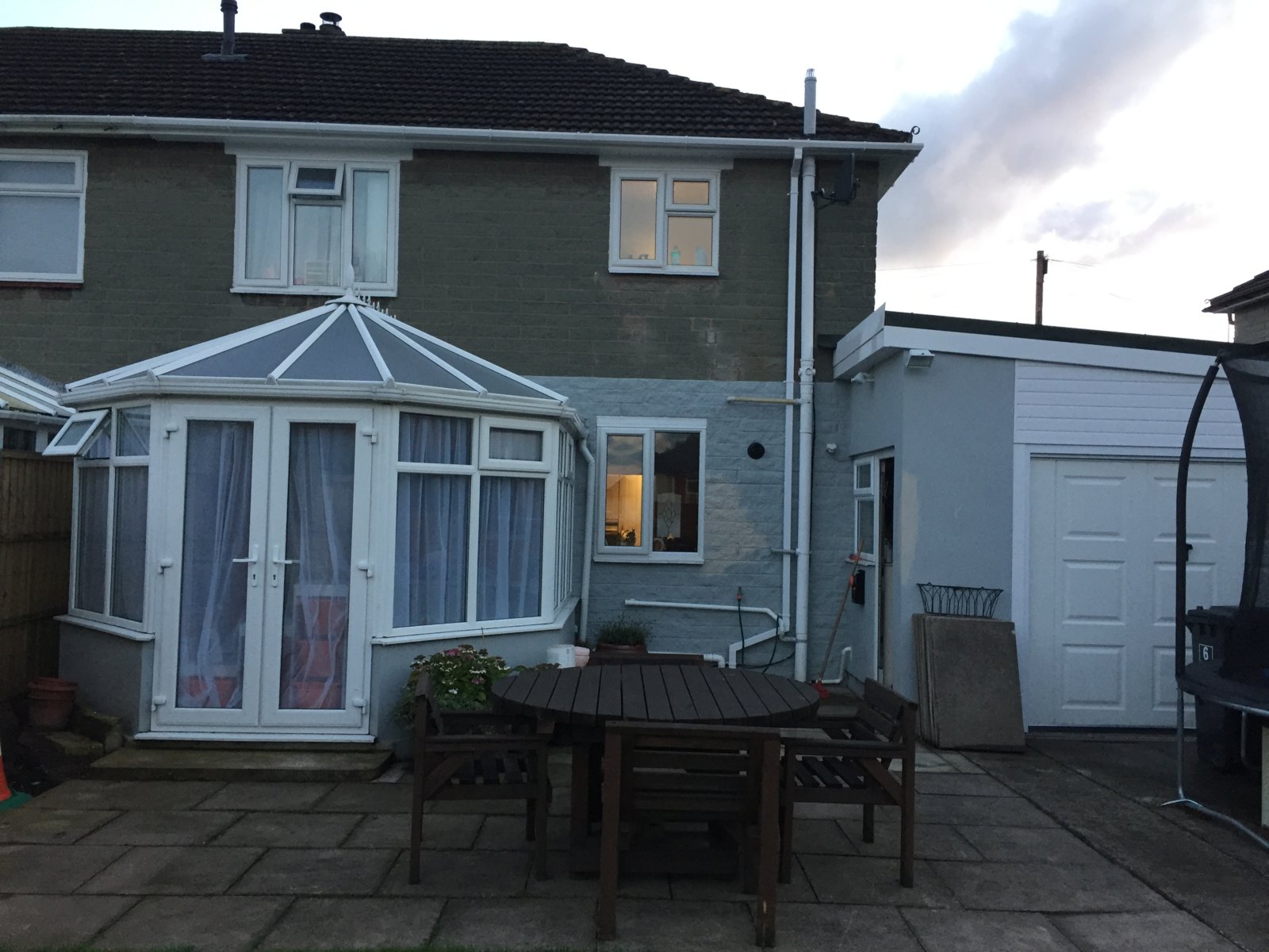

Planning on removing a conservatory and replacing with a single storey extension pitch roof, looking at the picture below can anyone see a problem leaving the existing soil pipe in position (manhole is in the garage )
Boiler flue is the biggest problem I can see
Also planning on getting to slab level myself
Can anyone advise or show me a sketch of
How deep to dig footing ?
How deep yeh concrete footing ?
How many concrete blocks to slab ?
Insulation thickness and slab thickness ?
Also the 3 mtr rule without planning is that an internal measurement or external overall ? I want to go out as far as possible

A few things to think about....
Work out where the foul drainage runs go, if you want to build over or within 3metres of a public sewer you need a build over agreement.
You need to find a solution to the flue, you maybe be able to bend upwards but flues have very specific rules and are also dependant on boiler model.
An extension needs building regs.
3metres is external.
Foundation depth, well around 1 metre from ground level, but dependant on soil, trees, drain invert level and depth is decided by building inspector.
It looks like a pitched would look shallow judging by the first floor window. Have you thought about a flat roof with a lantern, ie orangery?
Sewer is not a problem as we are end of the run and is all to the right in garage
When you say a meter down that’s the depth I would dig too approx ?
Pitch roof may reduce the bedroom window height so won’t be a problem
Do I need building regs regardless as so no way around it as my neighbour said he only got them as building over a sewer run ? I assume soil pipe can stay and just run up through a lead sleeve in roof ?

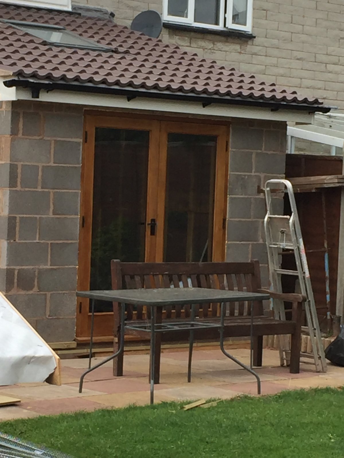

Neighbour has recently done this with a pitch on building regs
