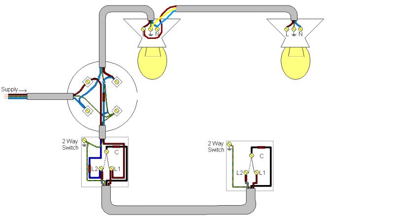

A bit of advice would be appreciated for the following.
I have an existing hallway light that I want to add another ceiling rose/light to and add another switch to the circuit so that I end up with 2 lights and 2 switches (both being 2 way).
1. How should the existing switch be wired when changed with the new 2 way switch? Currently it has old red (live) coming in on switched side and black (neutral) on return when switched on.
2. How should the other (new) 2 way switch be wired?
3. How should the two lights (old and new) be wired together and how should the cable be picked up from the existing circuit? I assume the extended circuit cable (from new light fitting) will extend to the new 2 way switch?
4. Any advice would be appreciated.
Do you have junction boxes, ceiling roses or terminal blocks in the light switch backbox?
You'll need:
2x 1-gang 2-way switches, a length of 3-core and earth cable sufficient in length to span between the 2 switches, some twin and earth sufficient in length to span between the existing light fixture and the location of the new fitting, some 5/6A terminal blocks, some green&yellow 3mm sleeving and some brown 3mm sleeving.
If you have junction boxes then this should explain things:
Install the new light fitting and using twin and earth cable wire the new light to the old:
Then run 3-core and earth between the 2 switch locations and wire as shown:
At switch location the brown conductor is going to be red in your case, and the blue conductor with a brown sleeve will be the black conductor which you should sleeve with a bit of brown sleeving.
P.S Are you aware of safe isolation procedures, safe zones and testing?
I wish I had the patience to draw such decent images, but I only scribbled on the wobbly lines at the top :LOL: The rest was nicked from the wiki.
