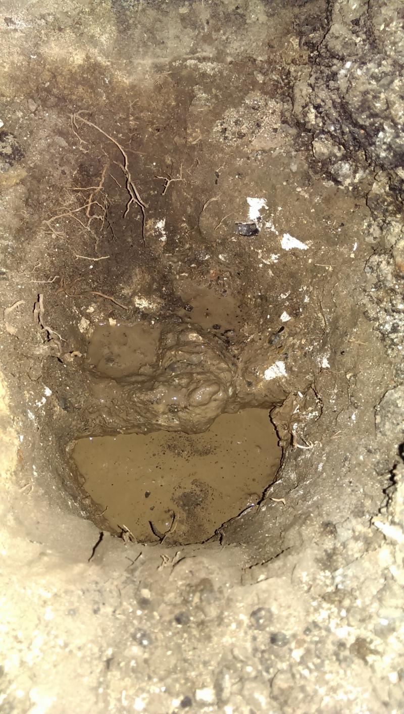

Slightly odd one... I have recently had my house externally insulated and the gates that were fixed to wooden posts screwed to the walls were removed.
I'm not inclined to fix them back to the now insulated walls - want to keep the number of holes in the new skin as small as possible, so have started digging a hole to sink a post into the ground.
Have come across what I think is just a big lump of flint (see pics), but not being particularly knowledgeable about foundations and etc was slightly nervous about breaking this out in case it caused any issues.
I have dug underneath it and it seems there is nothing there.
Am I ok to smash this up and pull it out?
BTW the water in the hole is just where I tried to clean the muck off the stone to get a better look.
Ta,
Ben
2nd pic looks a bit like a pipe with an elbow, I would dig around it a bit more to see what's what. Get the water out if you can as it would make it clearer. Do you have a magnet/metal detector (eg a stud wall scanner)
Yeah, I thought the same (that it looked like a pipe). Digging behind it (close to the wall) is really hard. It's almost like the stone (or whatever it is) is connected to the wall with concrete, which is why I was questioning re. foundations.
I am pretty sure it's flint... in one or two places where I've had a go with a chisel bits have knocked off and you can see the dark flint stone inside (very flinty around here).
It's about a foot down.
Have got one of those detector jobbies, will poke it down there and see if it goes off. It's a 1930s house so I imagine any pipework would be lead.
I have had another look today and also smashed a bit off with a lump hammer. Its concrete.... And it seems to be connected to the wall.
Underneath its just soil.
Anybody have any opinions on whether I can break this out? Don't wanna go disturbing anything to do with the foundations.
Ta
Unless you are digging under the wall, removing the size of a post and refilling with concrete to hold it is probably unlikely to cause issues but them I'm no expert. There is still the chance that it could be something like a pipe embedded in concrete or similar. Is there anything like a cover in line with when it comes from or anything on the other side of the wall that could use it?

It's digging out that bit of concrete to sink the post into the ground he's worried about not screwing into the wall.
The water main stopcock on the drive is in-line with it.
I think what it could be is overspill from when the foundations were poured. Just the top of the trench if you know what I mean.
I might just play it safe and move the whole gate 20cm further away from the wall and avoid any problems.
