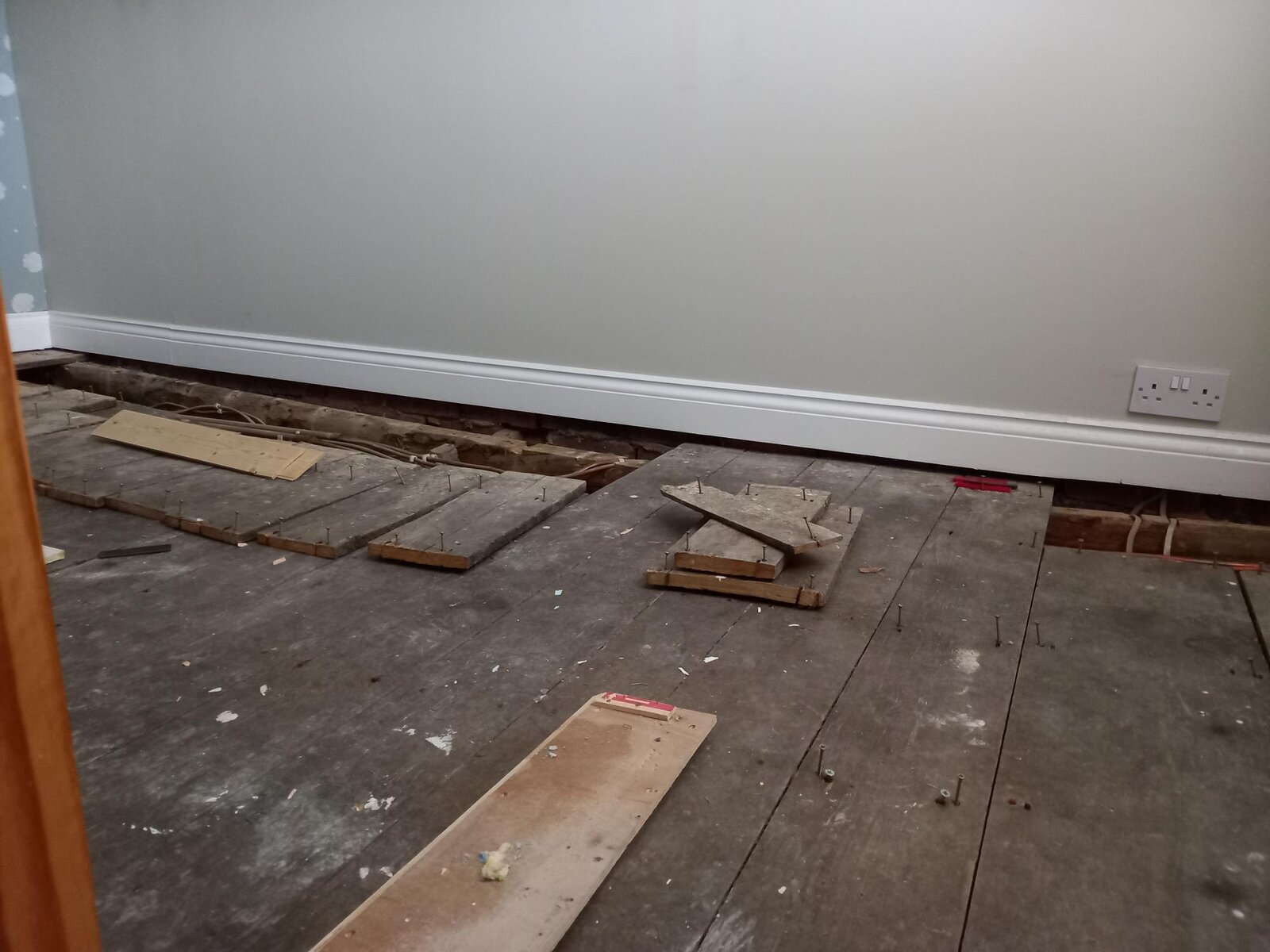

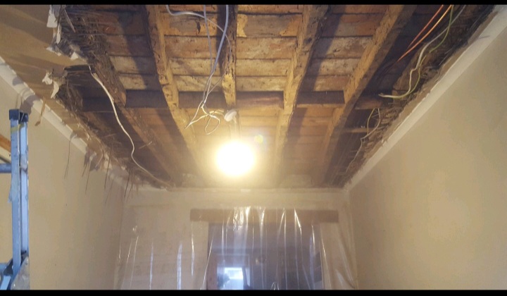

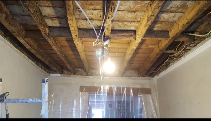

My bedroom floor is sagging in the middle the house was built just before the 1800.
I was thinking about just sistering but as you can see from the photos the joists aren't straight so wont sit flush.
This will be done from above rather than below as these are old photos and the celling has been repaired so don't really want to disturb it.
I was thinking about getting some 4x2 timber to sister and use M12 coach bolts with screws as well

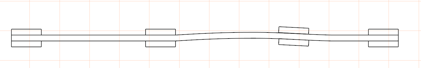

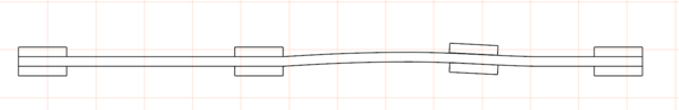

I'd bolt the sister joists at either end and then pack at points along the length and coach bolt together through the packers. I wouldn't try and straighten the bowed joists.
I understand, just had one of those moments. I think that will be the best way.

No, the sister joists needto be the same length as the originals and be continuous without any joins, unless you sister on both sides. If you sister on both sides you can have joins, as long as the joins are offset.
Packers should be solid timber, same height as the joists, as long as you can make them, just cut to the correct thickness.

You're going to struggle a bit with that and getting any "sistering" effect if they're not clamped tightly together. Obviously when you remove the floor boards they would pull together but that would ruin your ceiling. I'd just leave those old things for the ceiling and drop some new ones on masonry hangars. I don't know what depth you have but something like 7x3 may be needed.
No need to sister, sistering only really required if you are trying to repair existing joists or do not want to put new wall supports in, putting joists by the side or even in the middle of the existing spacing will double the strength of floor supports
Its all going to be replaced with new joists, better to do it right.
