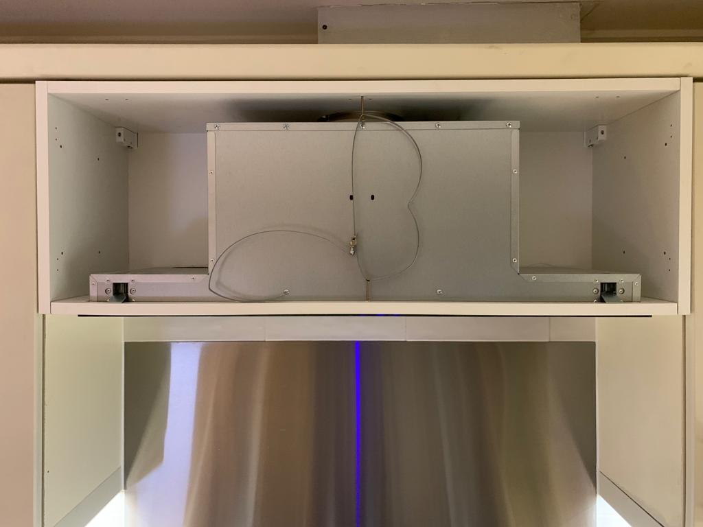

Hi all
Made some kitchen updates and have just put in a 100cm W x 36cm H bridging unit
Will be ordering a matching top hung door and was wondering what size would be recommended
Is it the exact measurements as above, or should it be a few mm smaller?
Many Thanks
Lay on doors look better, so same size. Oversize it if you want to trim down.
Blup
Kitchen doors are typically 4mm short of cupboard dimension to prevent binding .
If you order a door that is described as 1000mm width, you will find it is a little less.
Have a look at some of your existing doors, and their cabinets.
