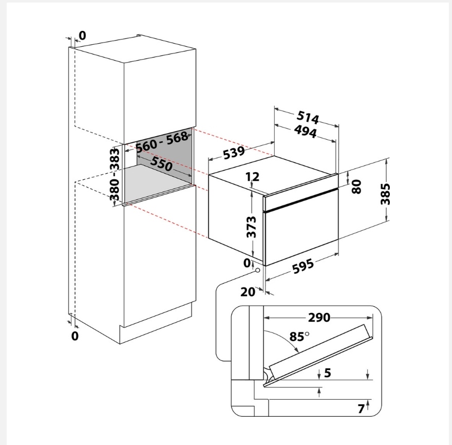

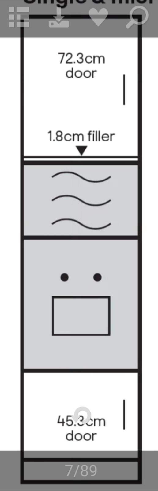

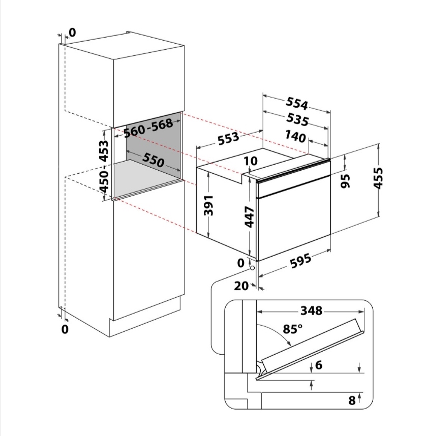

Hi all. I am about to have my new kitchen installed but am a bit confused by integrated microwave sizes.
The unit is a tall (2340 mm) oven and appliance housing.
So is it simply a matter of overall size - the legs (150 mm) which leaves 2190 mm.
Then take off the doors and the oven 2190-723-453-590 which leaves 424 mm
So is the niche size for my microwave 424 mm? I have seen some which are 380 tall and others which are 450 tall. Do they just use fillers if too small and is it simply a matter of getting a smaller door if I need a larger niche?
I've attached a pic of the housing and the 2 microwave dimensions.
Thanks all

They also do a door which is 687 tall. If I went for the larger microwave could I just swap that for the 723 door?
I have a combi microwave at eye level, which is pretty big, and I think I am unlikely to want to change it for anything smaller.
For the convenience of door sizes, it has a small gap above it, and a filler piece. Above it is a crockery cabinet. In your position I think I would design for the biggest appliance you might want in future, and use a filler to hide the gap.
I am lucky enough to have a lot of matching oddments, so I could change mine for a different-size filler if I wanted. I suppose you could use matching cornice or something if you were not so lucky.

Thanks for your response. Are my calculations correct? If I went for the 687 door with 450- 453 left for the microwave that should fit with about 7-10 mm left to fill? Am I leaving anything out?
7-10mm is not worth bothering with a filler, IMO. You will need a bit of slack to push the appliance in and out.
So should be a perfect fit if my calculations are correct? Sorry, just trying to get my head around it all.
I just checked mine, appliance height is 350mm incl feet; aperture looks like 420mm to the top of the filler, I have a 50mm filler with a bit of a gap visible but looks OK. The filler has a bit of gap to the door above.
maybe 420mm or 424mm is standard height for a microwave aperture? Not sure where the 18mm shelf above and below use up the height so it might be 400mm actual. I have a bit of trim below the microwave hiding the front of its shelf.

I think it is, but the microwave I want requires 450 mm. Is it just a matter of getting the smaller door to give the extra 30mm? Does it work like that?
Thanks for your help
Built in microwave often comes with a surround designed for 60cm wide unit and top and bottom are sorted with suitable sized infill panels.
