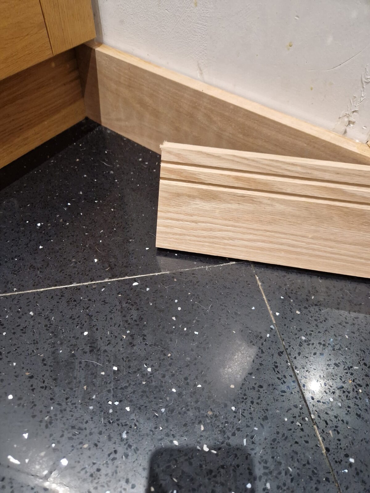

had skirting board removed and replaced with solid oak very expensive builder put on back to front is there a way it can be routed with groove while in place ?I'm new to this site just wanted some advice thanks
Photo as fitted vs side with groove.
Find out how it was stuck on.
That's going to have to come off. Cleaned and put back on. Or at least try and do that
my thoughts iff they used no nails it may stain the surface badly
have you got a couple off offcuts and the adhesive used ??if so blob on the front off one and the back off the other incase treated different
v groove could be done but starting and finnishing perhaps 45mm short
unless the router fence is shallower than the board is thick it will be a tripple nightmare other than just a double nightmare as it is
the grooves are likly to be a bit furry and discoloured as you are removing any finnish and iff the wood has been about for a bit off time the new wood colour will further add to the tone difference
Nah, the skirting needs to be removed. You could try using a mini router, but it won't be able to reach the far edges of the skiriting.
I would however take advantage of the removal to prep and paint the wall first and to oil/varnish the skirting.
I guess that the fellow put it on both back to front and upside down.
