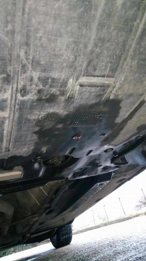

Hi Folks,
My Skoda Yeti 1.6 Greenline 2012 has a coolant leak.
I have probably put 2 Litres of coolant into her since Christmas Eve.
It was due a service in any case, so I decided to go ahead, change the oil and filter and see if I could spot the problem along the way.A mechanic is going to fix this for me in anycase, but I hate to bring a car to any mechanic with out an idea of the problem I am dealing with.
After I put the Yeti up on the ramp, it was clear there was a lot of fluid sitting on the engine's underside cover.

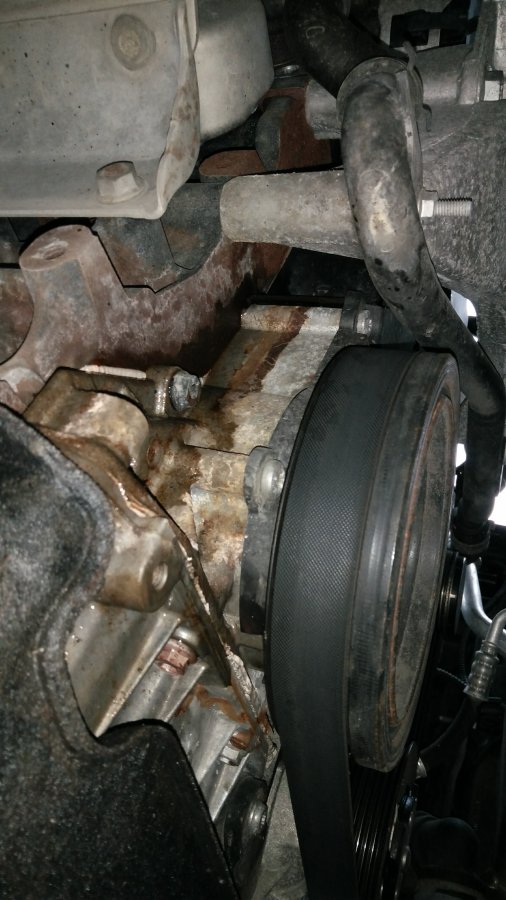

The lining on the sump was saturated with coolant. The coolant is dripping down the slide of the engine block behind, what I think is the timing belt. I could see roughly where it was coming from but not source, this is a pretty decent photo of it.
So it doesn't appear to be a loose pipe or radiator, could anyone throw more light on the problem for me.
Ray K
Sure can, Ray.....the water pump is driven by the timing belt, and it will be leaking along its shaft. These pumps are good for 100k miles but must be renewed with the timing belt.

Confirmed what I expected - I heard that might be the problem, should I have got a new belt at 100k?
Ray K
For sure, that's how long the belt is designed to last.....personally I think its stretching it a bit (pun intended!) and prefer to play safe around the 80k mark.
Included with the belt kit should be a water pump, tensioner and guide pulley. Replace the alternator belt at the same time.
