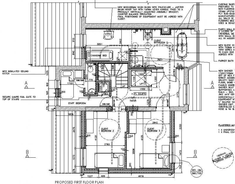

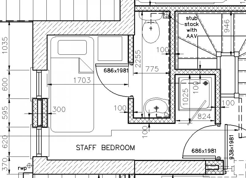

I have produced the working drawings for a very similar scheme to those that you describe, unfortunately (for you) I do not believe there are any regulations requiring minimum standards for the live-in staff. The fully registered charity that I produced this scheme for (which is now built and received full approval by Building Control and the body responsible for the standards of care home accommodation, I can't remember their name: I guess this was the CQC you mentioned) had an identical ethos to the one you are employed by yourself in that all funds were directed towards the clients and not the staff. The images beneath show the overall first floor plan and a close-up of the staff bedroom. In reality once on site and the radiator was installed beneath the windows there was even less room between the bed and the toilet and the door became a bi-fold door (and they were tiny doors to start with). To be fair though, the staff were not expected to carry out admin in the bedroom but had a (tiny) dedicated worktop just off the kitchen on the ground floor.
surely the fact that a fire escape must must be easily opened and left clear off obsticles comes into play
Fire regs can be a bit grey on these types of project, we also had automatic doors on the bedroom doors and ceiling hoist track passing through the bedroom (fire) doors! The staff member sleeping over also (technically) had a responsibility to ensure the 'clients' were safe so staying in their room wasn't really an option unless the flames were licking their bedroom door.
