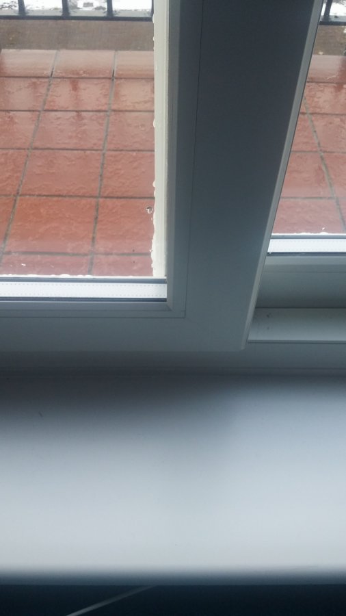

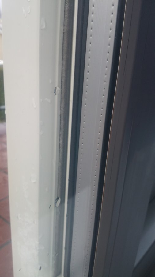

Hope someone could offer some advice please. We've had a new sliding patio door installed but there is a draught getting in down the middle of the door (where the two doors meet).
I don't know much about these things but I don't think the moving door is coming over far enough to properly interlock with the stationary door. You can clearly see the brushes on the outside door and they only come up against the side of the moving door - they don't properly overlap with it.
The installer came out to have a look and said it's interlocking fine but surely the brushes need to overlap the other door to create a proper seal? As it stands, the brushes are pretty much out in the open and you can see them getting soaked with the rain. Should the brushes really be hidden from view?
I'm not sure if the frame of the unit is just a touch too small as the door can't move any further. When you look directly down the middle, you can see about a cm of the left hand side of the outside strip - does that seem too much? I wouldn't expect them to align perfectly but would expect there to be less of the outside door visible. Any advice would be greatly appreciated! Thank you.

Thanks a lot for the fast reply, I've attached a couple of pictures :)

The patio-door repairman, who I asked to adjust them, diagnosed that the builders opening had been too tight, so the doors were too big to fit. It could also happen if either of the sides was bowed or out of vertical. Try it with a long sprit level.
He got me a new glass unit, about half an inch smaller, and cut a bit off the components of the door so it fitted. It is now draught free, more soundproof, and I don't get dust and dirt collecting inside.

Yeah that looks a mess really. I can't see its meant to be like that at all. Like John says I doubt its an easy fix if it even can be fixed without a new door of the correct size.

You can't fit an 1800mm patio frame into a 1780mm opening, also as it looks like a patiomaster or similar brand then the frame is probably welded as opposed to machanically joined at the corners, tis means you cant reduce the frame on site as it'll need to be cut at the corners and re-welded in the factory.
It's a possibility that during installation the fixed sash has not been screwed tight enough to the frame which would mean it is using up more than half of the opening.

yours may be different, but mine had a definite interlock where the two panes came together.
Think of two "U"s on their sides, open ends facing each other, with a slight overlap. And the brush or fur pile on one should lightly press on the frame of the other.
