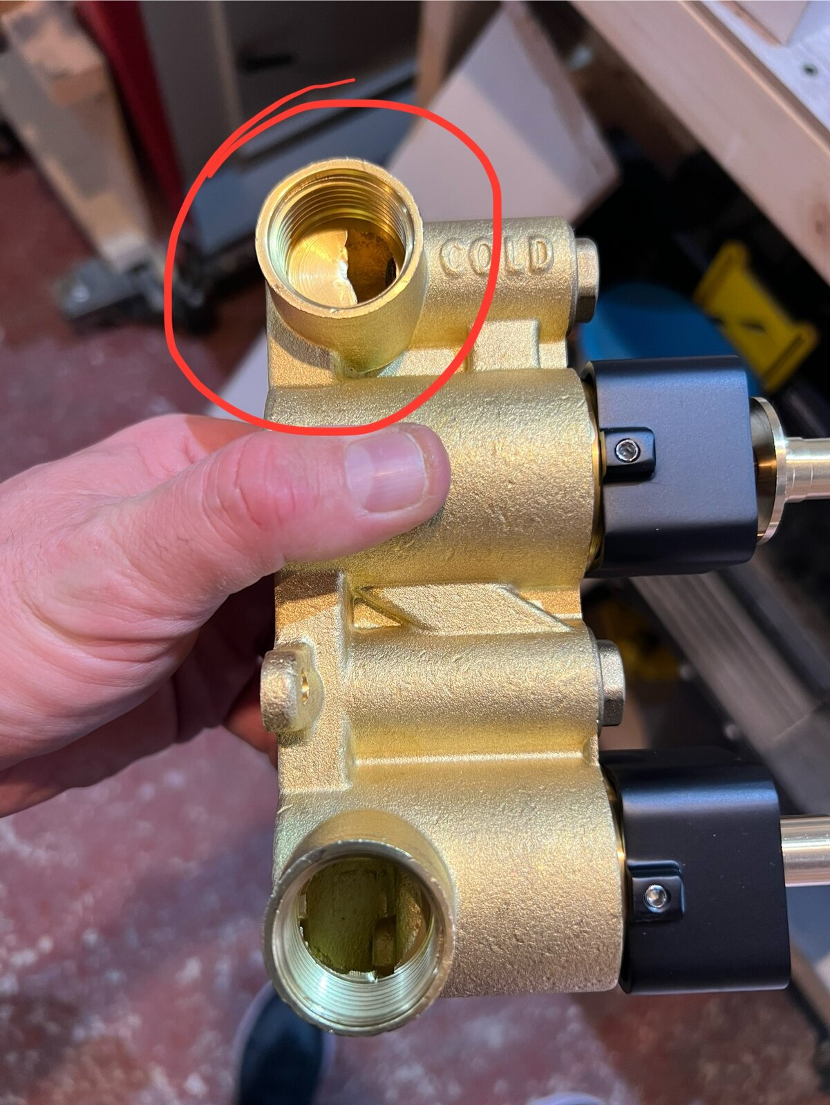

Hi all, my new shower mixer just turned up and found that both inlets look partially blocked. It seems strange that both inlets are the same so not sure if it's supposed to be. Anyone come across this before?

Inlets are normal, part of the construction.
15mm fine to the shower head.

There is no point in running the supply or the section to the shower head in 22mm.
The flow is restricted by the shower valves inlets,internal waterways,and outlet. It wouldn't make any difference if you used 6 inch diameter pipework.

Perfect example of how a lot of these generic budget parts are now all made in the far east. Casting blank quality etc isn't the best and neither is the finishing. They then find their way into the mainstream production processes. I had to send 2 concealed taps back recent, from a well known brand name, because the 1/2" inlet tappings were shocking, the 1/2" supply coupler just wouldn't fit properly. Really terrible quality.
a lot of these manufacturers supply a lot of the well known brand's budget ware these days
