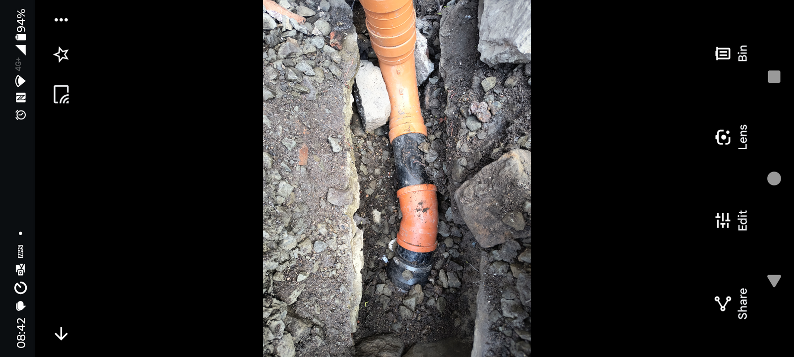

I replaced rest bend and disintegrated pipe as pictured below, rodded further downstream until I thought it was clear, left a few weeks before reinstating but it's now backing up a bit with heavy rain so obviously still something in there.

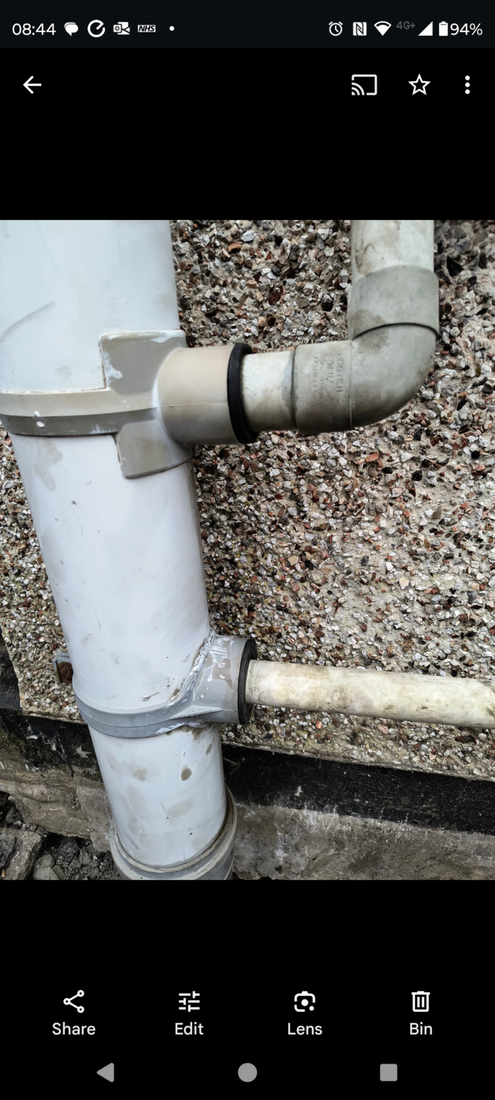

The second picture is above ground (the missing bit between the two is a short straight coupling with an inspection hatch similar to the one pictured).
To me, as a very amateur drainage engineer, the hatch looks far too small to get my rods in and down the pipe - after the rubber connector it goes downhill a bit steeper. I'm wondering if I should make the section with the bosses removable with slip couplings above and below (I think I need 2? the stack above can't really be lifted up) to make the rodding access easier?.
The blockage is related to the dreaded baby wipes, maybe with a lump of broken pipe in front of them - when I rodded it before (down from the rubber coupling before fitting the new section), I was literally drilling into them with my curly pig tail and pulling out clumps of them so I'm not sure I'd get them out of the hatch if it's more of the same.

The access hatch was completely seized and the slip coupling would not go on that grey pipe so I used a rubber connector in the end and was able to move the top of the stack sideways to get the rods down. I have thick rods and thin rods - the thin ones went down the rest bend with the wheel on the end and I got all 7m in - and think I either cleared something at two points (or got round two tight bends - I guess a professional would know the difference by feel) so I must have got into the main run (about 3-5m from the stack if my drawing is accurate).
