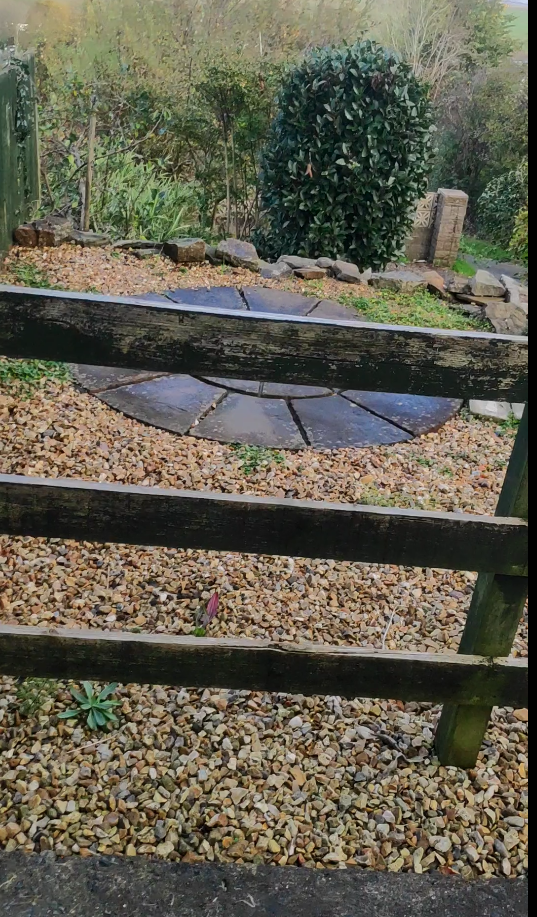

Hi, I wonder if anyone can give me some inputs on an idea I have for my garden.

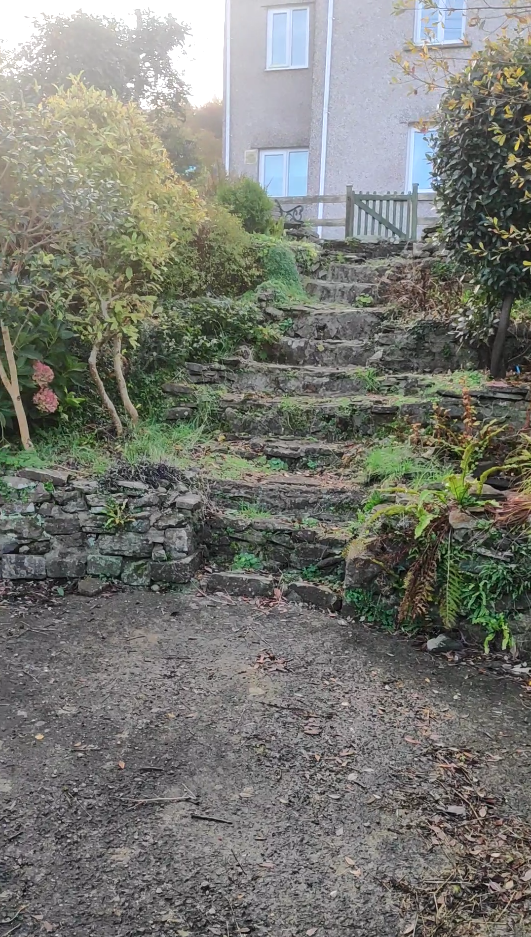

I have a house with a smallish garden, and the garden is quite sloped. Neighbours have built decking to make their gardens more usable, however I would like to create a garden room.

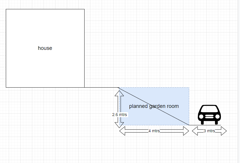

To do this, I envisage having to excavate a load of ground and then build a retaining wall, and then build the garden room. I think the room can be 4x3mtrs

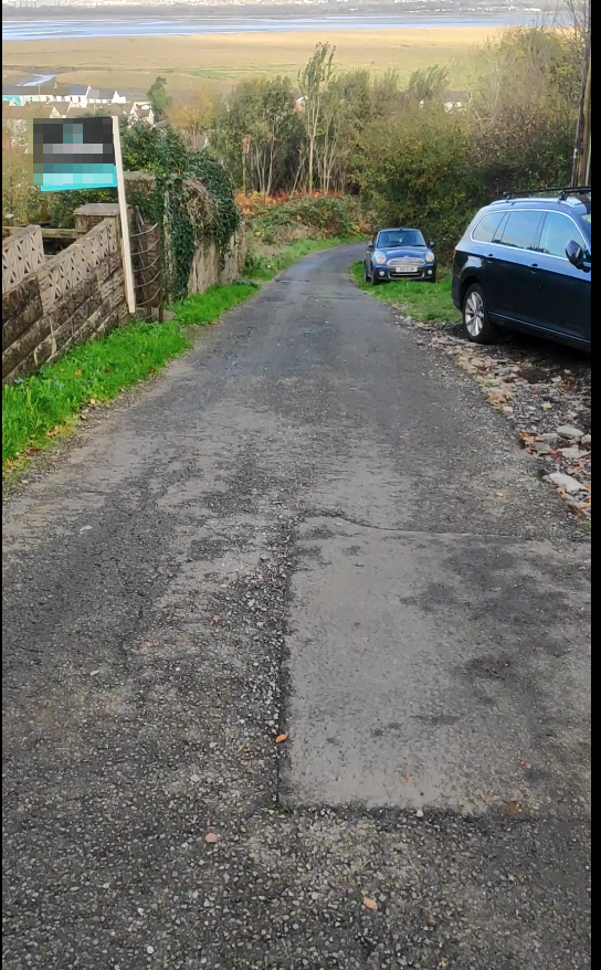

The house is next to a road and I think the garden boundary is around 1mtrs from the road (it's a country lane).
I presume I would need to build retaining walls and then put in a concrete base and then build the building. I want to be able to walk on the roof, because the roof of the building would be level with the ground on my patio.
I have some photos and a diagram that explains the idea.
Would you guys say this is possible without breaking the bank?
Concept
View of sloping garden
Patio Area
Road next to house
Would the "45 degree rule" apply to the ground near the road?
This is none trivial but could be a good project
- in front of the principal elevation so may need planning
- retaining wall isn't supporting the the road so shouldn't need highways approval, but looks to be supporting the the house and is pretty tall so will need building regulations approval
- building the retaining wall is always tricky if you don't have space to batter back the excavation. May need sheet piling or another temporary works scheme
- detailing for a walk on roof is a bit more involved than a normal shed roof
- the 45 degree question - is that for putting in foundations? Short answer is yes. Can't undermine roads
So could be possible, subject to planning but I think you will need professional help for the design and detailing.

The groundwork’s to dig out and do the retaining wall could cost £20k before you start the garden building.
building regs would require balustrading to protect against falling

The back of the office would be about 1m from the road if I placed it on the left side of the garden (looking upwards) and I think about 5m from road if on the right side. However the views on the left would be much nicer.
I think its the road thats the ticking point. Who do I need to talk to in order to get a proper idea of regulations on that, or where can I look to find out what the regs say, any idea?

That's completely unsuitable, you're not building a roof, you're building a waterproof floor and with a balcony attached to the edge.
Because that frame isn't designed to cope with using the roof as a floor, the floor loadings required for a floor are greater than a roof.
