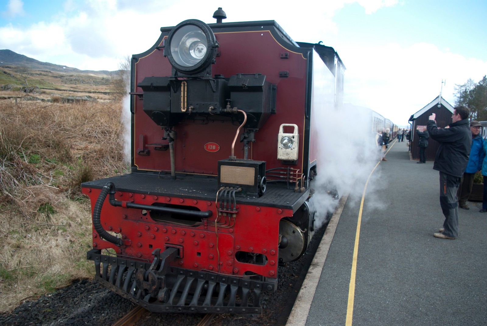

But the slower narrow gauge often restricted to 15 MPH and engines used in other countries often had steam turbines to run electric head lights. This one has a pair of head lights DSC_4744_com_1.jpg OK not a British engine, but picture taken near Welshpool in Wales, engine on loan.

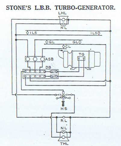

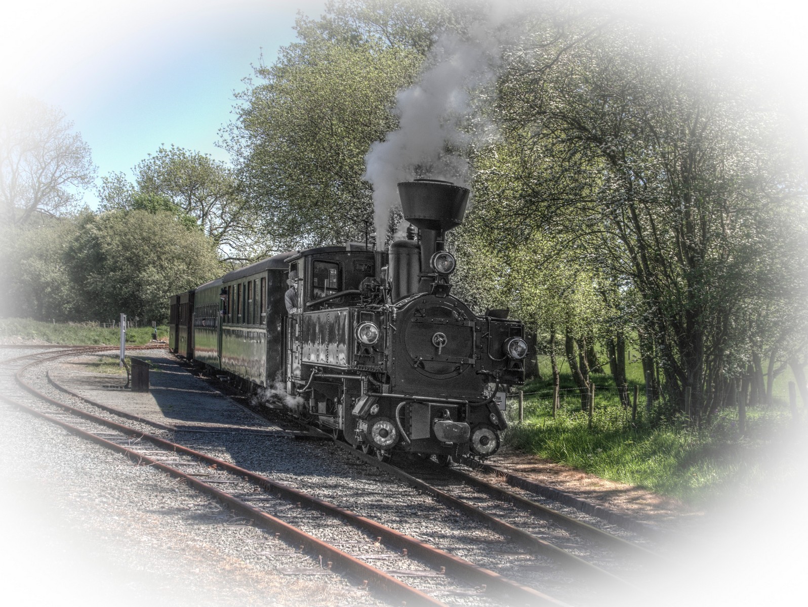

So how is the output regulated? And what sort of speed control? From the whine it seems quite high speed, here is another example. IMGP7346.jpg this one Welsh Highland Railway.
With variable mechanical speed the generator could control the output voltage ( or in some cases the output current ) by varying the current in the generator's field windings.
I had considered that, however unlike the dynamo or alternator with a car or coach, the steam input could also be varied as likely a dynamo so speed does not matter, and the steam turbine only drives the one item, so not sure if steam input regulated, which is why I asked.
I know on fairground showman's locomotives the speed of the generator was controlled by a bob weight governor controlling the steam valve. The very large flywheel smoothed out any transient fluctuations in the steam flow.

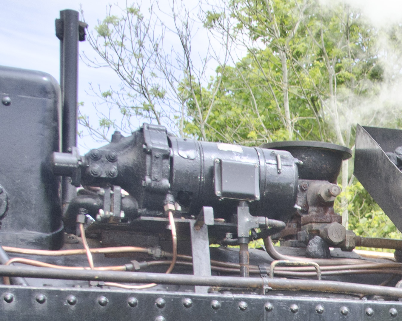

With this engine
The turbine is very visible, Zillertal was one of two U-Class 0-6-2T locomotives built in 1900 for the opening of the Zillertalbahn in Austria by Krauss & Co. The Zillertalbahn runs nearly 32km from the mainline at Jenbach to its terminus at Mayrhofen. The locomotive arrived in Wales on hire from the Zillertalbahn on 13th August 2019 and entered service on 30th August, so not designed for the Line. Joan and the Countess however were, but some of the original features are now missing, originally it went through the streets at Welshpool upload_2022-3-5_6-30-38.png and had a bell as well as the whistle, which there is no sign of now, and today they do not run at night, so no need for lights.

Away from railway generators I have worked on have been in the main AC, and the frequency was important, so the engine speed was fixed, but these I assume are DC so no frequency to worry about, so suppose it could be controlled by how much steam is supplied. I think Joan and Countess did have a steam turbine, but not where it can be so easy seen as with Zillertal.
After @Jackrae post I was able to find this PDF instruction set and it seems it was a permanent magnet AC generator and the speed governor was set using a special high frequency volt meter.
So it seems there was no electrical regulation, it was all done by the governor. View attachment 263116Not really what I expected, but does make sense.
