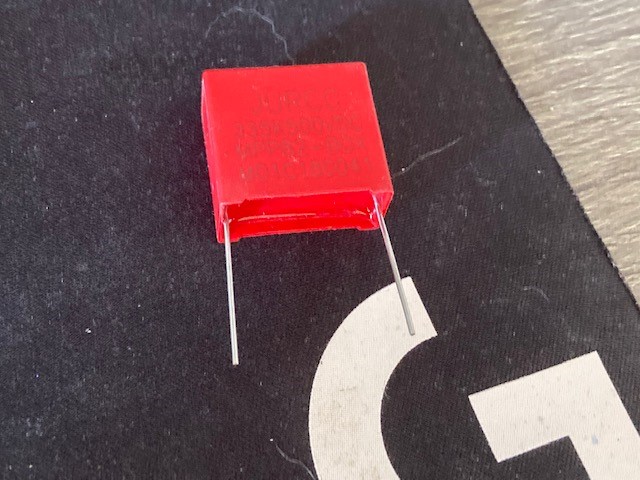

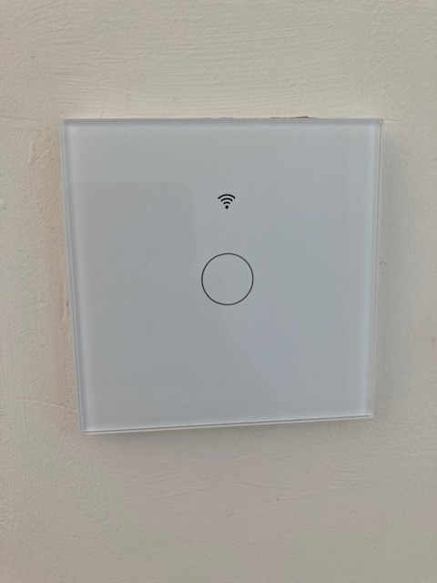

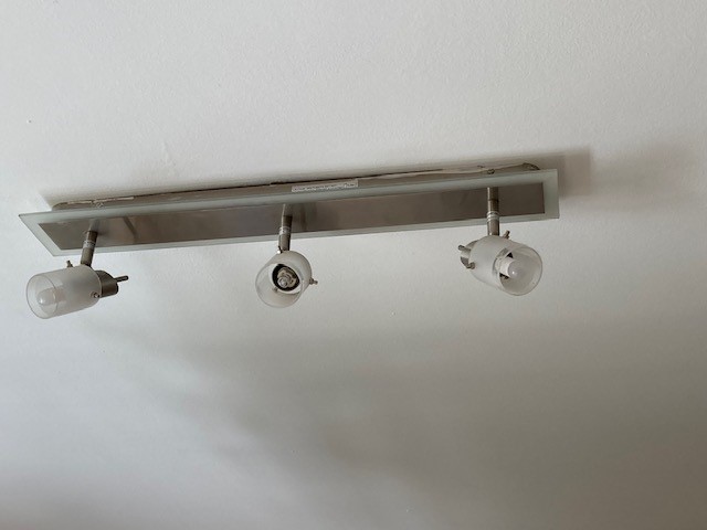

I purchased a Moes 1 Gang smart switch (no neutral). Switch is installed and working fine with my led fitting without the supplied capacitor installed.
My question is: Is it essential to install the capacitor at the fitting if the lights aren't flickering at all or is it ok to use without it?
Many thanks!
Pics for reference below

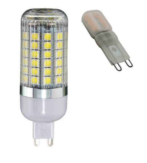

I do not use Moes, I use Energenie, also does not have a neutral, in 4 out of 5 no need for capacitor, it was only when using small bulbs, G9-comp.jpgI needed a capacitor to stop bulb flashing when switched off. The larger bulbs did not require it, and when I opened a larger bulb it was clear why, they were already fitted inside the bulb.
Ah, that’s useful to know! Thanks for confirming. I am looking to purchase more for the rest of the house so I’ll see how it goes with those and install the capacitors if needed. Cheers
