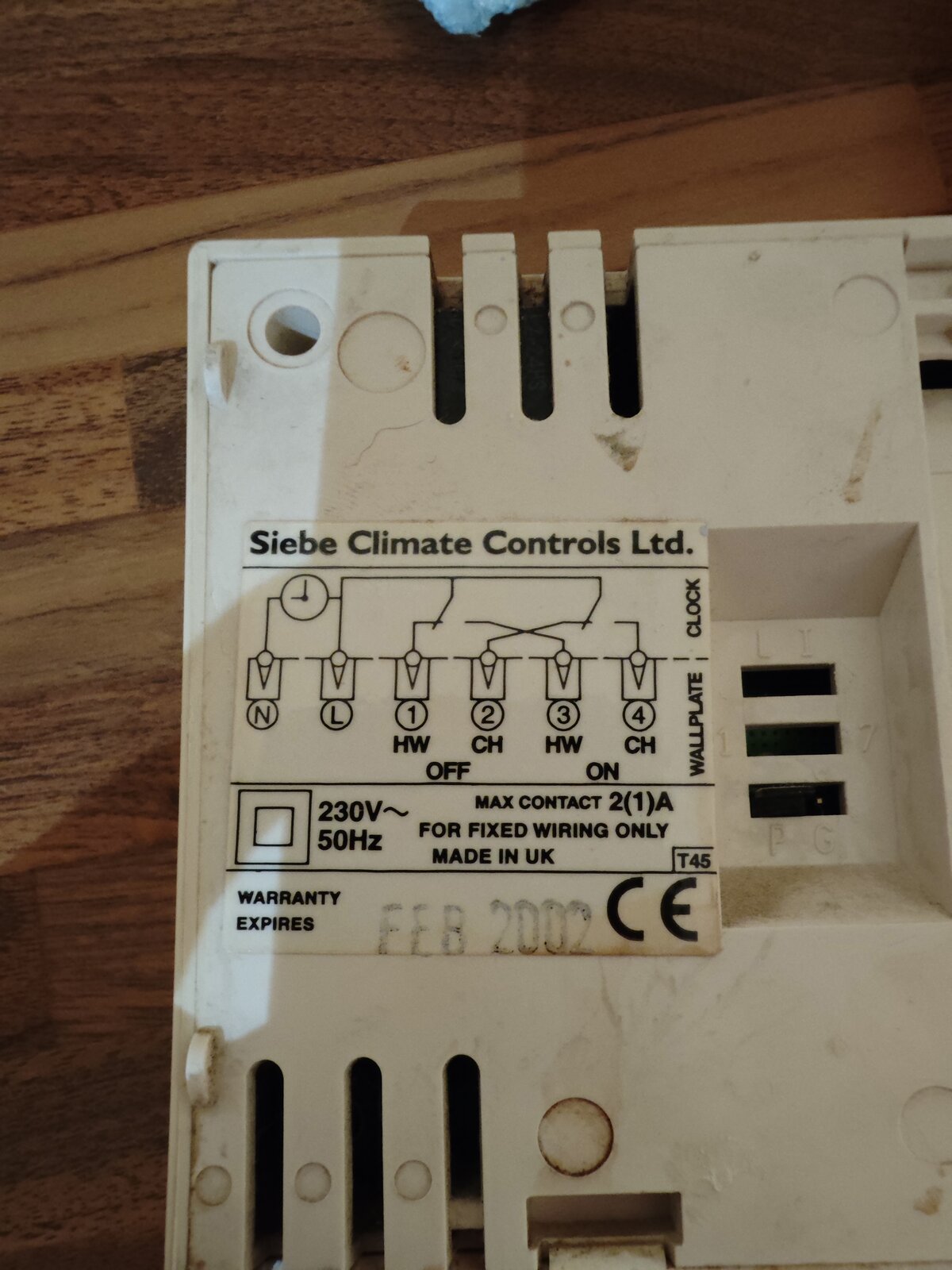

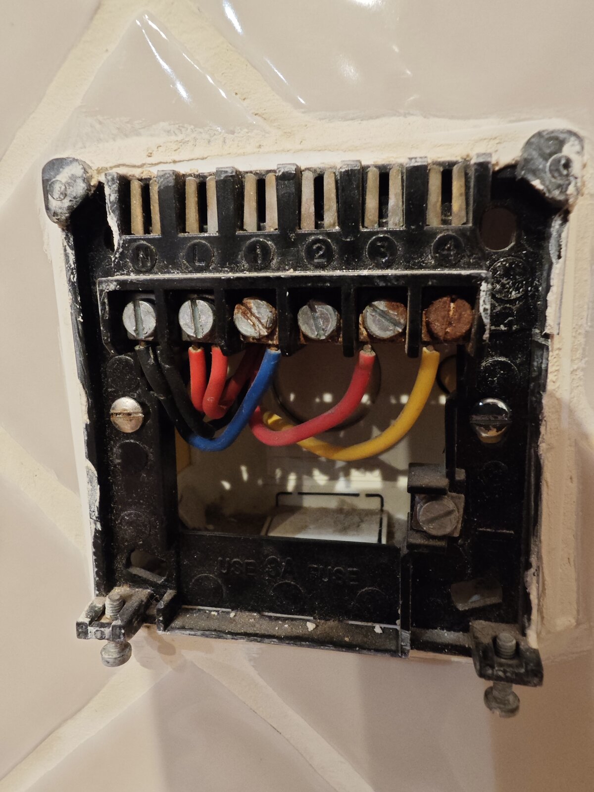

So I'm looking to move on from a old lifestyle LP522 programmer for our boiler and have this replaced with a smart relay switch, to control the boiler on and off via Home Assistant. (Recently just move in)
There is also a dial thermostat in the hall that switches on and of the CH, which I think we will deactivate.
I'm just trying to work out currently what wires I will need to hook up where to the smart relay switch.
Currently iv got 2 red wires going to L and to 2 black going into N. Blue wire going to 1, a different red into 3 and a yellow into 4.
The boiler is a combi and the HW tank has since been removed.

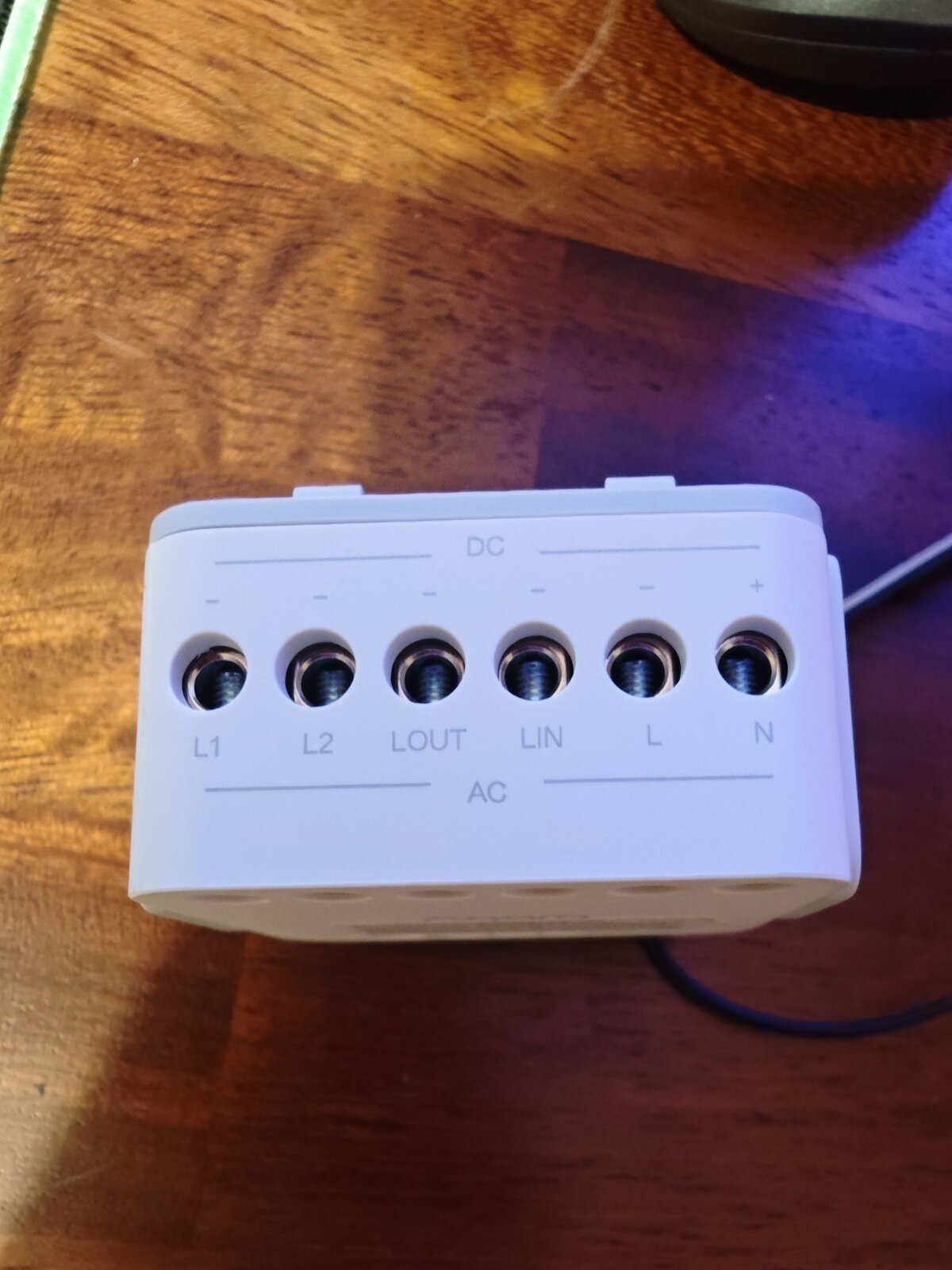

Iv attached the wiring iv got and the wire diagram on the back of the current programmer. Iv also attached the new smart relay switch and it's inputs. The new relay switch can run in dry contact mode which should be able to control the boiler.
Any assistance would be greatly appreciated.

It would seem wired for a Y Plan, and that when combi fitted, there has been some corner cutting, as will no longer be Y Plan, so what we look at is how can we gain more control without working out what has gone on in the past.
The backplate is universal, be it Hive, Wiser etc, they all use the same backplate. But you want a single channel, but wired for a two channel, so either work out the wiring, or fit a two channel.

However, even if simple on/off is all that is required, you still need to work out what you already have. Has the three port valve been removed, and do you have some wiring centre to wire it all into?

Just need to make sure I get the wiring right on the smart relay. Yes the 3 port value has been removed by the looks of things.

I would say it’s a case of working out if both wires to L and N are required, if they are then keep the same, if not transfer the ones that are. Number 4 would go to L out and L in would need a link to L. Number 4 is also the Live to the room stat and the room stat switch live to the boiler so you need to figure that out.
Ok so I think I know what I'm gonna do. I'm gonna go to the room thermostat and wire in the switch there to act as a smart thermostat in which the TRV's can call for heat.
This will mean the old LP522 will stay in place and just have the boiler on ready for a call for heat from the "thermostat" (now a smart relay switch) this way again it can self modulation as it currently does already.

Just need to allow everything to call for heat on its own now. So yea I think replacement the current room stat with the smart relay is the way to go here.
