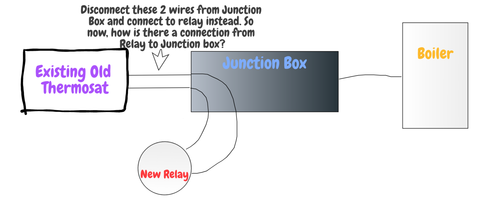

I cant just replace the old thermostat with the new relay because someone here pointed out that the relay takes 5 wires and the old thermostat will probably have 2 wires only.
Otherwise, I could have just taken the old thermostat off the wall and used the same wiring to connect the relay there. But apparently, that wont work.
Have a look at my drawing. I can't understand how connecting the relay to the old thermostat (which needs to be removed anyway, and replaced with a wireless one) will form any type of connection to the junction box.
It would be an isolated connection with nothing to do with the junction box or boiler.
Am I missing something crucial?
JH
JH
That couldnt be more wrong, the two wires connect to the relay from the wiring centre, the thermostat connects to the relay usind a wireless signal no wires between the new thermostat and the relay
I followed those two wires in the image and they go directly to the existing old thermostat on the wall.
If I disconnect them from the Junction box, then its simply a wire to the old thermostat with no power from anywhere.
When has anyone told you to do that!! Leave them connected at the junction box and connect the other end to the relay along with a live and neutral and earth!!
