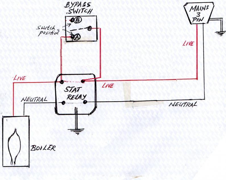

Is my bypass switch wiring correct for a room thermostat ?

In any case, back to my questions on whether there are different rated switches for various votage use. Still hoping someone could clarify this although I suspect there is. Just need confirmation as playing with electricity is not a joke !
way to go to over complicate things, total waste of time, are you going to put another switch in just incase the first one you fit goes wrong & then another & another :roll:
Well, you are entittled to your oninion and I have my reason for doing what I wish to do.
The boiler stat will prevent overheating, but I do question if this is really required.
You have over-complicated your diagram in my opinion. While it will work, all you need to do is this:
The thing is, this should hardly ever go wrong, and if it does, you could just bridge the connection with a short piece of cable until you have a replacement.
Following my earlier reply/comment to yours and having taken a second look at your suggested wiring, I have another question for clarification which is:
....on your suggested wiring, wouldn't it mean that the thermostat is still connected (live) even when the bypass switched is turned on ? Is seems even when the switch is turned on, the circuit via the thermostat relay is completed as it is still fully connected to the mains.
...compared to my suggested wiring, if the switched is flipped UP to position B, then isn't the circuit via the thermostat relay not completed as it is cut off at position B (bottom of the switch in case A and B is not showing up clearly in the diagram) ? So the circuit via the thermostat relay is not completed and instead, the circuit via the bypass switch is completed ?
I hope you understand what I mean and that my thinking is correct or is it not ? I'd like to wire up in such a way that only one circuit is completed (live and working) while the other is open (dead). That is - either it is completed via the thermostat relay or via switch while the other is dead.
Let me know what you think. Thanks.

The button on the front of the relay box does exactly what your proposed switch will do.

I can switch the heating on and off from the room thermostat and the thermostat can also be program as to when the heating comes on or off and at what temperature. I wanted a over ride switch so that if the thermostat fails or ran out of battery in the middle of the night, I can still manually switch the heater on via the over ride switch. But it seens I am not getting any help on how to fit this switch or if my proposed wiring is correct and safe so far :(
