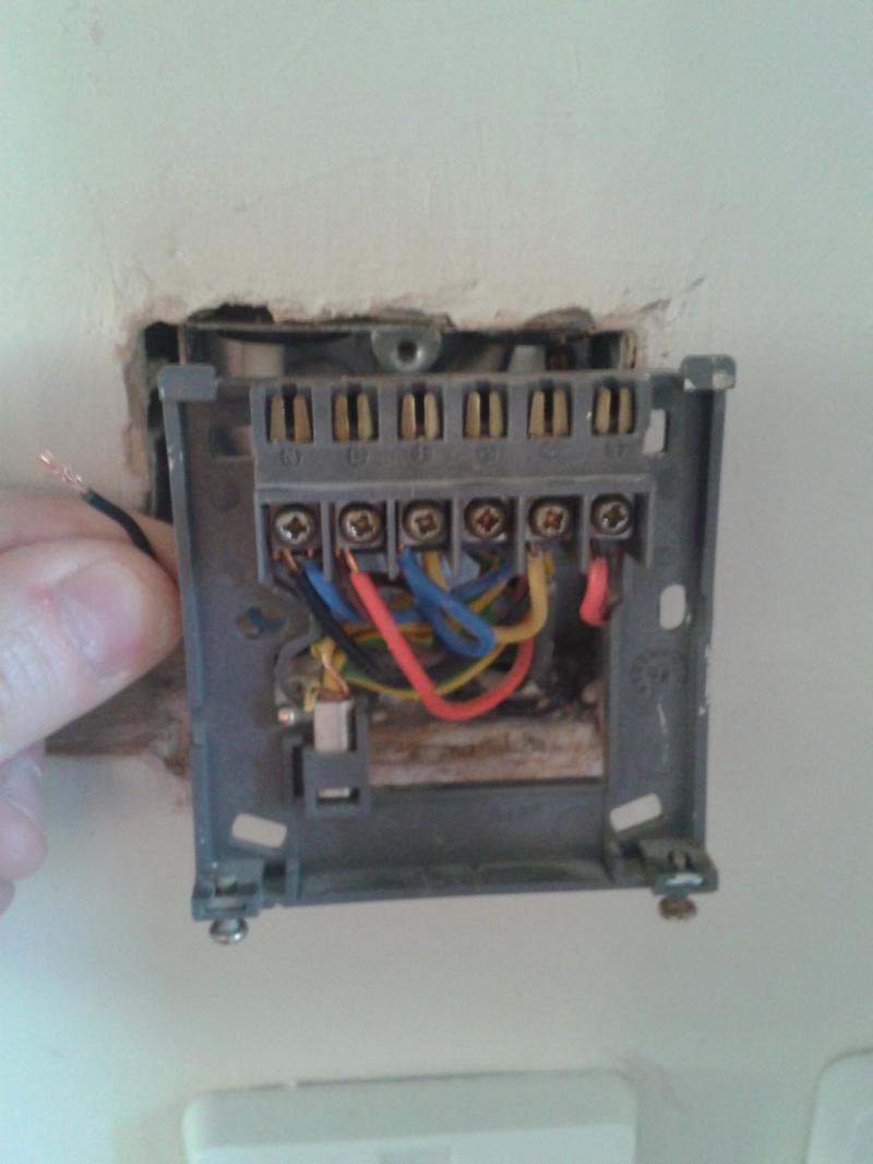

I thought everything was OK but my boiler is not starting up on HW or CH now.
I have been away, I put it on HW tonight, the boiler started up fine at first then after a about 10 minutes it cut out and now I can not get it started on HW or CH. Programmer lights come on but no Boiler.

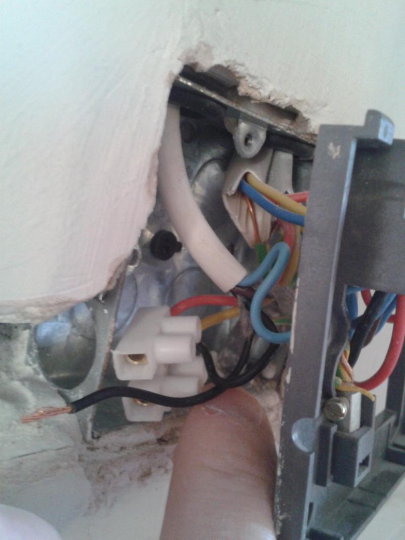

It may be because I have found a stray black wire behind the programmer that maybe i possibly made come loose when I was chiseling out the wall by the programmer to bury the wires that were coming off the Programmer to the Wireless relay.
Does anybody know where this Black wire should go. My guess is I knocked it out from one of the cable blocks that is behind the programmer backing plate.
To make it easier to understand where it come from I have disconnected the wireless relay and put the wiring back to how it was before I fitted the wireless rely.
The stray black wire comes from a cable that has a blue, brown, yellow/green and 2 blacks.
The rest of the wires coming from that cable are linked as follows.
Blue - newtrual Programmer
Brown - Live Programmer
Yellow/green - Earth Programmer
One Black - cable block behind Programmer that has a yellow wire connected with it from another cable.
Stray Black ?
I should say that it is a conventional Boiler with HW Cylinder and divertor valve set up.
I'm hoping it is only this stupid thing that I have knocked the black wire out and caused a problem

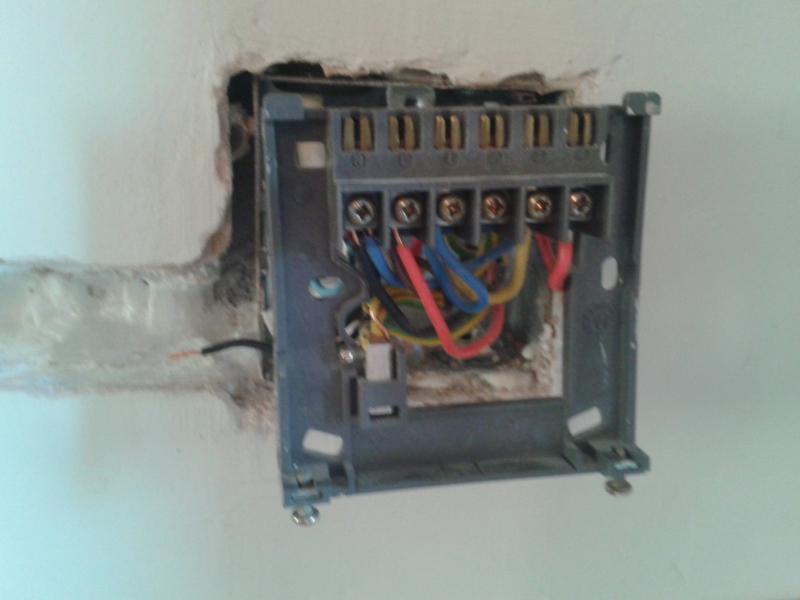

The wiring of the programmer backplate has altered (to be expected). There is now a black wire in the L terminal which wasn't there before. Is this from the same cable as the loose black?
I cant see anything connect to the red that is next to the 'yellow and black', if my eyes dont deceive me, the spare black probably goes there but DO tests as D.H says.

1. The white Cable, which is the only wire the same in the Junction box goes to the HW Cylinder. The two Black wires at the Junction Box End go to Terminal 8.
2. Yes the White Cable above the terminal block is where the loose black wire comes from.
3.The other wires from the white cable go as follows
Blue to PN
Brown to PL
Yellow/green to Earth on Programmer Plate
Other Black goes to terminal block that you see( connects to yellow from other grey cable) other wirers from Grey cable are Blue to PN and Red to other terminal block in picture with nothing else.
4. As I just said the terminal Block has one black wire from the white cable connected to a yellow wire from the grey cable. The second terminal block has a red wire from the same grey cable, the blue wire from the grey cable goes to the PN.
I have put the wiring back exactly as it was before I tried to fit the wireless stat. That is not a Black wire going to the live it is the Brown wire coming from the white Cable with the loose Black.
When I put the meter on it is Live without starting anything up
Like I say the Black plate and wires in the Junction box are back to how they were before I installed the wireless stat.
I think the Black must have come out of the Terminal Block at the back of the Programmer plate but I don't know where?

My mistake! I meant there is a black connected to N. But I've now seen it in the before and after pics. It had just been moved about when you altered the wiring.
