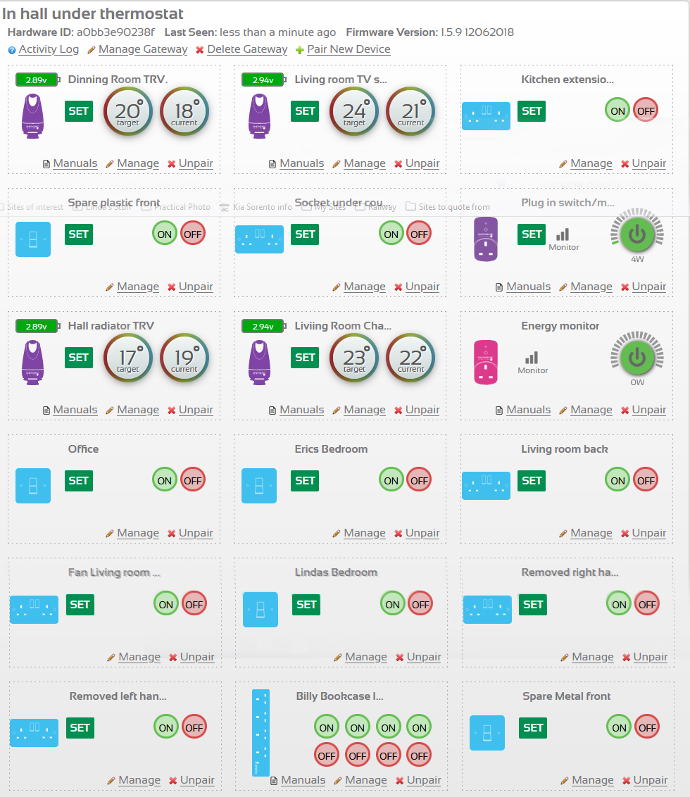

Often the same system can do other things, I have Energenie Mihome-used.jpg which does light switches neutral free, sockets both fixed and free, energy monitors etc. I started in mothers house and it worked well, so moved to this house and expended, then had to remove some of the items, one double socket and three light switches removed from service, and touch wood now works OK, however not perfect.

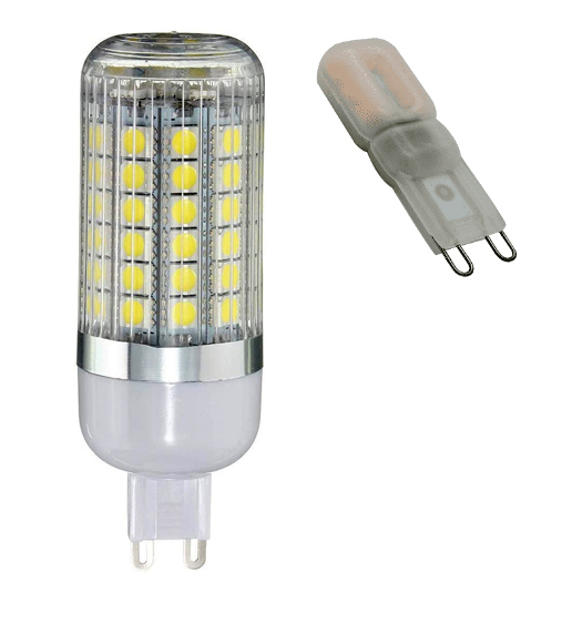

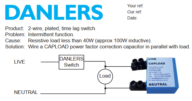

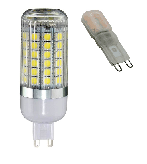

The neutral free light switch worked great with BA22d and E14 bulbs, small problem with GU10, but G9 caused a real headache. With the G9 it would not switch off, had to add a load capacitor load-capacitor.jpg then found a shimmer when switched on, the small G9 G9-comp.jpg is about the same size as the smoothing capacitor inside the large one, the large one did not flicker, but the glass covers would no longer fit.

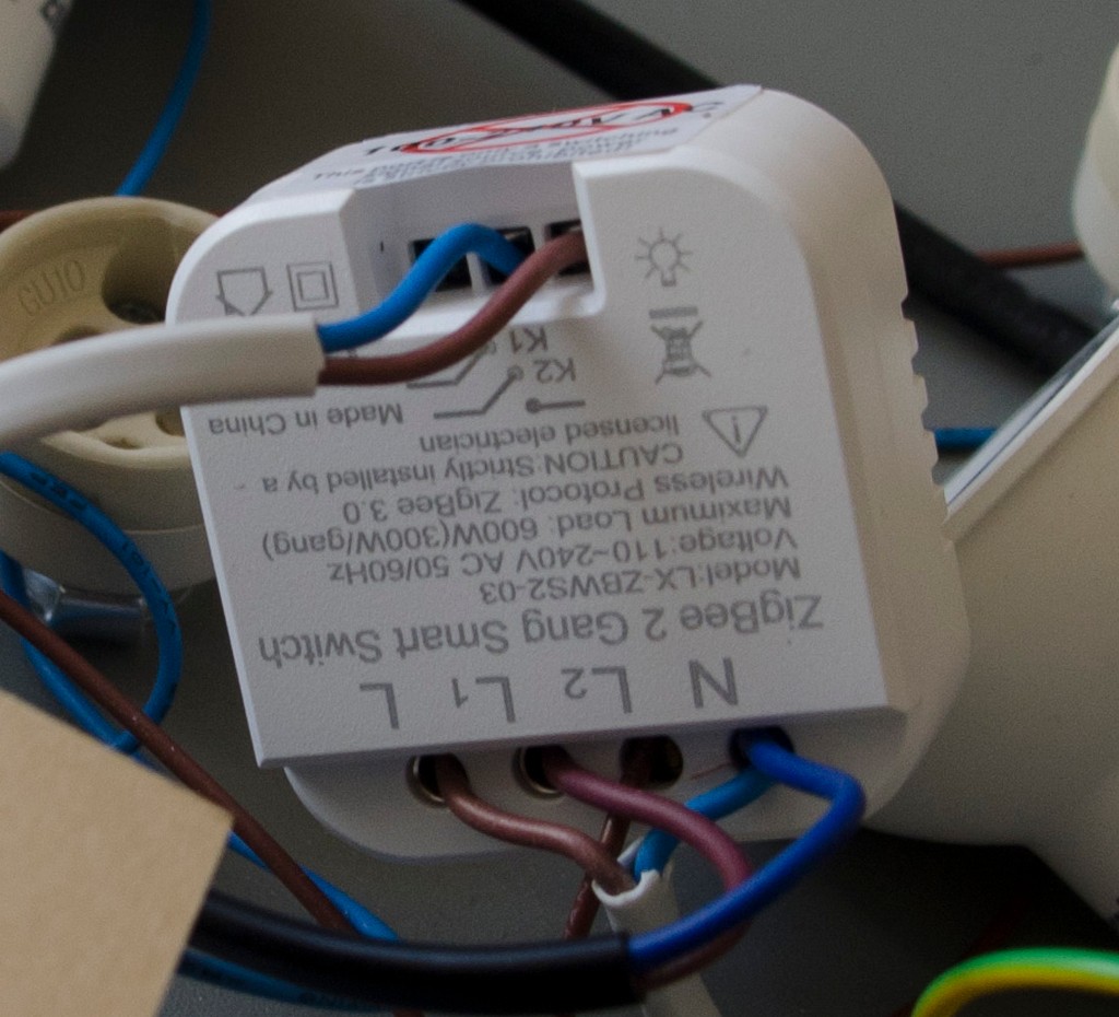

I have one odd one out, still to be fitted, seen here being tested DSC_6059.jpg DSC_6058.jpg the smart relay combines a standard light switch and zigbee phone app so I can switch lights on/off like a two way switch, it is designed to go on our landing so one bulb for going to toilet at night, but 5 bulbs to light the stairs. The smart relay DSC_6061.jpg sends extra low voltage to light switch, so lends its self to the British system. The EU system takes a neutral to light switch, the British does not.

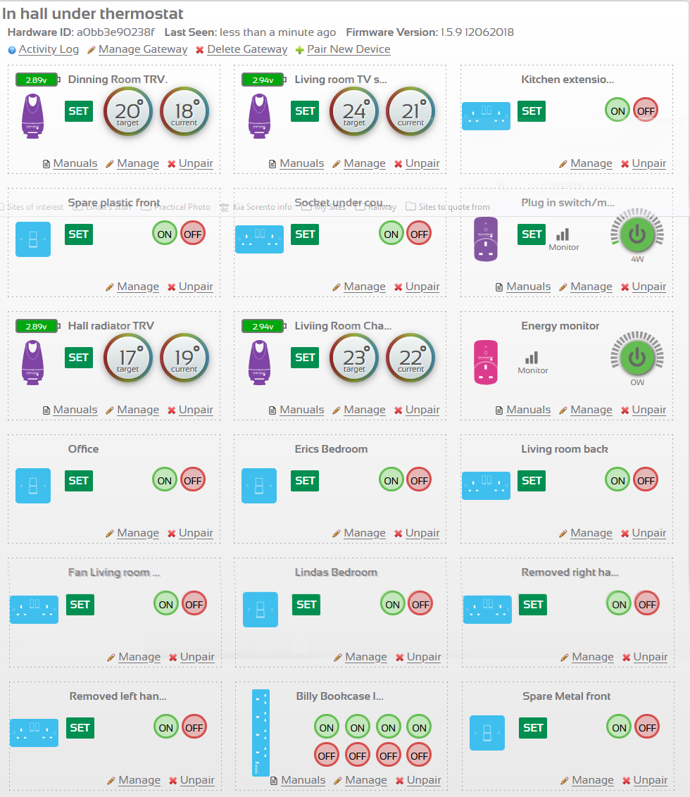

Often the same system can do other things, I have Energenie View attachment 264225 which does light switches neutral free, sockets both fixed and free, energy monitors etc. I started in mothers house and it worked well, so moved to this house and expended, then had to remove some of the items, one double socket and three light switches removed from service, and touch wood now works OK, however not perfect.

The neutral free light switch worked great with BA22d and E14 bulbs, small problem with GU10, but G9 caused a real headache. With the G9 it would not switch off, had to add a load capacitor View attachment 264226 then found a shimmer when switched on, the small G9 View attachment 264227 is about the same size as the smoothing capacitor inside the large one, the large one did not flicker, but the glass covers would no longer fit.

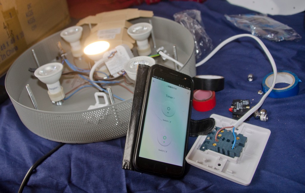

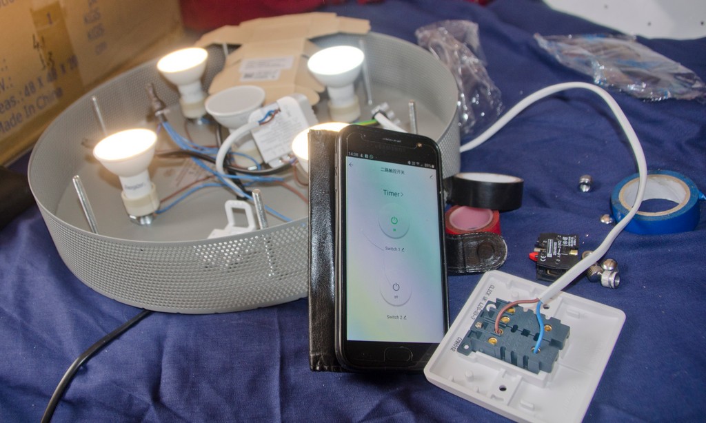

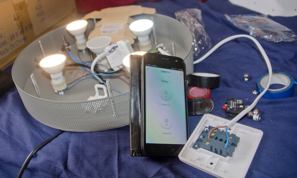

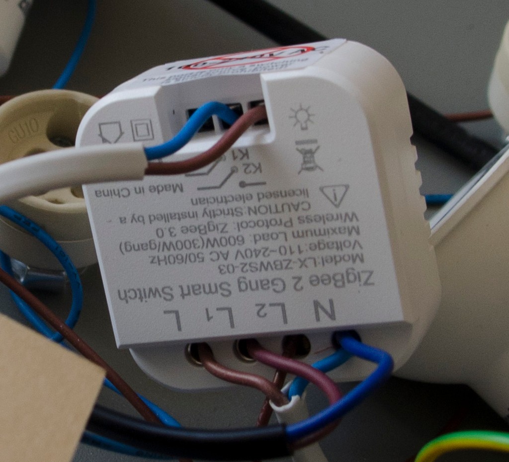

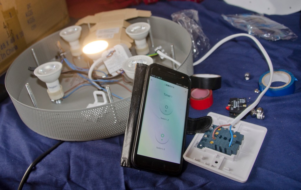

I have one odd one out, still to be fitted, seen here being tested View attachment 264228 View attachment 264229 the smart relay combines a standard light switch and zigbee phone app so I can switch lights on/off like a two way switch, it is designed to go on our landing so one bulb for going to toilet at night, but 5 bulbs to light the stairs. The smart relay View attachment 264230 sends extra low voltage to light switch, so lends its self to the British system. The EU system takes a neutral to light switch, the British does not.
