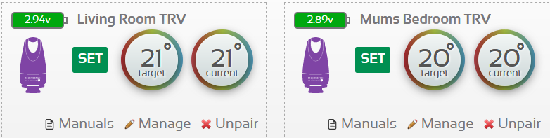

It really does annoy me. The PC shows this.
Which is enough information to control the boiler, very simple if target is below current in either room I want the boiler to run, but there is no way to actually use the information to control the boiler, at least not that I can find. The only difference between EvoHome and what I have is that human machine interface (HMI) which they call a thermostat which takes the information shown above and uses it to control the boiler.
But once the mistake has been made, then what? The same page that shows the two TRV electronic heads, in my case also shows two sockets fixed, and a light switch, and an energy meter with switch. Non of these would matter if a visitor was allowed to alter them, however it could have a lot more, and once the mistake has been made, to correct is expensive.
