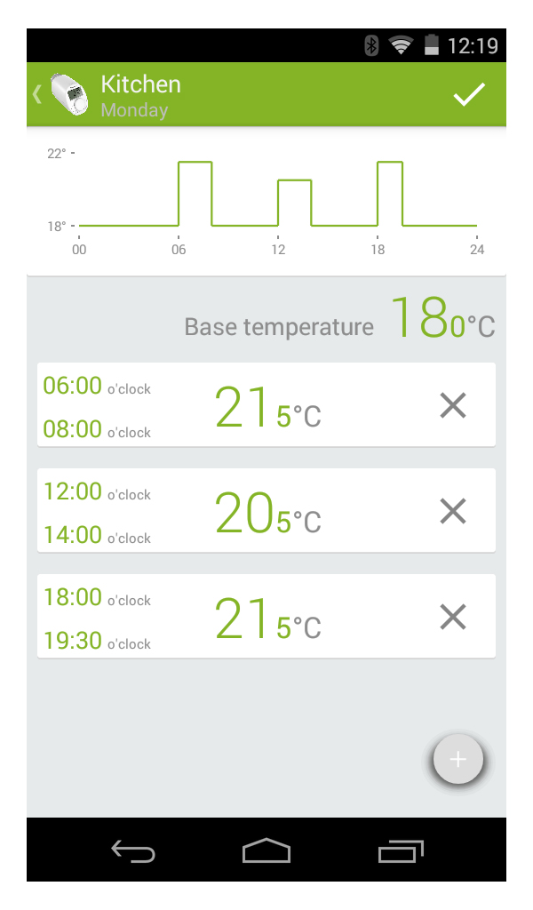

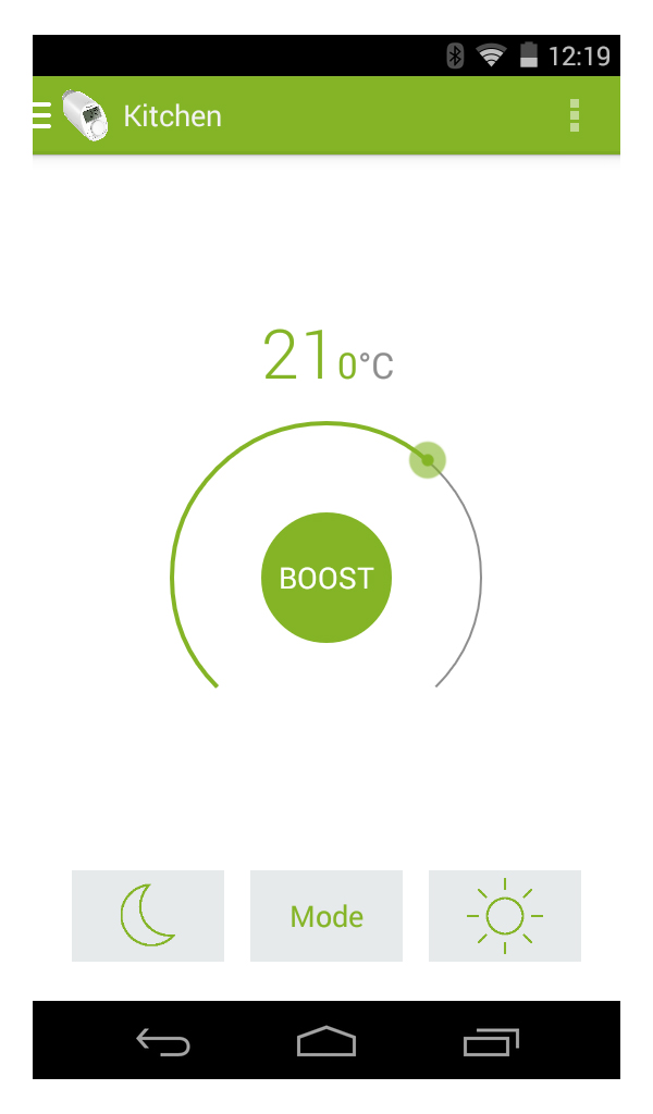

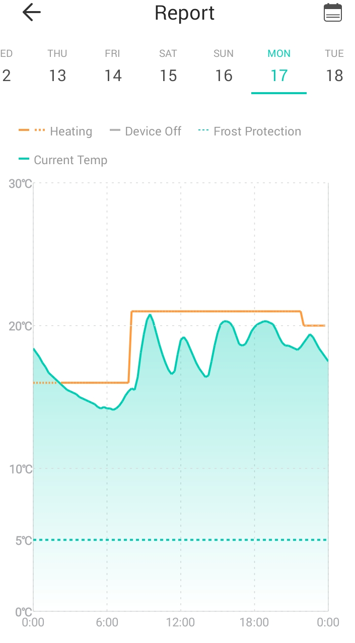

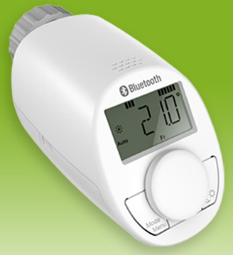

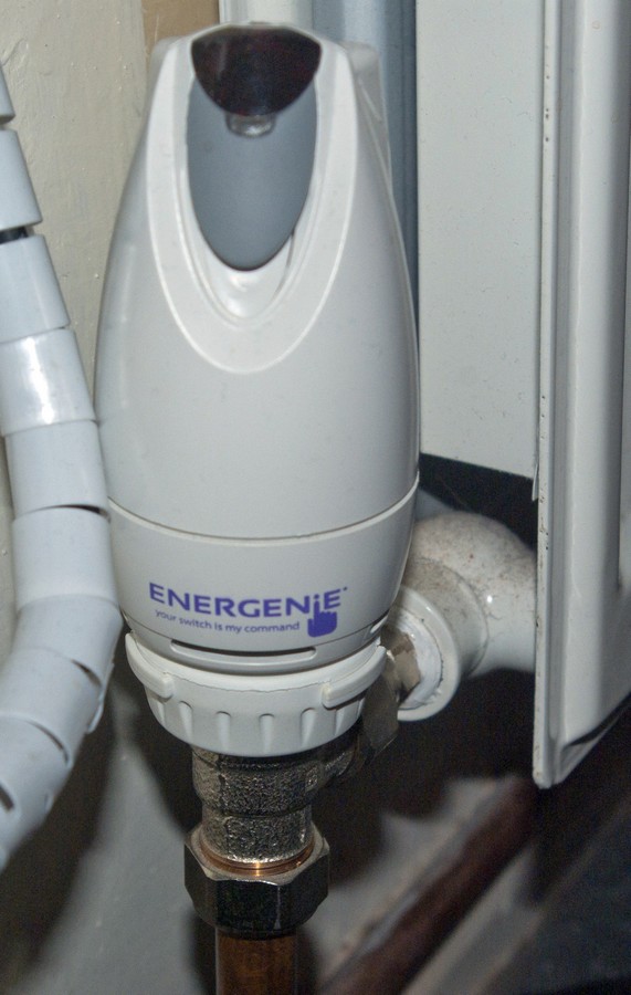

If the TRV shows current and target, then that makes setting up the lock shield easy. I have three makes, Energenie, eQ-3, and Kasa, I am about to move to Wiser as they are linked. In real terms, you only need some TRV heads linked, the eQ-3 in 2019 were cheap £15 each, they are bluetooth, but will only link to one phone, has window open detect built in. It only shows target temperature, but they have worked very well. The Energenie have no option to work manually, but can work with both PC and phone, shows target and current, can use IFTTT for geofencing, but the anti-hysteresis software is OTT, so would not get any more. The Kasa is the best of the TRV heads I have to date, only works with phone or emulator on PC, the software shows graph of room temp, so you can see what is going on.

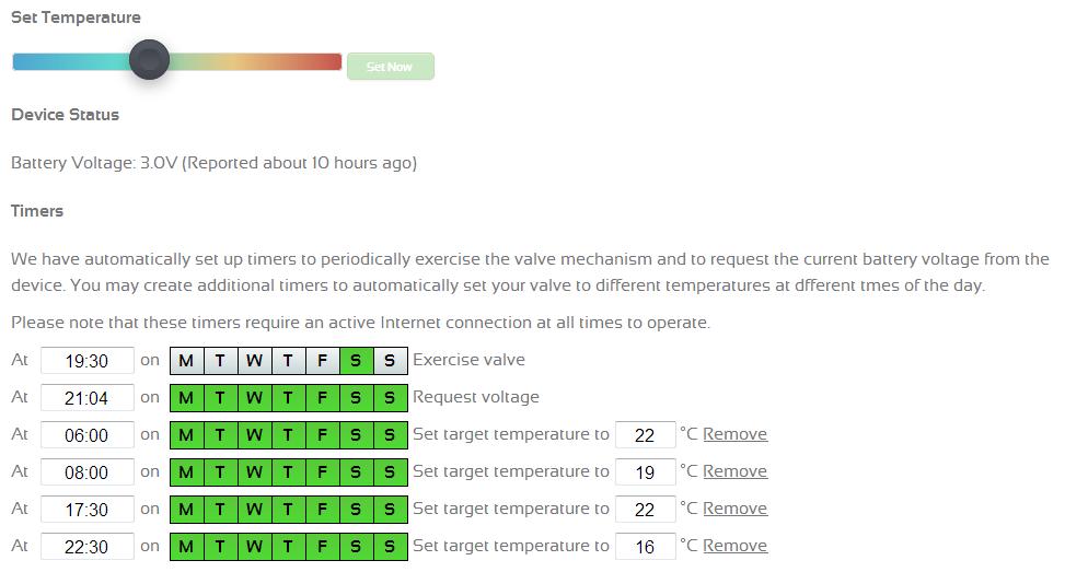

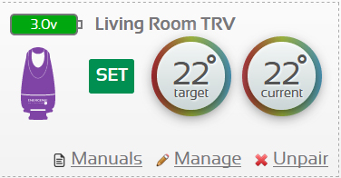

To continue, the Energenie were the first, IMGP8035.jpg they needed the spacers selecting, the TRV_report.jpg showing of target and current resulted in slowly closing the lock shield valve until current never exceeded target. The set-up varies TRV_settings.jpg the Energenie was near enough, the eQ-3 can only be paired to one phone, but most can be done without the phone. 51RAAw1+hEL.jpg510VC3xAYwL.jpg
The units work well, ⁣ but61dmtMm13BL.jpg either my wife or I have control, not both. The Kasa is like the Energenie internet connected, so both can be controlled by my Nest Mini's so single command "hey google set living room to 21 degrees." will set the Wiser, Energenie, and Kasa to 21ºC even when using three different makes. The Kasa software, 1741626844249.pngshows how well it is doing, the hysteresis is because I had an oil boiler which does not modulate, simply switches on/off. It would be smooth if the boiler modulated. The Kasa I think will link to a wall thermostat, but the thermostat is hard-wired type, so no good for me. Hence, moving to Wiser. As yet only a Wiser wall thermostat, it says Wiser will work out time to heat the room, so you can set time when you want room warm, and it works out when to turn on boiler.
